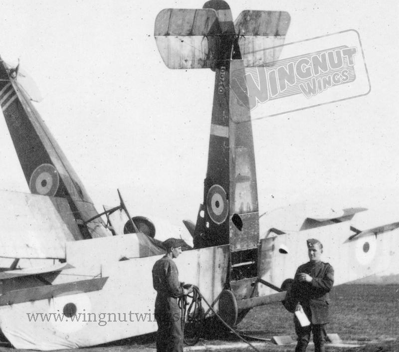

What about the middle part? may be the plastic part, but ...
The drawing in "Cross & Cockades" book showed a closed (no axles visible) underside?
Found this pictures on the WNW pages:
Soruce: wingnutwings.com
So a new plan: wooden part, here in a raw form. Thinner at all and thinned on the back side.
The Hendon restauration pictures shows a metal part,  so I covered it with thin brass 0.05mm and soldered on the back side. Opened the cut outs only on upper side.
Plugged together, the 0,8mm nickel-silver axles needed to be cutted to real size.
Compared to the original - the suspension will be made from stretched sprue.
Sorry Edgar - but is is still a great kit!!!
