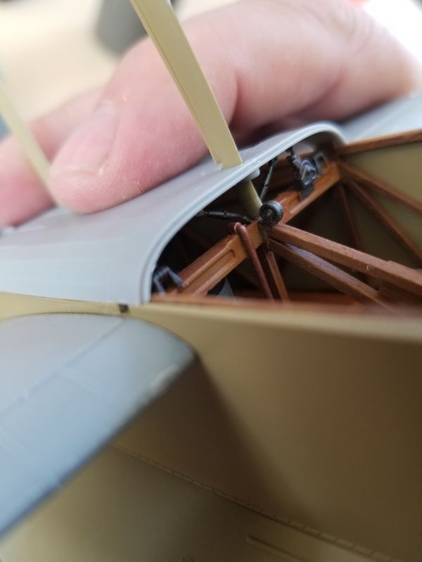

  Did a little dry fitting. I'm worried about how all this is going to fit together, and I have an idea about how not to cover all the work I'm doing on the interior, so I wanted too check and see if it'll work. Looks like everything is going to come together well. I wanted to check this little area because of a picture in the instructions...

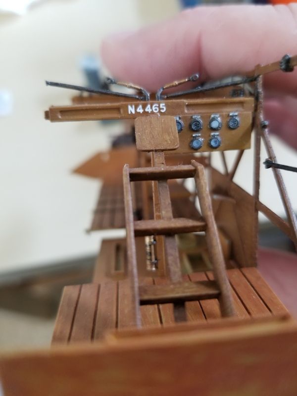

  The center section strut in the picture extends through the fabric down to the spar in the interior. seeing this in the picture, I was worried that the one on the model didn't do this so I wanted to check it. I was surprised to find...
  ...it does! Once again WNW has done an excellent job of research and recreation. This is going to help me with my plan to blow the top fabric off the fuselage and expose the interior. I'm still working out the details of just how I'm going to do this, but this is one step closer.

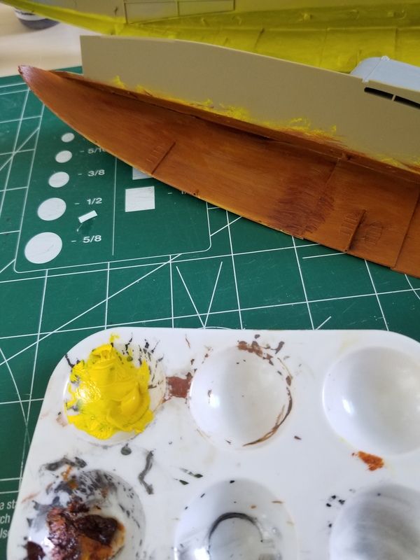

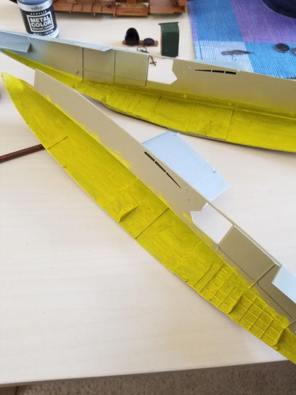

  I started by messing with the fuel, excuse me, petrol tanks a little more. I've nearly got the lines completely erased. This last coat should do it...

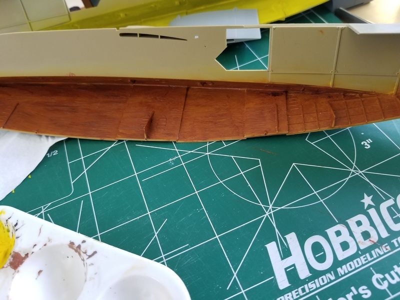

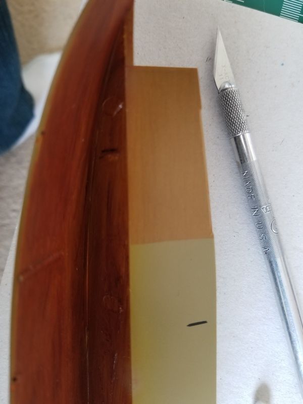

  After that I decided I should start working on the inside of the hull. I wanted to continue the dark wood along the bottom. Since I plan on opening up the hull on top, I'd better get this painting done. I still can't get over how stark yellow the first layer of oil paint looks. It makes it hard to believe it'll ever look like dark wood when this layer goes down...
  But after the darker coat goes down, it instantly starts to look better...
  I run a stiff brush over this to add the "deep" grain, and then dip a wide fan brush into the dark oil paint and do some detail grain work and general clean up...
  Then it goes into the box to dry for a week or so. After that, I'll hit it with a protective coat of semigloss, and then comes the dark black washes to help represent the sealer they may have used in the bottom of the hull. I want to get caught up to what I've done in the bottom of the interior assembly before I continue to darken everything up further.

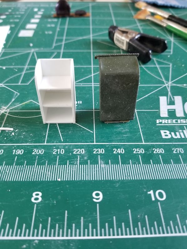

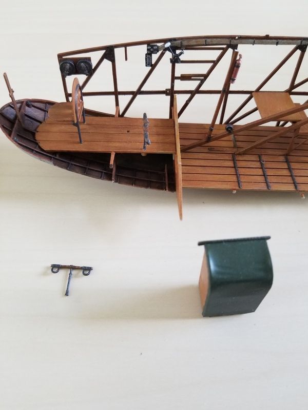

  Next I decided to take the plunge into the waterproof wireless cabinet. It may be an omen, but while trying to pry the cabinet out, I snapped off one of the rudder pedals...curses...

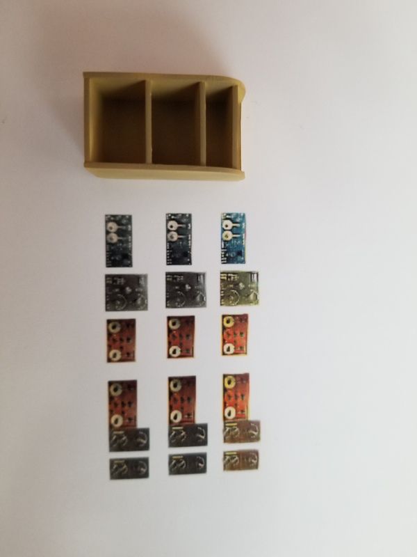

  Despite the damage, I think I'm off to a good start though. I think my scratch built cabinet turned out kinda nice...
  Now filling it with some radio equipment will be a challenge, but I think I've found a cheat that'll make it easy. There's some really nice color shots of WWI radio equipment on the Net. I'll grab a few choice shots, drop them into Photo Shop, and clean them up, shrink them down and print them out. I'll take those and glue them onto some polystyrene blocks, and pop some little round bits to represent the dials and knobs. Stick a few wires in here and there, and hopefully I'll have some better than half ass representations of early radio equipment. Wish me luck.

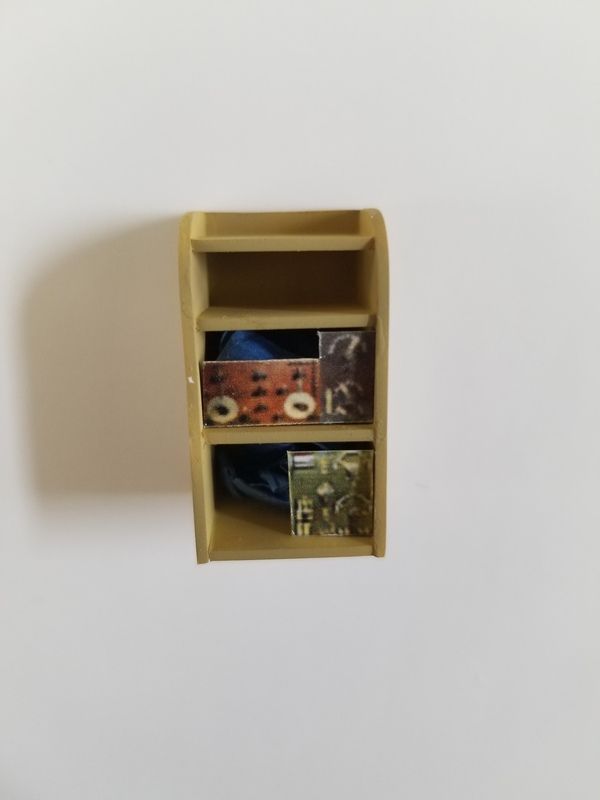

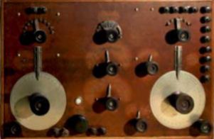

  I've been toying with how I'll recreate the radios. I'm thinking the idea of printing out the faces of the various bits of equipment may just work. Here's a few pictures I grabbed from the net and straightened out in Photoshop...
  Now if I can just get them to print out at a decent resolution, they may just be usable, but I plan to play a lot more. Maybe I can find some betterer pictures to use.

  Well despite having to wait hand and foot on all the moms of the world, I did get some hobby time in. Today's festivities began with further work on the radio cabinet. It was back to Photo Shop to see if I can figure out how to get the pictures small enough to fit into the cabinet. After getting the size right, I put them together and started messing around with the controls to see if I can sharpen them up and make them print nicely. Weeeeelllll, the results are ok, I think. I'd like to have better sharpness, but I'm not a Photo Shop expert. So here are the pictures, three different ways...
  I'd call it legible, but I'm thinking under some of the expert photography I've seen, it won't hold up, but to the naked eye, especially my old worn out eye, it'll do. So I cut them out and stuck them in to see how they look. Think I'll go with it...

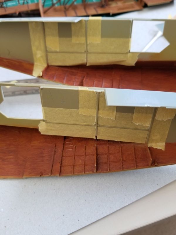

  So moving forward, it was time to start finishing the cabinet with a coat of paint. Not thinking ahead, I didn't have any place to hold it during painting so I messed up the bottom shelf. I'll repaint it when the others dry.

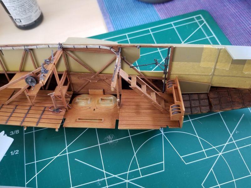

  Next, I thought I'd start playing with the plywood decals to see how they'd look. Honestly, I'm not too happy. My base coat is too dark. I want the plywood to retain the original color of the decals as they are on the sheet. It just didn't occur to me that the sheet's color is white, so with a tan background, most of the grain detail is rather hidden, and the whole thing looks too dark.
Even with the dark framing over it there's little or no contrast and the panels look dull.
  I'm going to do it over with a white background for sure. Naturally I couldn't make that decision before masking the framework in the back. I'll have to rip out the tape to repaint  I'll be wearing my dunce cap the rest of the day.
  To make up a little for this goof I hit the bottom of the hull with a black wash in an effort to actually move forward with the build, rather than just creating more work for myself. It's going to be a big masking job to repaint all the tan, white.

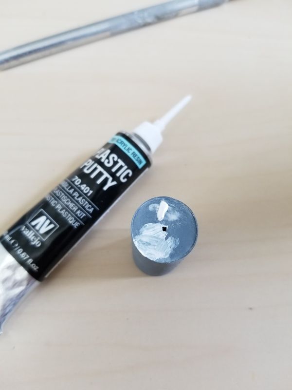

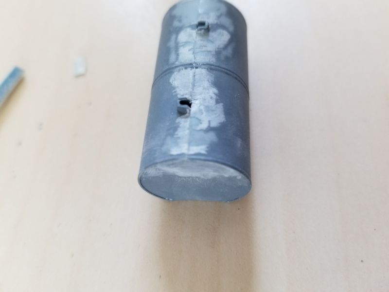

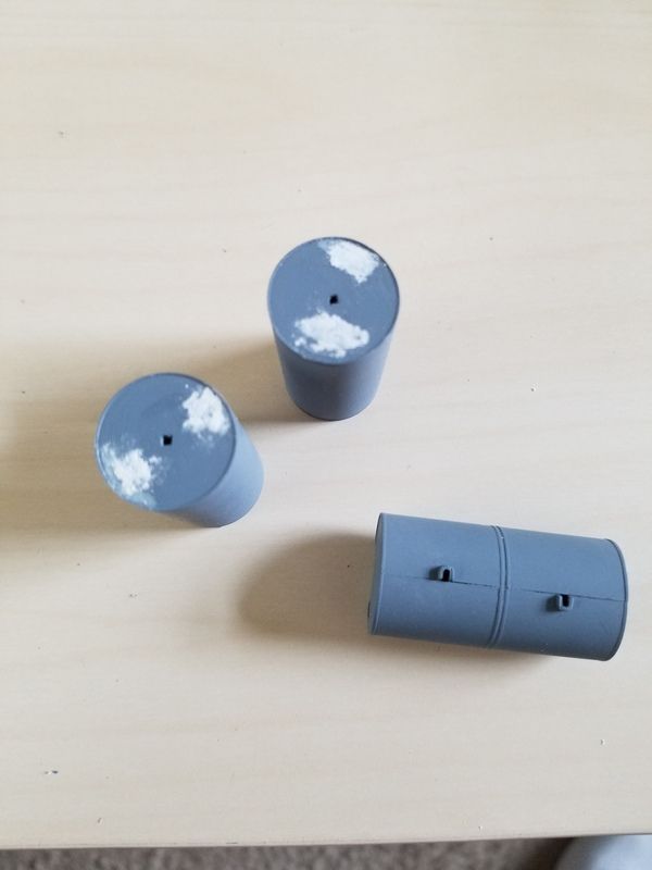

  I did find something interesting in a tube. Vallejo makes a new-ish tube of acrylic putty and I like it because it don't stink and you can thin it with water...
  I was thinking I could use it to finish up the fine lines left on the petrol tanks. I liked working with the stuff. I tried it right out of the tube, and I thinned it with some water, and it worked great both ways. I've used similar stuff before to make water for my little boat models.
  I've never tried to sand the stuff I had before, mostly because it doesn't dry very hard, but the Vallejo stuff dries rock solid. However once I started sanding the stuff, it was behaving...weird. Under the brunt of my sanding sticks, they just seemed to polish the putty and eventually start to chip off. I added some to the horizontal tank to see how it worked with the lines since you can't see them on the finished model. For some reason the putty popped out of the cracks but wouldn't come off of the flat parts. I'm beginning to think I didn't let it dry enough, but it had been drying for a few hours.

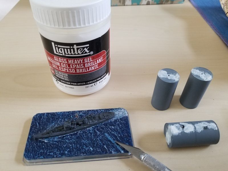

  I also got another little bottle of newness, some of the Microscale Krystal Klear for the gauges. I was surprised to find a bottle of thick, gooey, stringy, gluey, stuff that's a lot like Elmers glue. There's no way to glop this stuff onto the tiny gauges, so I thinned it with a little water...
  I think it turned out ok. Maybe a second coat is in order. They are really hard to see in this picture, but they aren't dry anyway.

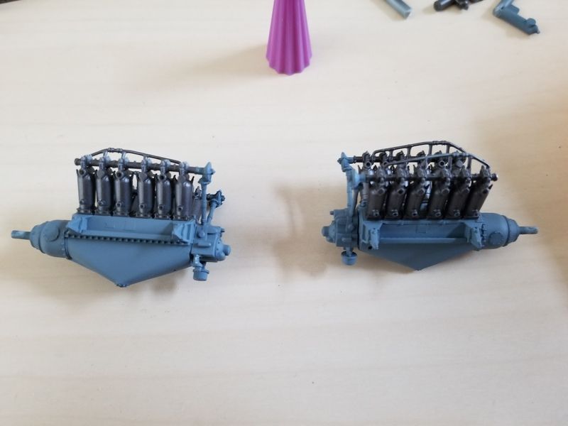

  So after playing with some new model chemistry it was time to get to work on the less hobby side of my weekend. But before I go I just had to mess with the engines a little. Jeez I love these engines!
