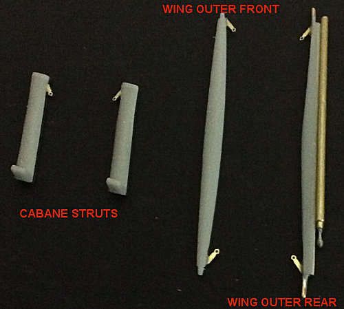

« Reply #37 on: April 13, 2018, 08:49:15 PM »
Hi all,
I've completed work on the wing struts now. The following shots show the inner wing 'H' struts and the outer struts and cabane struts with all of the rigging fittings attached.
Now I can move onto the locations for the rest of the wing and undercarriage rigging!!
Re: SPAD XIII C.1 in 1:32 scale
« Reply #38 on: April 13, 2018, 10:08:55 PM »
Wow, the work on those struts are out of this world (along with the rest of the build).

« Reply #39 on: April 14, 2018, 01:32:24 AM »
It will be a more than decent Spad when your finished!
« Reply #40 on: April 14, 2018, 02:11:25 AM »
Excellent results on the rigging attachments! If you ever go into model conversion/correction business I could use a set of these  ::)
