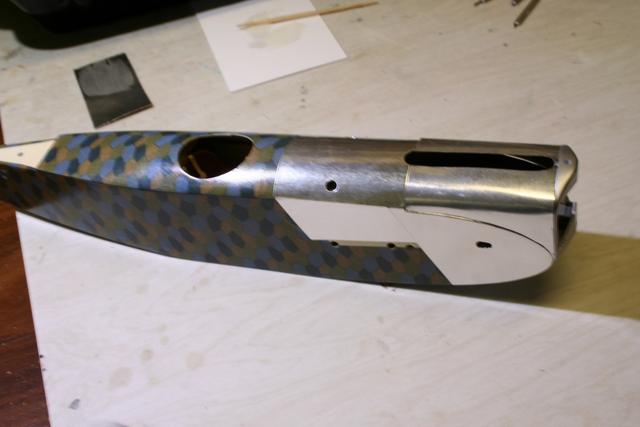

Update for April 1
Seems like things are going slow at this point, but I have put in a lot of time.  I corrected the wings and painted them, and worked out the control connections.  Decalling is started.  I have simulated rib taping with decal strips on the rudder.  I moved the cockpit forward some to better match the photos.  One major learning I am taking away from this build is do not trust drawings made by others.  I based the model on some drawings that just didn't match the photos and this is the reason for all the corrections.
I have made engine covers from sheet aluminum.  They are very fragile, so this may not be a good construction technique for some applications.  I have not decided how to finish them as yet. I also have some aluminum tape used for HVAC ductwork that looks like a good covering material, like Bare Metal Foil, only thick enough to sand and polish.
Covers in place for a test fitting.
The crankcase on the engine was so twisted that I elected to cut the cylinders free and just mount the cylinders in the model.  only the very top will be showing.  One has to be practical.

    Your engine cover cowlings look great, what gauge or thickness is the stock and where did you get it? I'd really like to try to do some similar and any
hints would be much appreciated!

Hello Lance - The aluminum is from a pie pan shown in post #8.  It is 0.006" thick and is partially work hardened from the pressing operation to form the pan.  I am able to cut it with scissors and can sand the edges carefully for fine shaping.  The scissors will deform the edge when cut, so I flatten it back out by rolling the smooth handle of a hobby knife over the metal against a hard surface.  Rolling the knife handle on the metal also makes it curl slightly, so if I want it flat, I turn it over and roll against the other side.  The more pressure you apply when rolling, the more curl.  I attempted to do this engine cover in metal because it is basically a simple curve.  If it was a compound curve, I would have gone with vac-formed styrene like I did for the bottom cowling.  I made a paper pattern to start with (seen in the first photo of my last post).
Richard - You are right about drawings.  This plane has next to no documentation and only a few pictures to go by -  A double edged sword as you can make up your own details, but the overall look should match photos as much as possible.

Update for April 8
Made some significant  progress lately.  Decaled the fuselage and put on the aluminum panels, installed the harness in the cockpit, and started the landing gear.

Making a pattern for the front of the cowling.  The rear part is on.  Made these with aluminum tape used for air conditioning ductwork.  It can be difficult to work with as the adhesive is very strong, so it can't be pulled up without ruining it, and it will lift up any decal it is applied on.
This shot shows the aluminum work done.  I will tone it down with some Tamiya flat clear after installing the engine cylinders and exhaust.  I will detail it with fasteners and access hatches.
