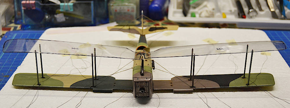

After rigging the first 4 couples of cables that did not involve the upper wing I decided to prepare all the rest of rigging BEFORE glueing the 8 struts and putting the upper wing on top.
That was because the EZ line is very difficult to slip into the anchor points I built for the double wires
I preferred to put the line in position now so at least for the bottom wing the job is easy enough, for the top wing... well I don't know...

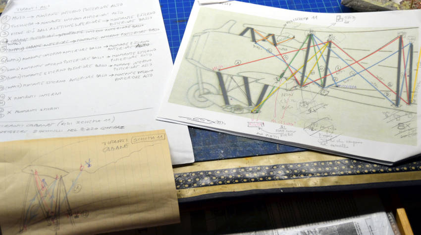

Before going on I needed to make a numbered list of all the cables needed:
On the left the written list, on the right the schema you already know with the numbers on it.
Excluding the tail and the cabane, there are 13 cables to set on each side of the plane, where the couple of double wires counts 1.

After completing the rigging I will glue the struts and then the upper wing, the problem is how to turn the plane upside down to work with the top wing laying on the table, what will happen to the intricate set of cables?

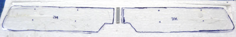

By now I re created the shape of the wings on a piece of transparent thick acetate (from a shirt box) and marked the struts positions, drilled out, to give the struts  a correct position once glued to the bottom wing.
I should have done it before putting eyelets and control horns on the wing, so I just laid the acetate on the wing and traced very gently the profile with a marker...

I used the transparent acetate wings to keep in place the struts between the wings while the glue was drying:

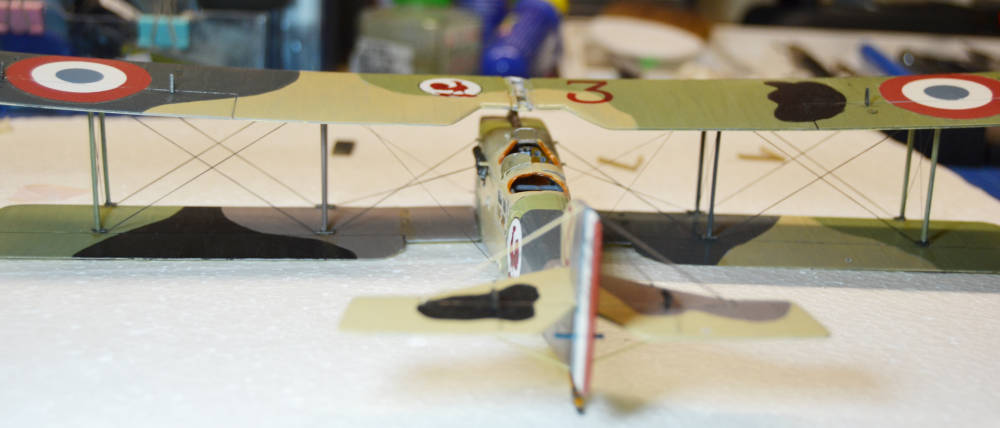

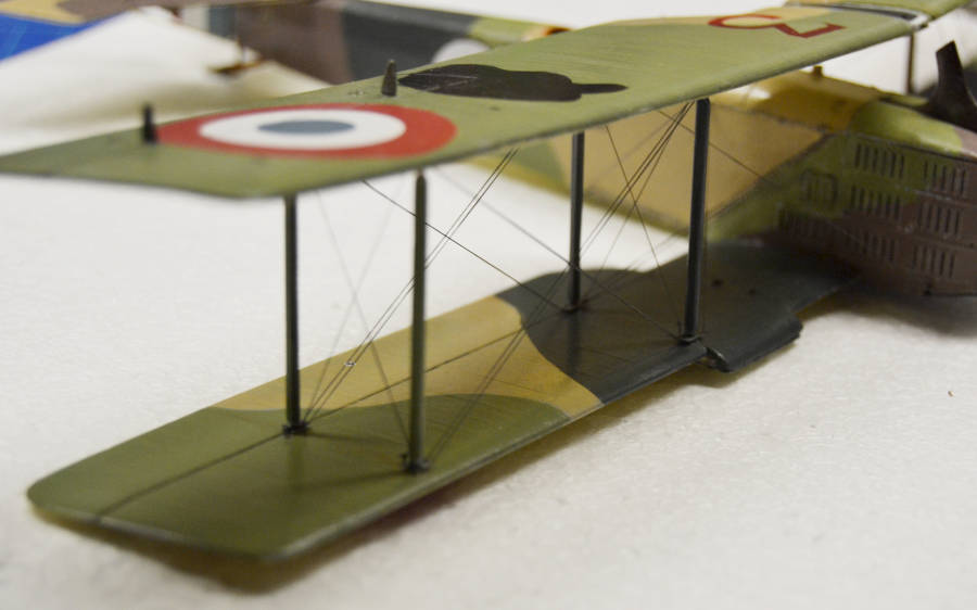

Then completed the rigging work between the wings:
I forgot, as clearly stated on the instruction sheet, that the leading edge of the upper wing should be 4mm backwards with respect to the one of the lower wing, so the struts should have been tilted backwards, while I made them vertical.
I have put the cabane struts on and of course I needed to glue them 4 mm forwards not matching the holes in the fuselage.
This work is lasting too much and I wouldn't take further time to correct this error, so I went forward and closed the gap among the two top wings.
I'm going to add more meaningful details before shooting new photos.
Thanks for your attention!
Antonio
