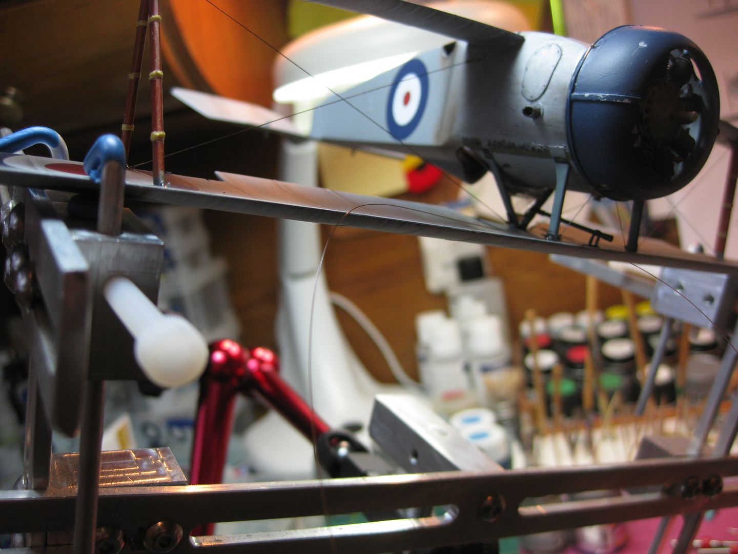

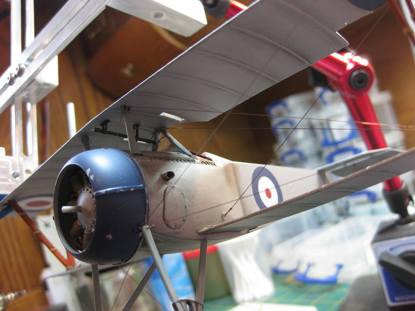

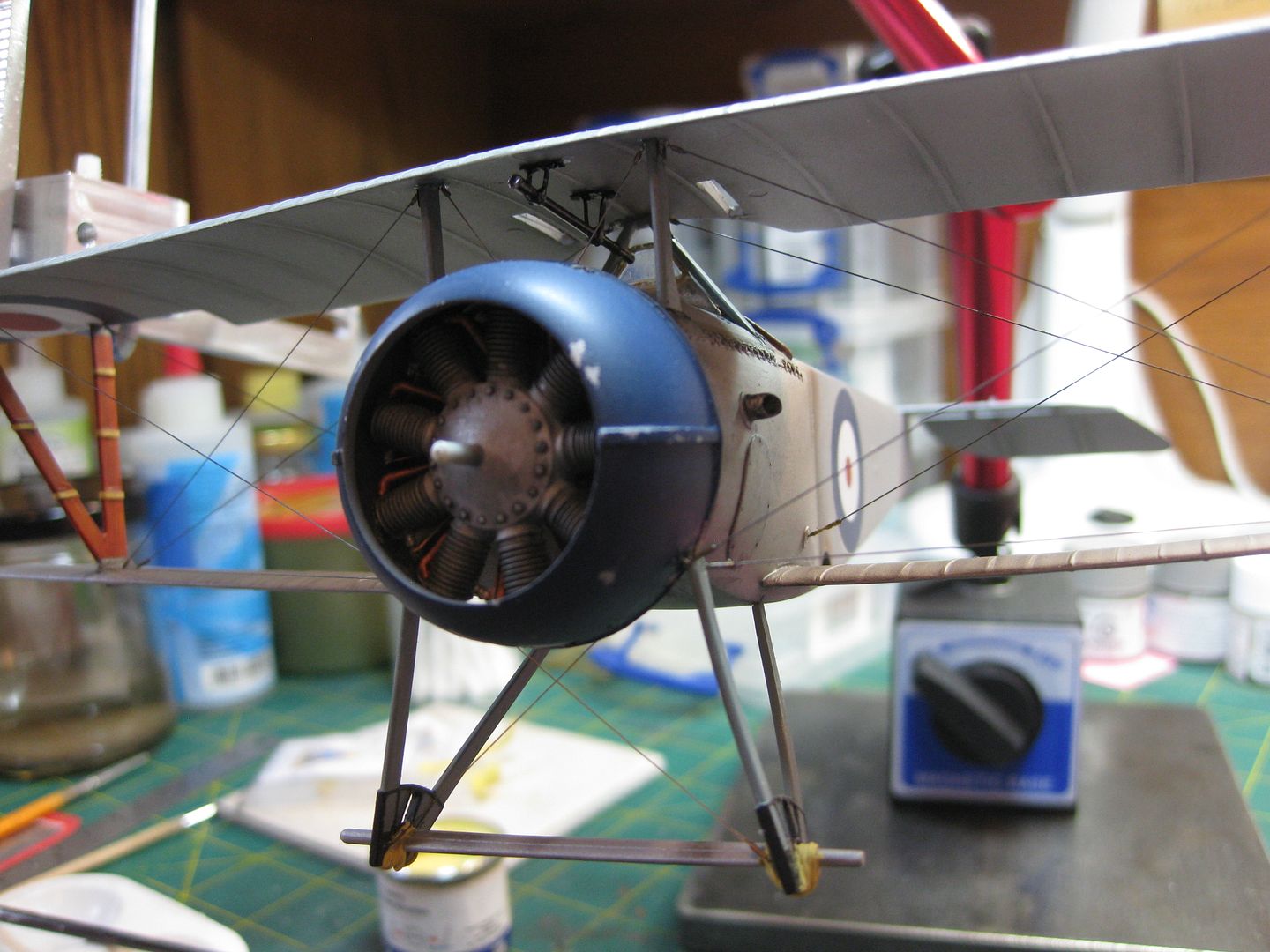

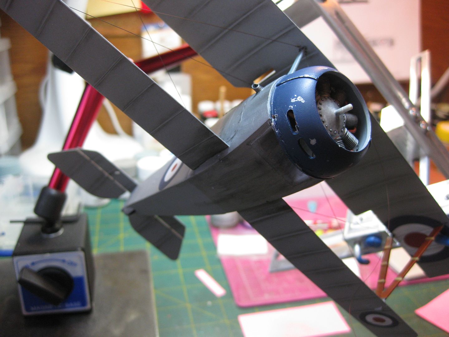

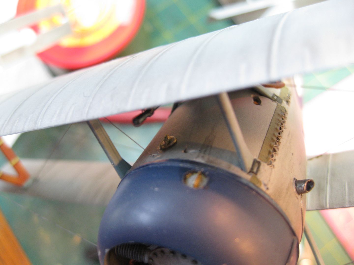

    This Build is starting to speed up now and the completion is in sight. I completed the main and landing gear rigging this morning with the flight control surfaces and lines next on the schedule.
    The "Magic Third Hand" proved a tremendous bonus yet again, the model was mounted inverted on the cradle by the upper wing and it will remain there until the flight control rigging is complete. There's just not an angle, aspect, nor "pose" that cannot be set within seconds to optimise ease of installation with this little beauty!

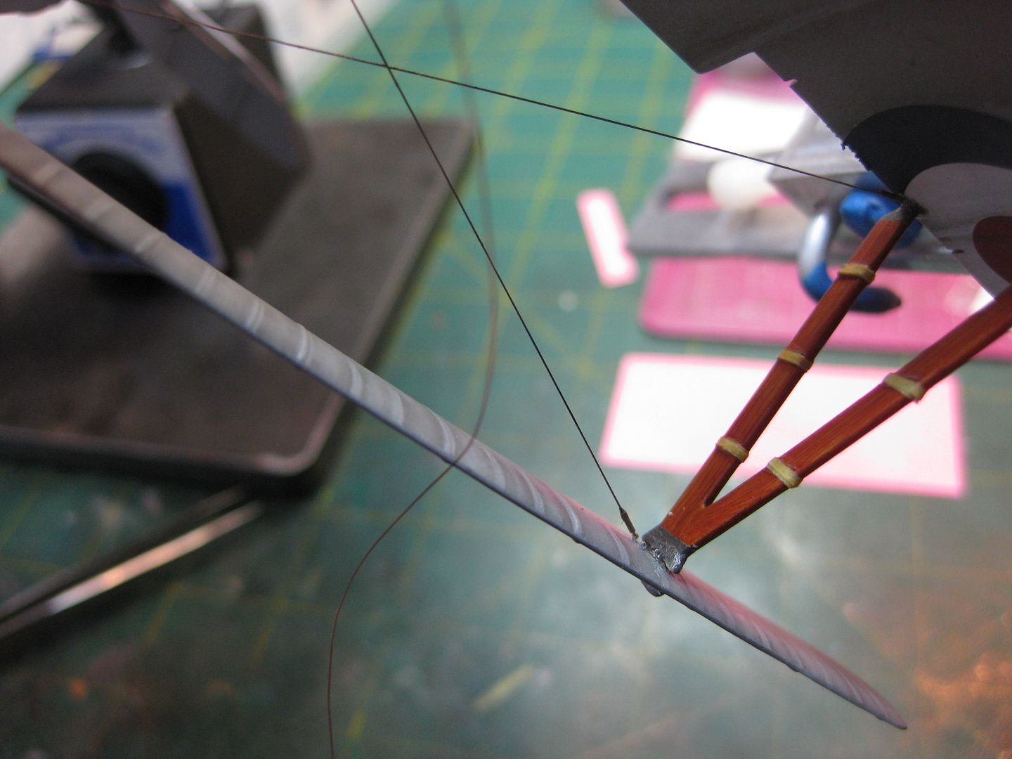

   The main rigging was done with .005" / 0.12mm Maxima Chameleon mono fishing line, Bob's Buckles, and GasPatch turnbuckles where appropriate.

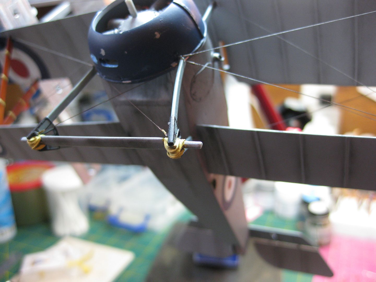

    The landing gear was assembled and installed mid way through the rigging phase. The rigging line for the gear is Modelkasten, the bungees for the axle done with .015" lead fly tying wire.
   I also scratched a gas tank cover, forgotten earlier, and installed it on the top cowling. The cabane rigging wires were done with Modelkasten line.
   .....and here she is, rigging complete and ready for installation of the ailerons and "tail feathers".
    So far things have progressed pretty smoothly however she'll need a lot of touch ups before completion.
