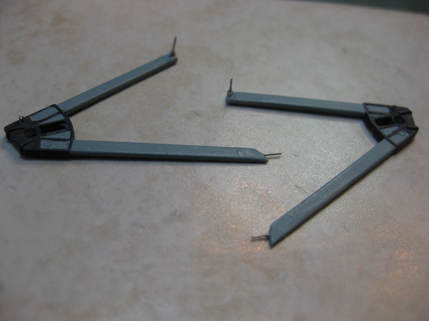

Thanks for the information Tug and Greg. Since posting I've managed to "pin" the undercarriage struts with stainless steel wire, a delicate task but not as difficult as I thought it would be. They were by far the thinnest stock I've done in this manner but I think they'll be just fine. I'll be posting another update with photos shortly.

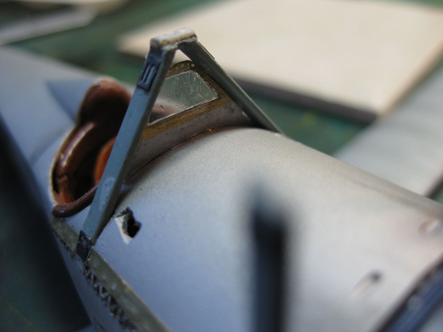

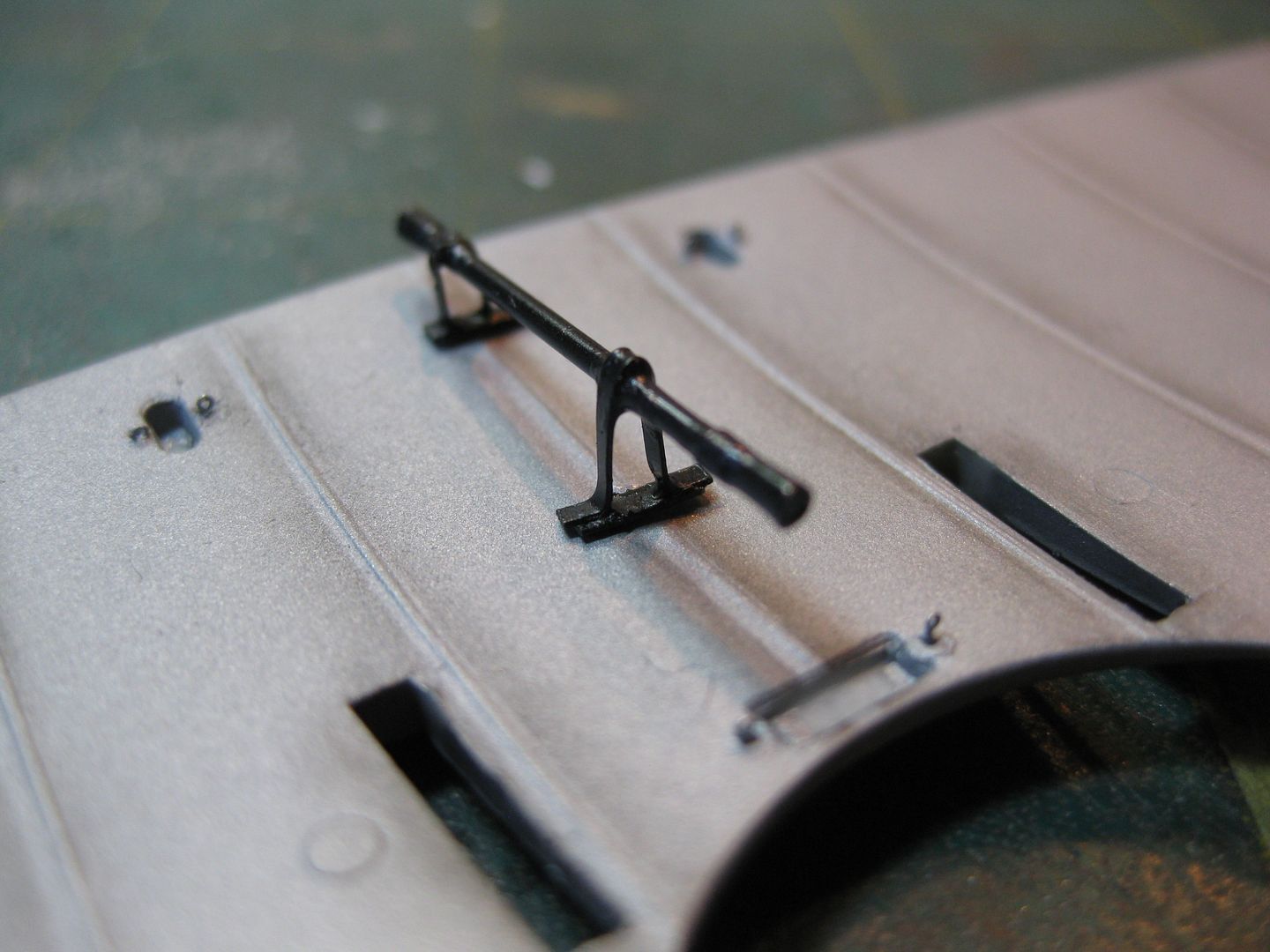

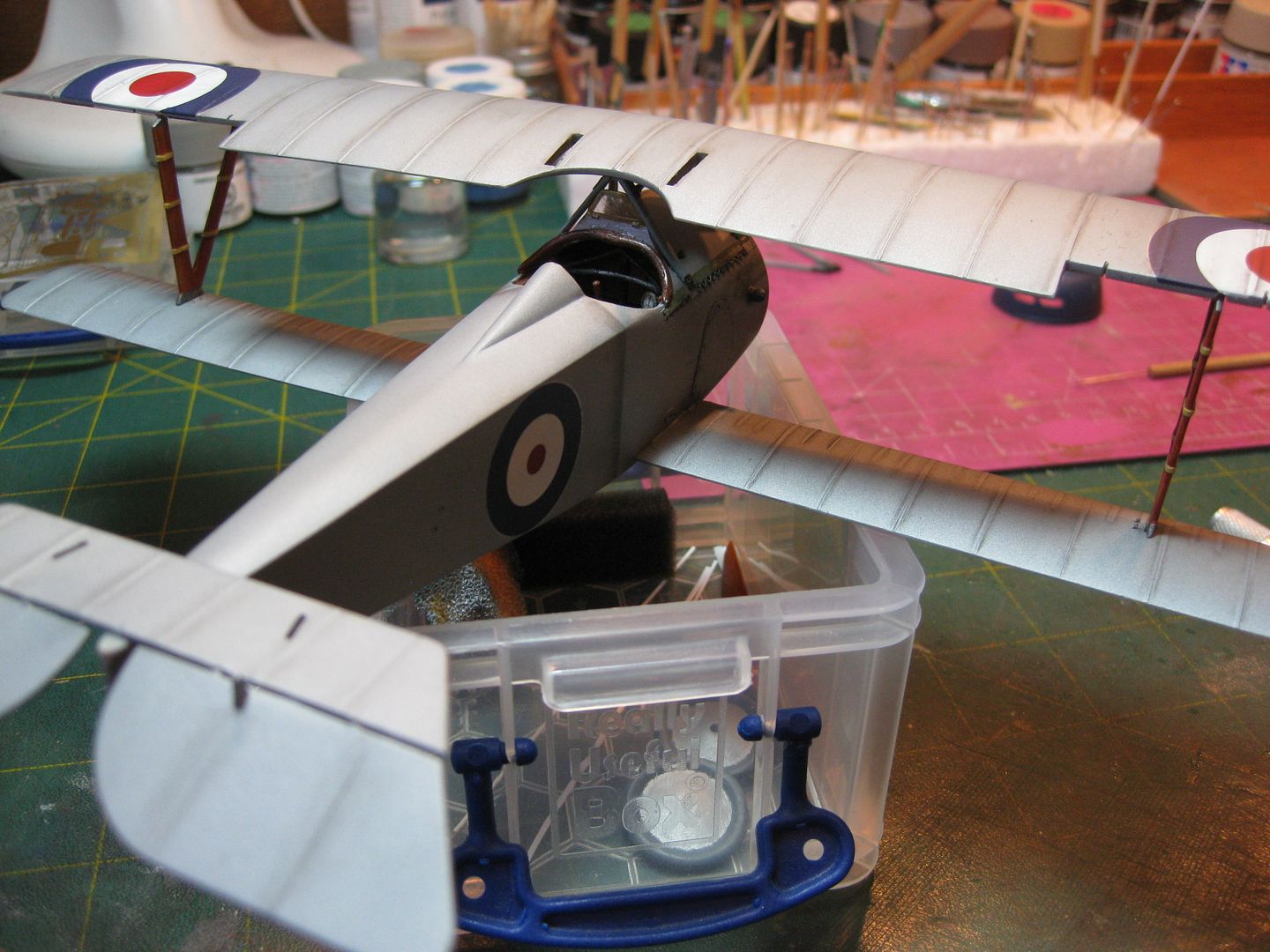

Here's the latest small update. I've been adding last minute details in preparation for mounting the upper wing. The Scratch Built Aldis Sight was attached under the upper wing first:

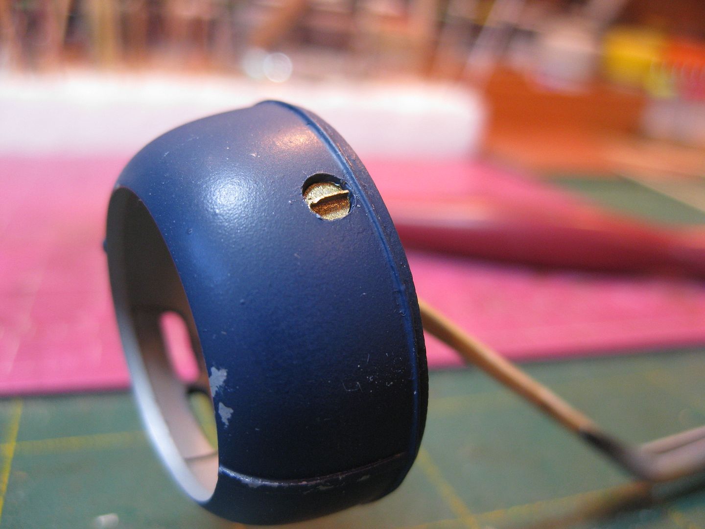

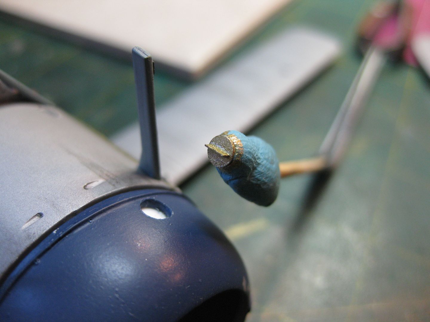

    Next came a cap for the oil reservoir after drilling the opening in the cowling.....
.....and the finished product:
    The undercarriage struts were "pinned" with stainless steel wire and the windshield installed as well:

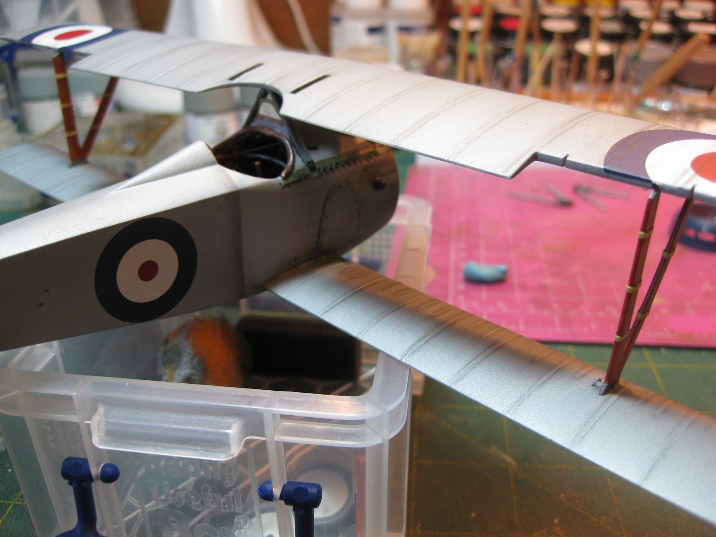

     Last, and "at last", the upper wing was attached. This part of the assembly went remarkably well and quickly; the wing is nicely aligned and solidly held with CA.
    Next comes the rigging; I prefer to leave the control surfaces off if possible and the landing gear assembly as well until the rigging is complete, otherwise I tend to knock it all off during the main rigging portion of the Build.

The sight looks awesome mounted on the wing as does the results of tweaking the struts to mount the windscreen. The fuel cap is excellent. Finally, she looks beautiful as a bi plane!

Really nice work Lance and great attention to detail - I see what you mean about minimal plastic to work with on those legs but it looks like you've nailed it just fine.

Really nice work so far and adding the wire to the U/C legs is something I must look at doing next time round.
The windshield looks very tidy as I hoped mine was going to be until I realised I'd forgotten to mask one side!! ::)

The Aldis is a beauty!

   Thanks for the comments and especially for the link, that is indeed a beautifully built Ni.11. That "Blue Stuff' is fascinating and I do have an unbuilt Wingnut Wings Pup LeRhone I could copy, great thought! Your Link has already proved very useful; as I was looking through the photos I spotted the gas tank cap on the upper cowl, think I missed that earlier so back to the bench!!
