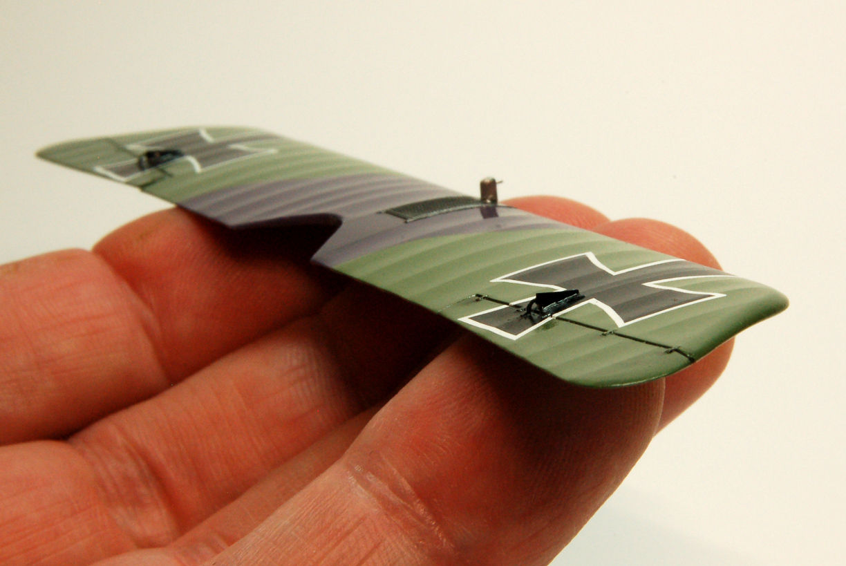

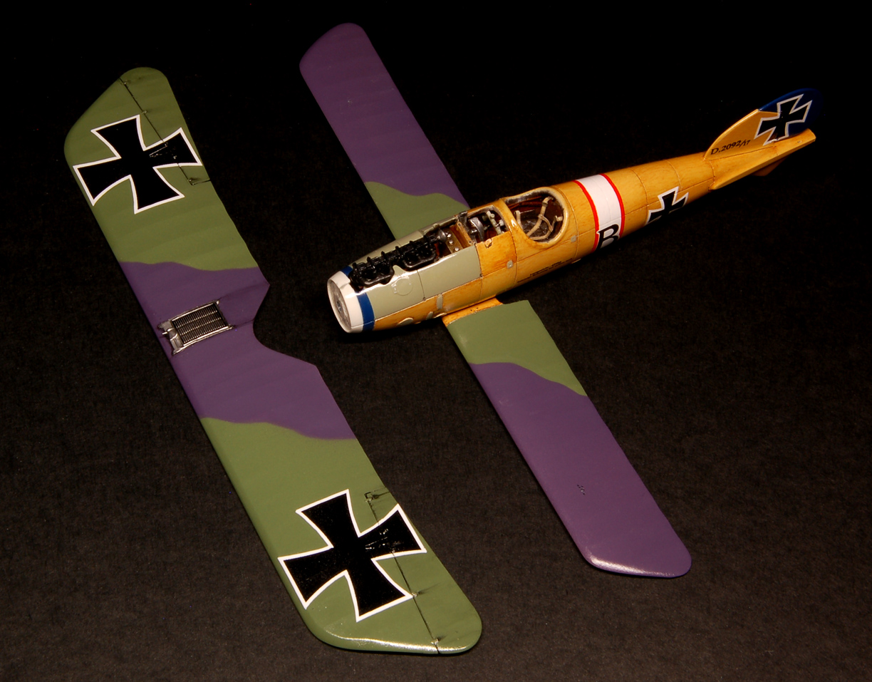

Following IanB's & PrezemoL's advice, I applied the decals, then the control horns. I attached them to the wing with Future, then followed up with another coat or two, which explains the glossiness of the wings at this stage.
Over the weekend, I glued the rudder on & applied the remainder of the decals to the body. I used small strips of aluminum foil for the hinges here, as well as on the ailerons. A great tip I learned here  from Vincent & others. This is an earlier photo when I was working things out.
The decals are pretty intense at this point, but will be hopefully toned down with washes & a bit of weathering. The crazy thing is that some parts of the Eduard decals are matte & other parts glossy. So after decal application, I applied a few coats of Future to try & even things out, plus add more protection for upcoming steps.

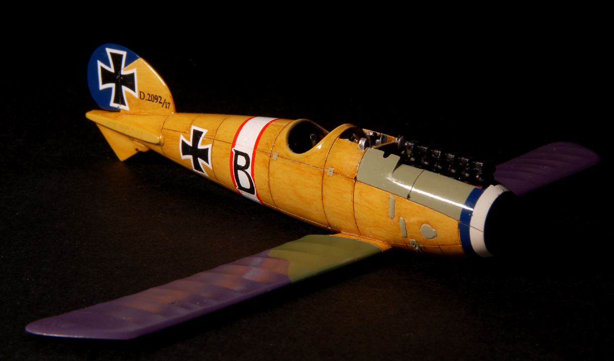

Offline steveb
  • Posts: 237
Re: 1/72 Eduard Albatros D.V. My first WWI build since 1968...
« Reply #73 on: October 03, 2016, 12:53:26 PM »
Thanks again for the kind words!! I know the cars don't fit here, but I didn't want to mislead anyone into thinking that I hadn't built a model since 1968.

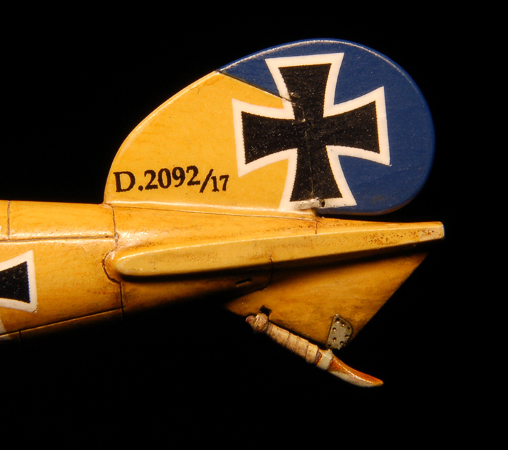

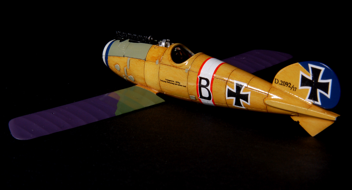

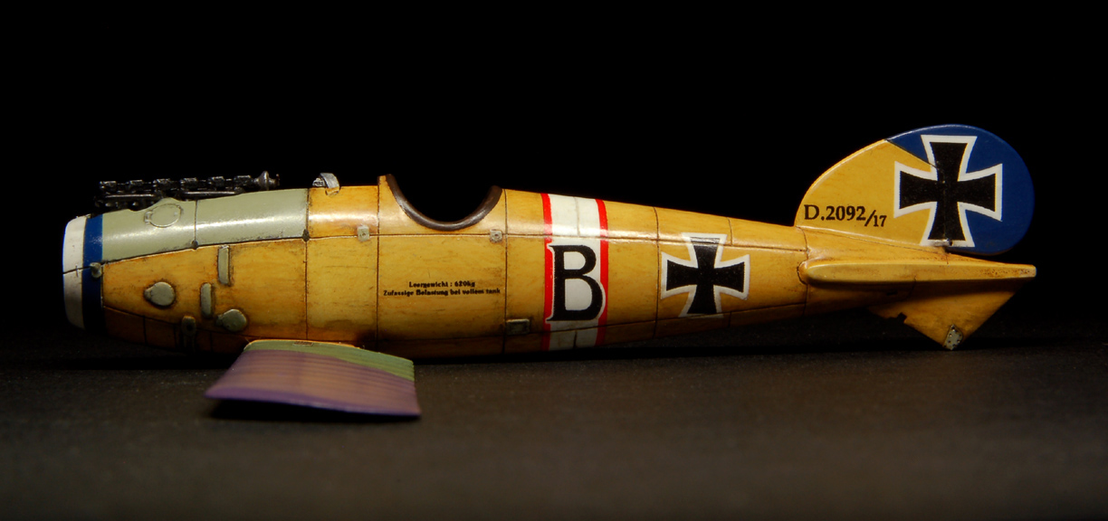

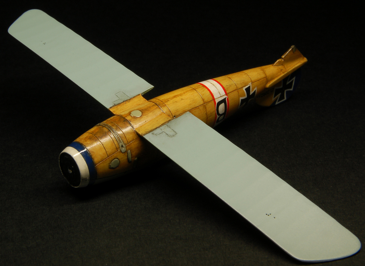

This weekend, I spent some some time adding stains & other discolorations. It was a learning thing, trying to walk the fine line between factory fresh & well worn in battle. It's a bit overdone in some places, but I'll keep trying. I also added little bits of wire to represent the springs to hold the cowl parts together. They still need to be toned down.
I added the footstep on this side of the nose, but I'm wondering if it should be painted blue like the stripe?
I still need to add another hatch down here in front of the wing.
Just to see what things looked like, I added the tail skid for this photo.
