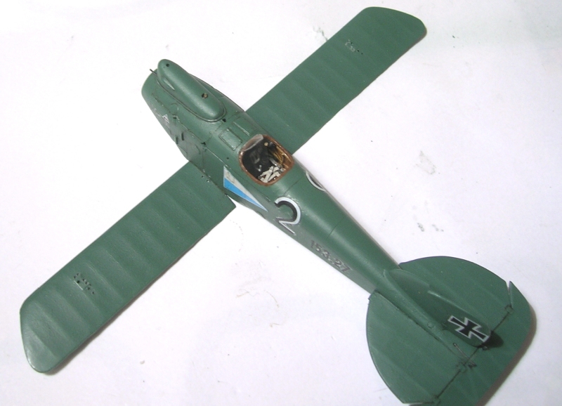

The lower wings were glued in place. To get the right dihedral angle (which is rather important for the outer wing struts to fit when the upperwing is fitted), I put small wedges below each of them while the glue was curing.
Then, the lower side was painted light blue (I used Humbrol 65). I then made a mix of 30 and 89 to get the upper blue-green. I poured a bit of it in a paint jar and added one or two drops of white, then sprayed the wings and stabilizer. After that, the ribs were masked with thin masking tape stripes, and the final darker blue-green was sprayed over.
When the stripes were removed, the ribs were too visible, so I made a light overspray with blue-green to blur the ribs a bit.
The red arrow shows the lip around the winter cowling, which was made from strectched sprue and glued with CA in 3 or 4 steps.
This is one of the typical details which give those birds their "steampunk" look I love.

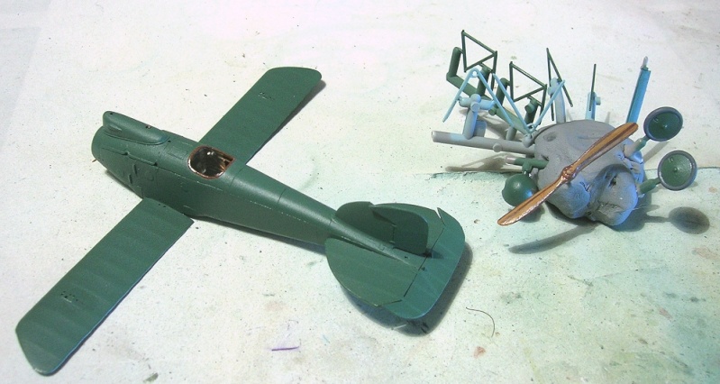

I've added a good coat of Future before applying the decals. The rib shading got faded but remains visible. To the right, a pack of parts including the painted prop.
The radiator was painted brass and gunmetal. Then, I called the guys at Roden with bird names while trying to apply those f... decals. They tear off, destroy into pieces when you try to move them on the kit, or stick to the cloth rather than to the kit...Moreover, the paint was not smooth enough because it was too flat before the coat of Future, which tends to produce a silvering effect. So, when it all has dried up, I had to make some touch-ups with black and white paint, then I used more Future so it infiltrates below the decals and fills up the bubbles causing the silvering effect. The Future also helped the decals sticking a little better. In the end, it worked rather well except around the '2-7' digits on the fuselage. I'll make a small cut right here to put some more drops of Future below.
After that, I'll use oils to give a little more volume to the small kit, but not much more weathering as it looked rather clean on the archive pic I have.
