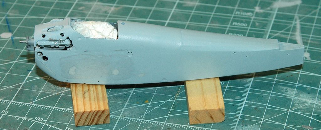

« Reply #82 on: May 29, 2016, 03:47:18 AM »
Progress is being made. I've got the guns and instrument panel fitted, the top of the fuselage in place, the engine fitted and aligned, and the whole structure filled and sanded to shape. There was a lot of the filling and sanding, as I used CA glue to beef up areas that were either out of alignment or paper thin. With the nose cap fitted, which should take place this weekend, I'll be into the PE fitting and the paint phase next week. I have no idea what made me fit the fuselage PE before joining the fuselage halves and then trying to fit the fuselage top. Probably misguided faith in the kit, and/or misguided faith in my abilities with short run kits. In any event I hope to be at the "wing fitting" stage in a week or so.
Thanks for visiting!  8)
Cheers!

Offline Trackpad
  • Posts: 1306
Re: Blue Max 1:48 Sopwith Dolphin
« Reply #85 on: May 30, 2016, 01:28:48 AM »
Thanks, Des and Chris,
The nosecap is now in place and will not need much in the way of filling and sanding. Accordingly, it's "PE Placement" time, followed by the painting phase. Feels rather good to get the fuselage to this state!  8)
Cheers!

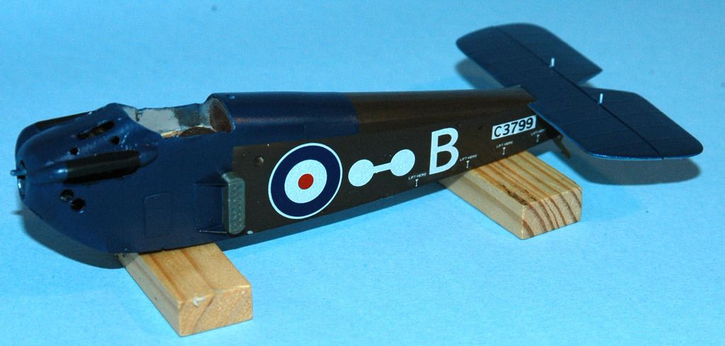

Offline Trackpad
  • Posts: 1306
« Reply #87 on: June 20, 2016, 06:46:56 AM »
Just a short note to say that I'm still in the hunt for a finished Dolphin! Here's where I stand as of today with the fuselage:
Remainder of the tail and the u/c next, then come the wings!  ;D Thanks for visiting!
« Last Edit: June 20, 2016, 10:42:29 PM by Trackpad »
Cheers!
« Reply #88 on: June 20, 2016, 06:59:13 AM »
Looks great! It is also in the scheme I want to do if one ever becomes available in 1/32nd! Looking forward to the next update.
« Reply #89 on: June 20, 2016, 07:47:24 AM »
You have done an excellent job so far Gary, the colours you have used make for an extremely attractive looking aeroplane.
