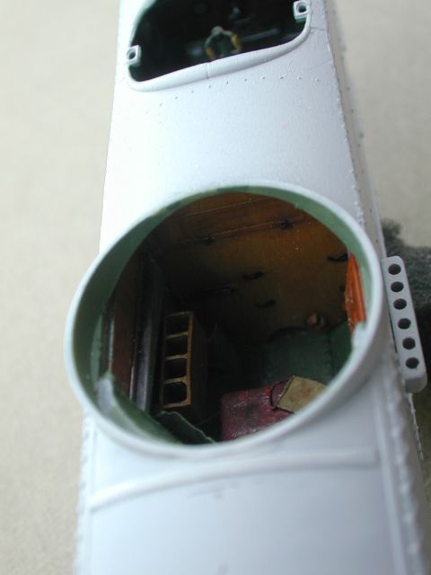

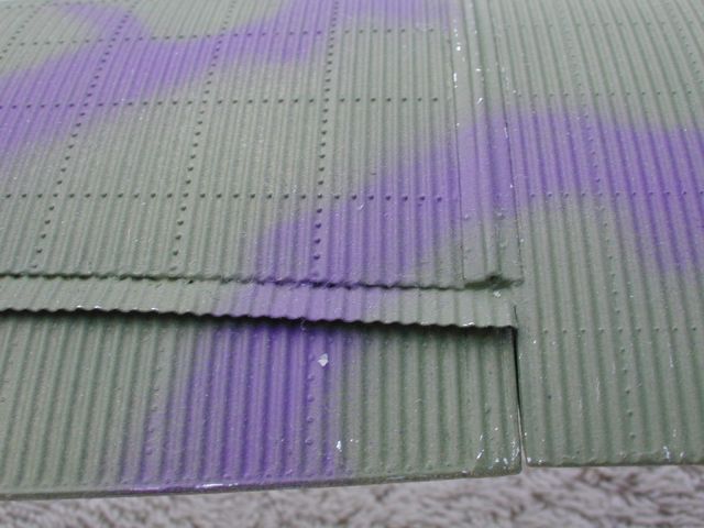

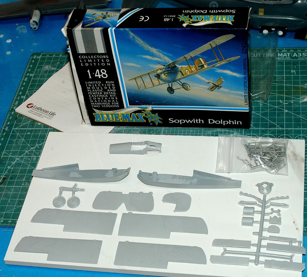

Hi, Colin, and thanks for visiting. Here's where I stand now in this rather slow build:
I've just thinned the cockpit walls again and repainted them, as I didn't get them as thin as is necessary first time around. I'm rib-taping and weathering the wing sections now, and will get to the interior next. I did buy the Dolphin Datafile and I find it to be very useful in this build. All in all, quite enjoyable, and a significant switch from a WNW kit! Any guidance that you might wish to provide will be most welcome as I progress with the model: TIA!  8)
