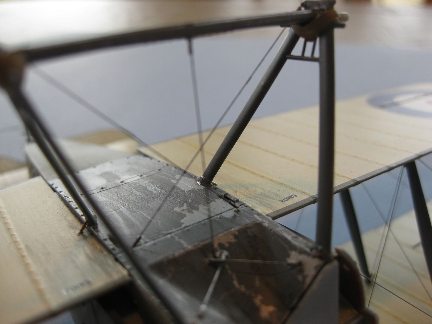

   I can't believe it's been more then three weeks since my last update. Two weeks of travel and a holiday in Ottawa, our national capital, sort of put this project well back on the priority list. In addition to a great meeting with four fellow Forumites, tours of the Canadian War Museum and the Canadian Aviation and Space Museum, and a great IPMS Convention and contest and opportunity to get "Hands on" to William Barker's Snipe at the War Museum it turned out to be a truly great memory.
     Here's our group in front of the original fuselage of E8102 in which William barker flew his truly "Homeric" Victoria Cross Mission in October of 1918, and myself "feeling the vibes" from this incredible artifact......a truly moving experience.

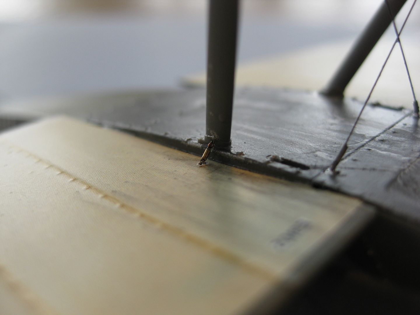

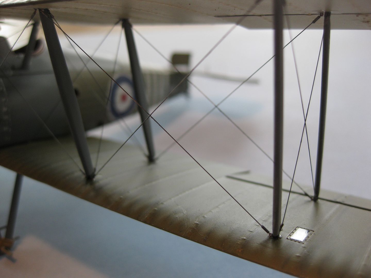

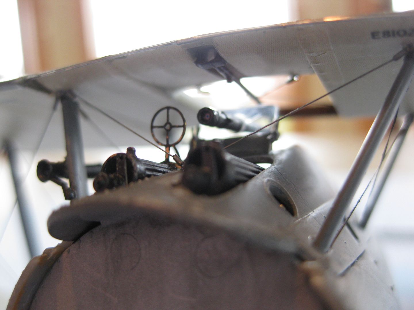

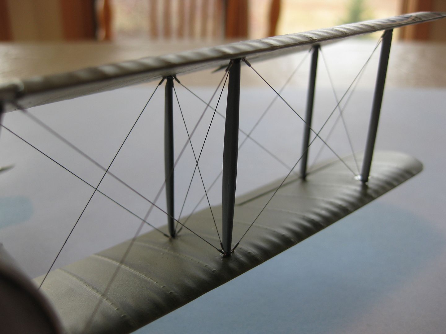

    I've completed the Main wing rigging which, other then the cross rigging of the main spars was fairly routine. The former task proved a real challenge as getting in between the main planes called for about three fingers more then I have! The longitudinal cabanes had benn  completed prior to mounting of the upper wing leaving only the front lateral cross braces to do.
A few places to do some paint touch-ups evedent here......

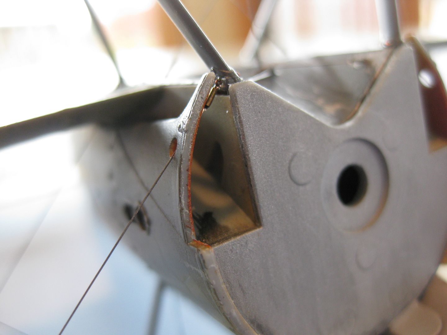

A very tight fit on these next two attachments, and fairly time consuming.
    The viewing of the real thing made me wish I'd done better on this one, she's grown more then several "warts" already and is far from complete. The aft fuselage as displayed has not, to my knowledge, been refinished and the application of markings, especially the white stripes on the fuselage is very "rough"; not, I'd speculate, unlike most other field applied personal markings of the era. I do wonder at the PC10 painted "turtle deck" and forward upper metal cowlings, if I do another I'd consider foregoing the Battleship Grey and doing it per this pattern. A few examples in the references have PC10 vs. grey on these components but, then again, the photo of the aircraft after recovery from the crash site (#29 in the Data File) shows a very vivid contrast between the (Grey?) metal panels and PC10 Fabric.  :-\ :-\ :-\

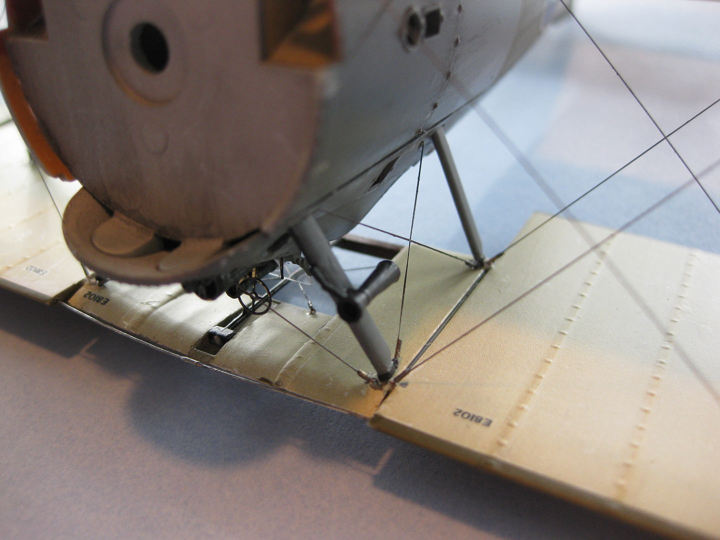

Thanks Greg, and yes, the chance to see the real thing up close was a truly thrilling experience. They also had Bishop's Nieuport 17 prop, spinner, Lewis Gun and windscreen complete with bullet hole on display, all in a glass case. I had seen the windscreen on a previous visit, the rest was a pleasant surprise. The blue (LVG??) spinner finally confirmed the colour for me, much darker then I had thought, almost black in the typically poor museum lighting.
   Rick, the rigging can be a bit of a puzzle for the attachments to the landing gear struts; Jamo's photos were very helpful to unravel the puzzle. Thanks for the positive comments, I guess I hid the warts well! ::)
