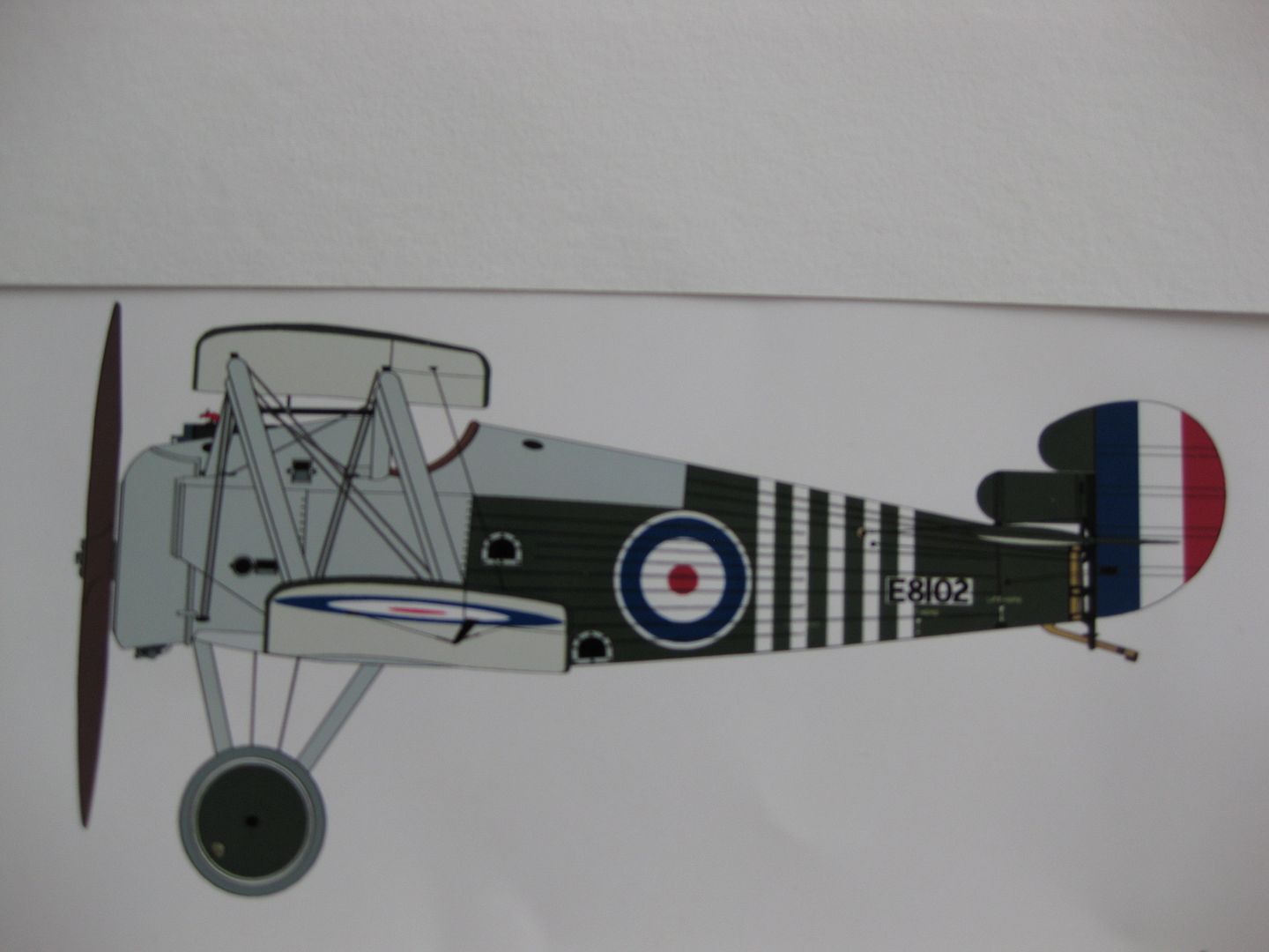

   Here, for illustration purposes only, is E8102's Profile per the Pheon Illustration:

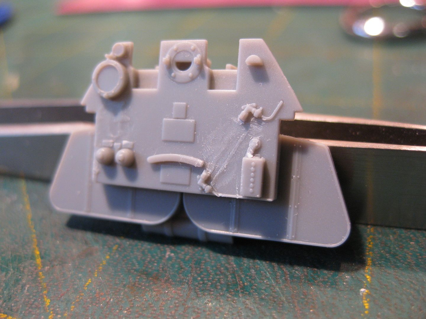

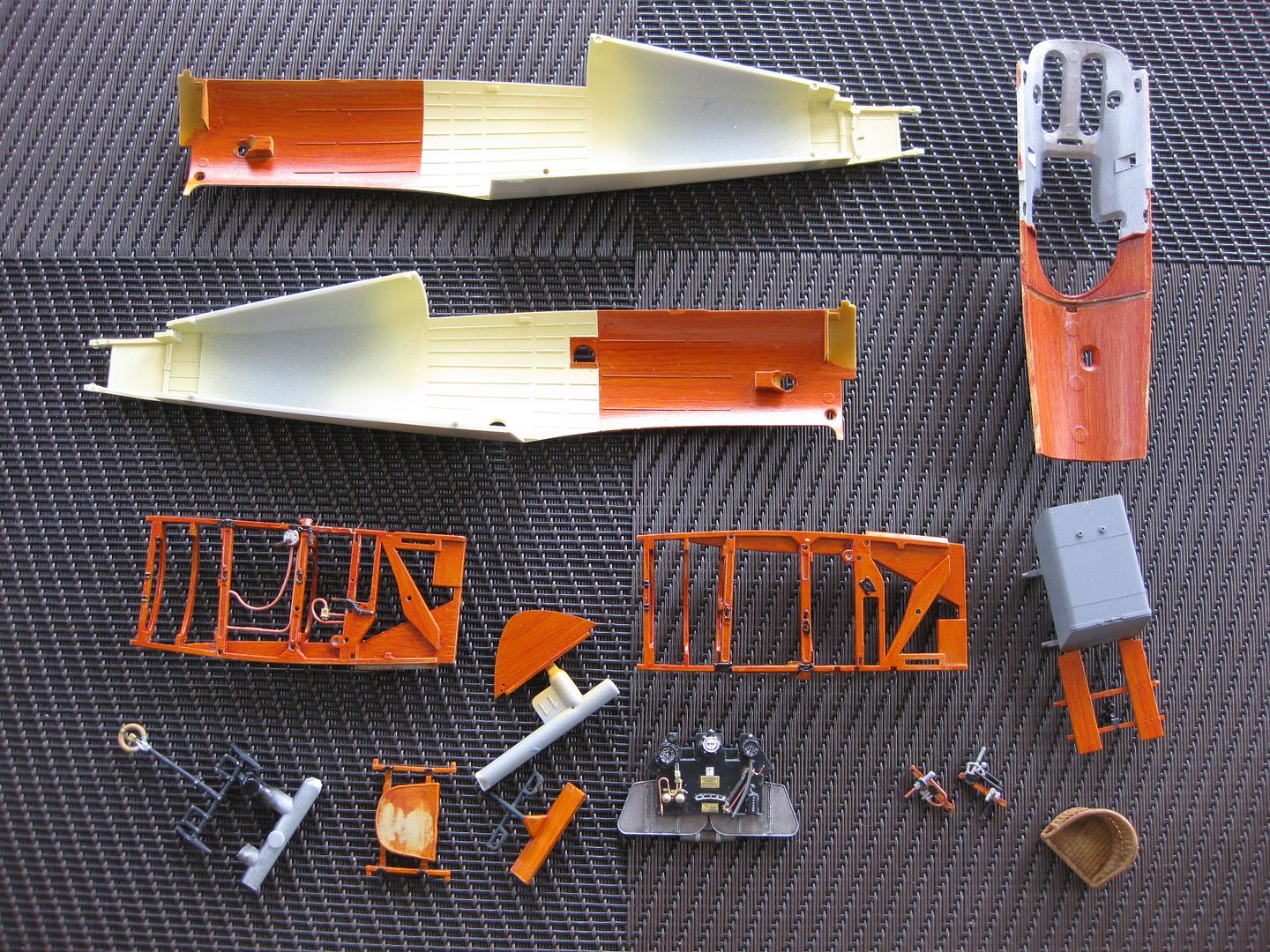

   I started the Build with the Instrument Panel, the cockpit proper to follow. The panel had the Feed Tank glass and copper gauge system removed and replaced by clear sprue and copper painted sprue. Aero Club and Eduard Instrument Bezels were added as well and Future "lenses" added to the Instrument faces. here's the bare panel.......

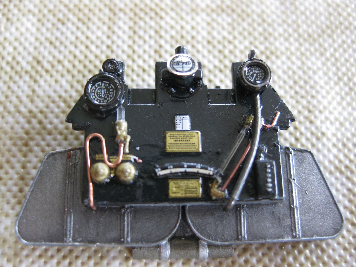

    the completed panel with the standard LCarroll Workbench dog fuzz in place.........
    and the slightly cleaned up final version......

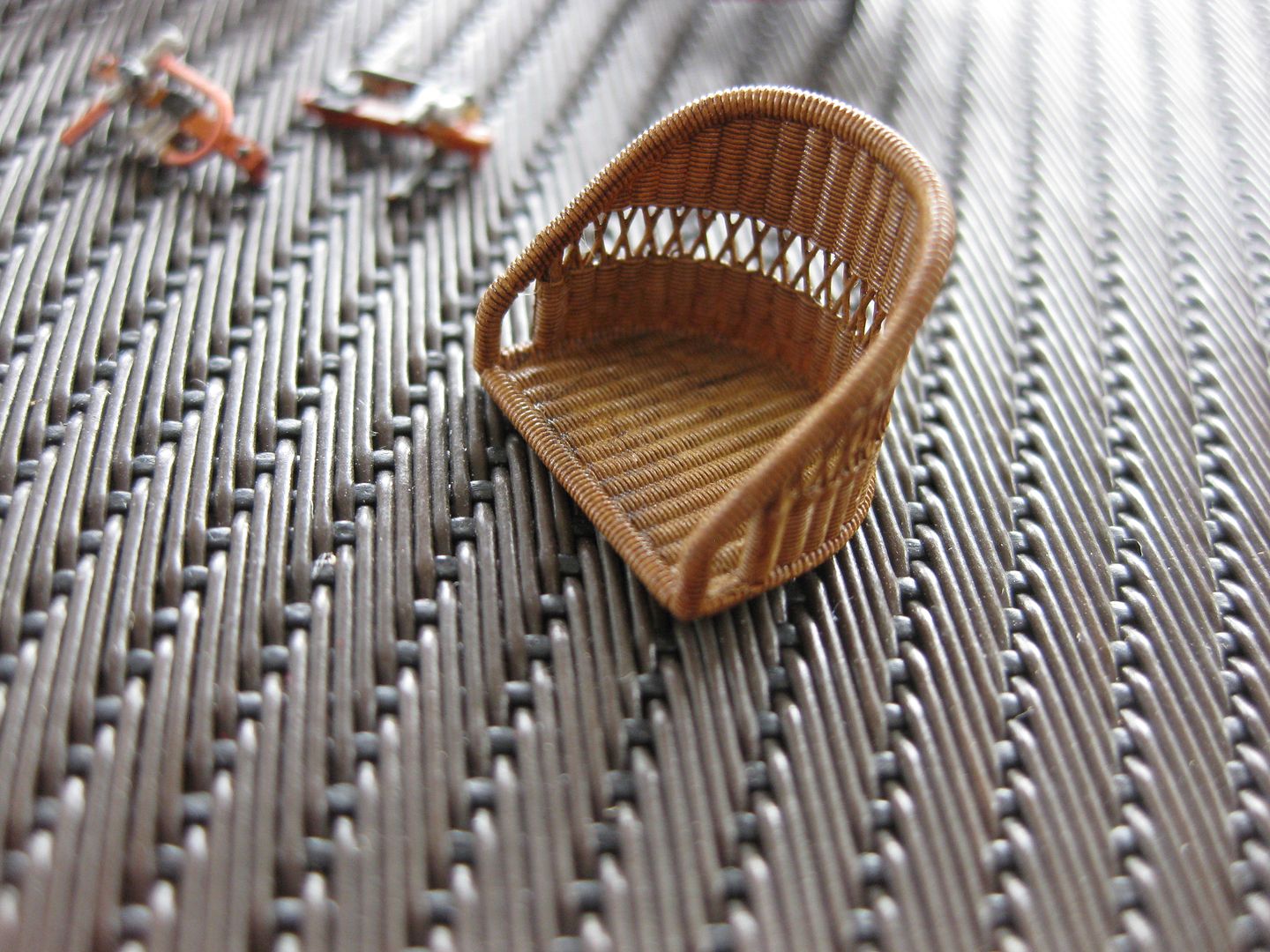

   I forgot to include the Barracuda wicker seat in the list of A/M additions, an absolute little jewel of a product. This is the low back version...
   I've been working on the cockpit module and fuselage sides as well, they are nearly complete and the internal bracing and assembly of the module comes next.
   So far a wonderful Kit, the standard always anticipated and provided by WNW. I'm looking forward to this Build and Chris's as well.

Wow! This is looking great and so soon into the build too. I really, and I mean really like how you removed the feed tank glass and copper gauge system and replaced it all with clear sprue and copper painted sprue. It looks so much better than what WnW provides. I wonder why I didn't think of that?

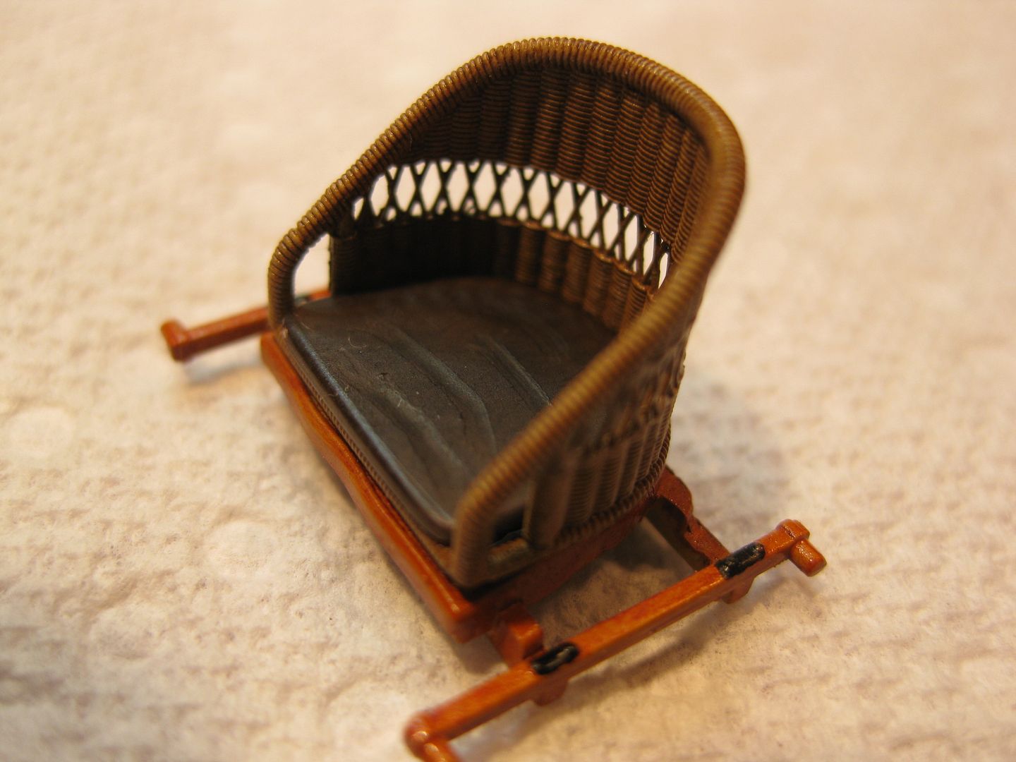

One question, now that you have that lovely seat: how does one access the fuel tank? Or did this example not have it under the seat?

Zac,
    The Kit seat comes in two parts, the frame and base with the cushion molded to the base and the wicker surround as the second piece. I trimmed the base down to place the Barracuda seat on it and added my own scratch cushion. The access to the fuel tank is under the cushion per the standard design.
   The Kit supplied seat is very nicely done, I just thought the Barracuda one was even nicer, and since I had bought 2 earlier, in she went!
