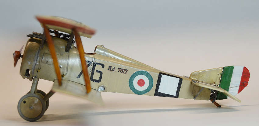

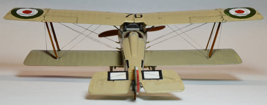

Those look more impressive every time you add an extra post! The details of the rigging were very useful, but I was also take by the use of the eyelets for the attachment points for the rigging. Given the scale that is a truly impressive piece of modelling.

These Hanriots are becoming more beautiful at every new shot. I'm looking to see the completed lineup!

Thanks Stephen and Giuseppe!
Antonio

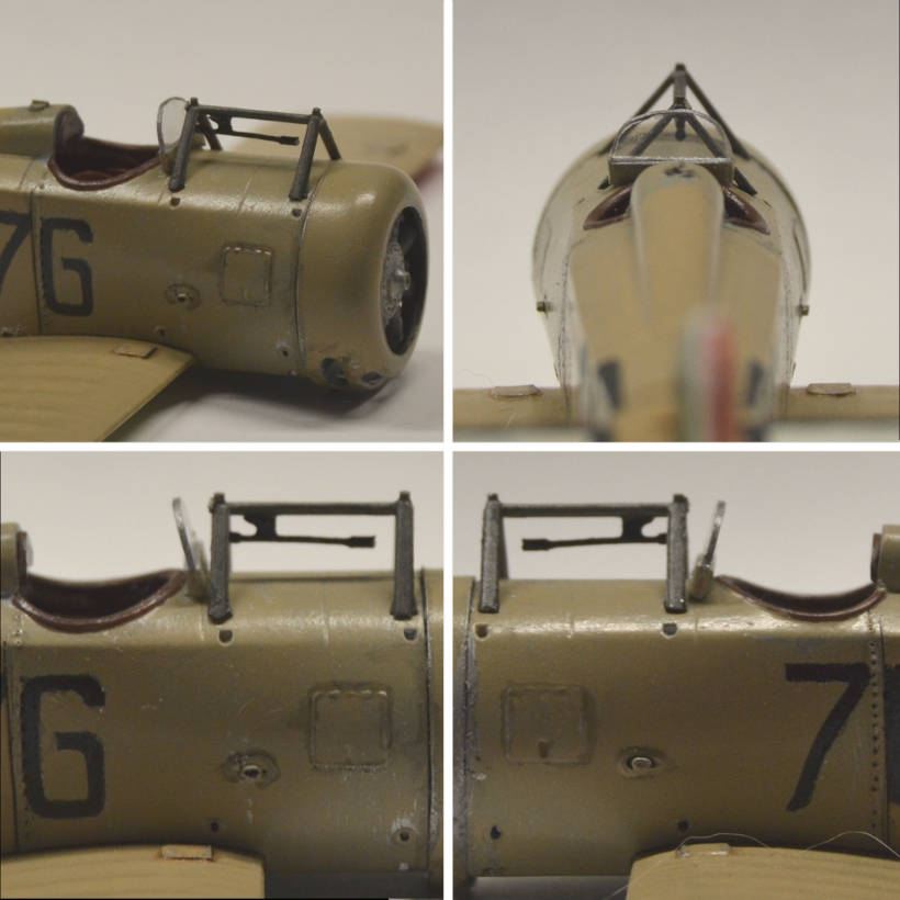

Hi friends,

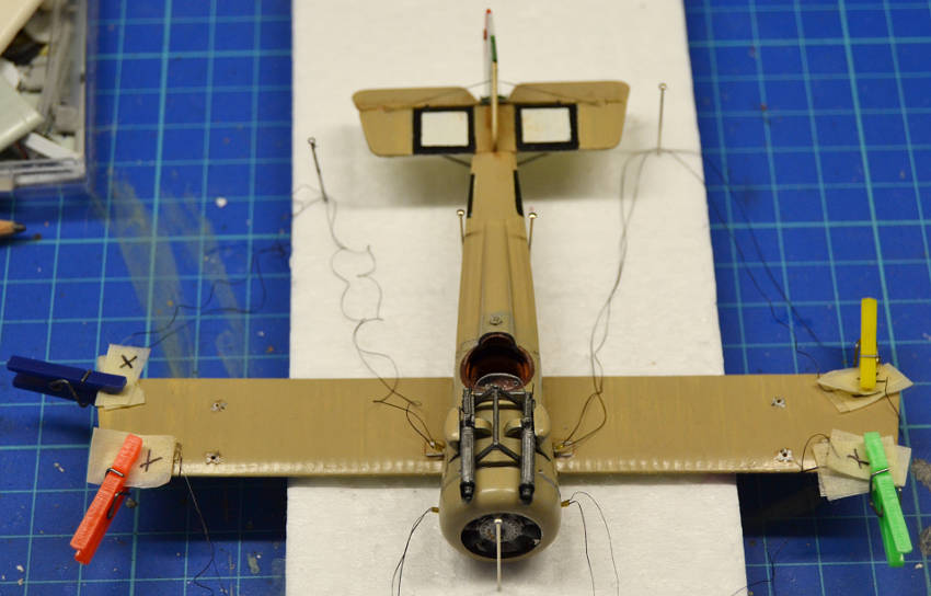

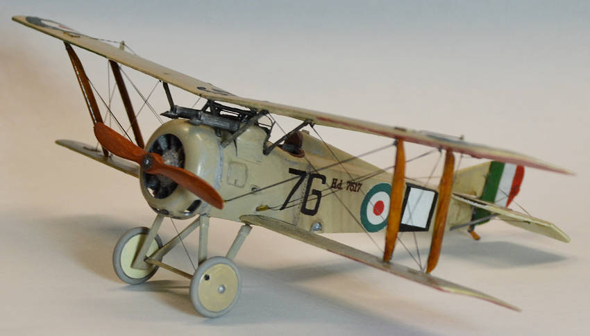

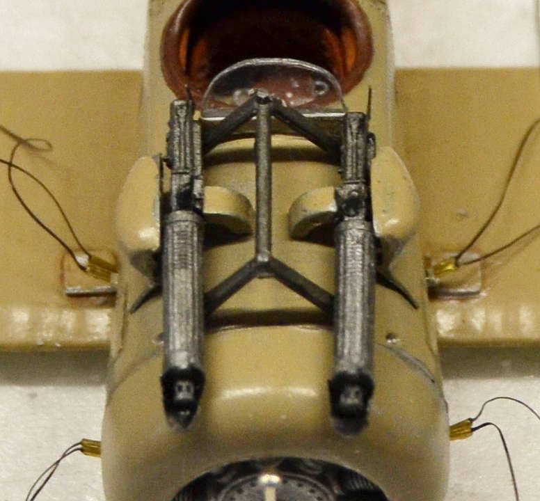

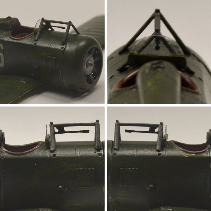

I completed the work on the three cabanes, here go the results.
COPPENS
SCARONI
MICHETTI
I made the gunsight inserting a 0,5 mm round rod into two 0,8 small chunks to simulate the enlargement et both ends.
I did not find any better photo to determine the shape of the mechanism to suspend the gunsight to the cabane so I just imagined a way to do it!
Antonio

Imagined fixing or not it looks convincing enough to me! More excellent modelling - keep it up.

Thanks Stephen, I am pretty satisfied, although in the end the gunsight looks like that of a sniper gun...

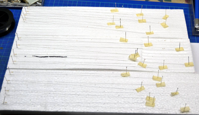

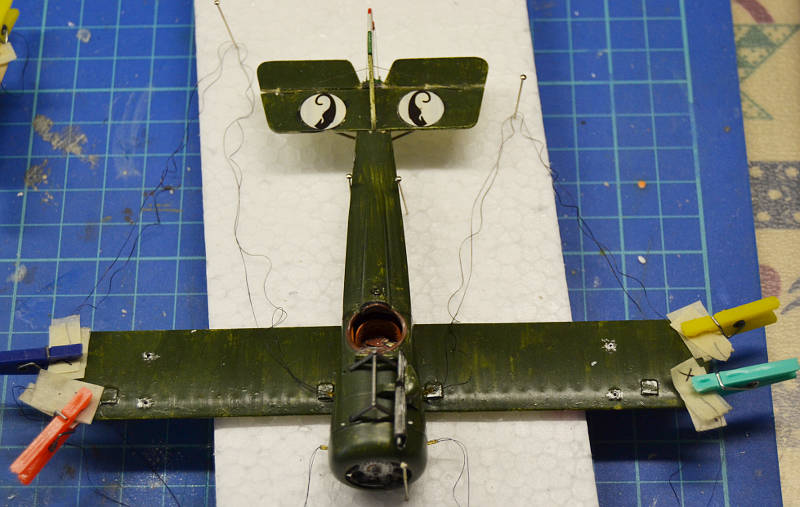

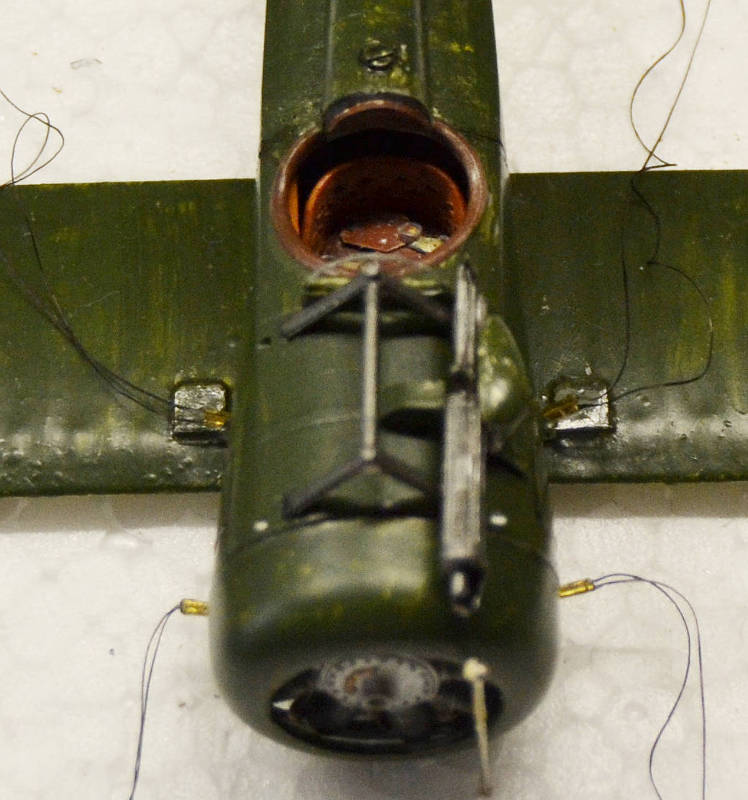

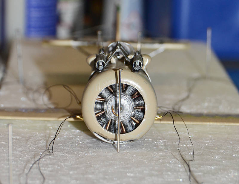

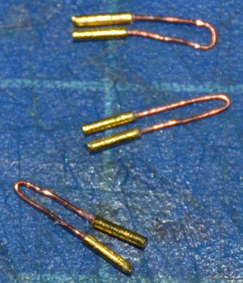

« Reply #173 on: September 10, 2016, 03:37:30 AM »

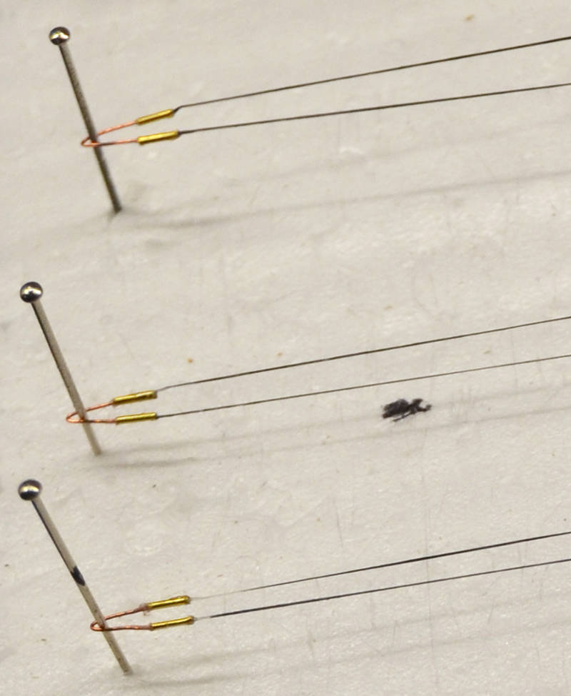

Some new works done in the previous days::
I fixed the elastic wire to the double buckles that I created in an ealier phase
Here are the 12 couples of cables
Detail view

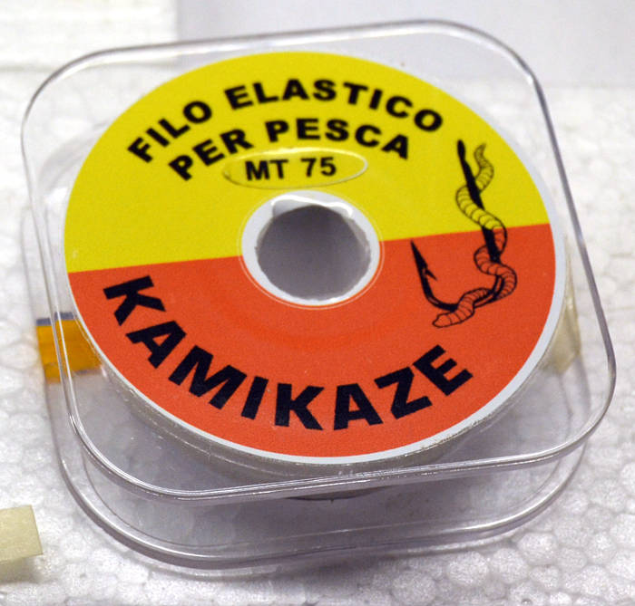

I am trying some elastic thread found in a fishing shop round the corner:
less than 3 euros and no shiping charges ...
Quality appears good enough, it is transparent but I easily coloured it with a common marker.

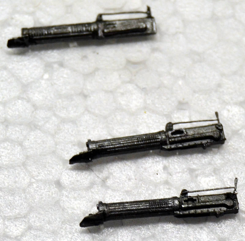

Then I made the unjam levers as shown in the photos posted just above:
Ciao and thanks for looking!!!

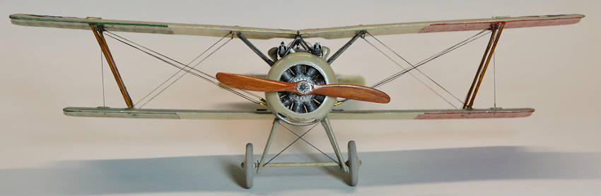

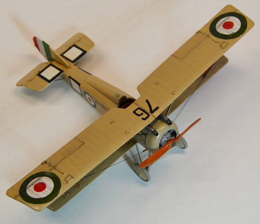

SCARONI
Scaroni was the only pilot in his squadriglia that wanted to double the arms onboard his machine, so he installed 2 Vickers..

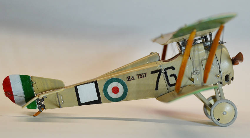

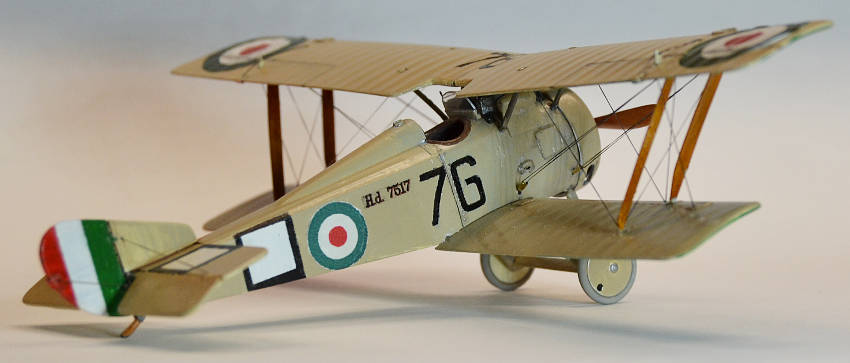

MICHETTI
Here you see the only Vickers Macchi used to mount on the Italian built HD1s

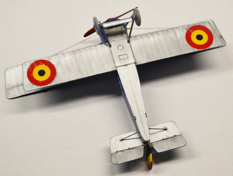

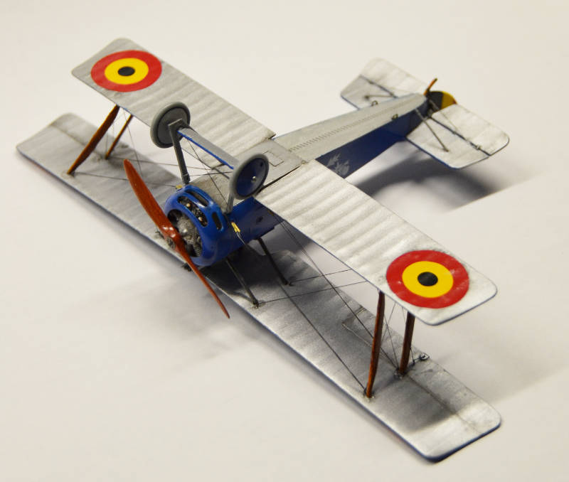

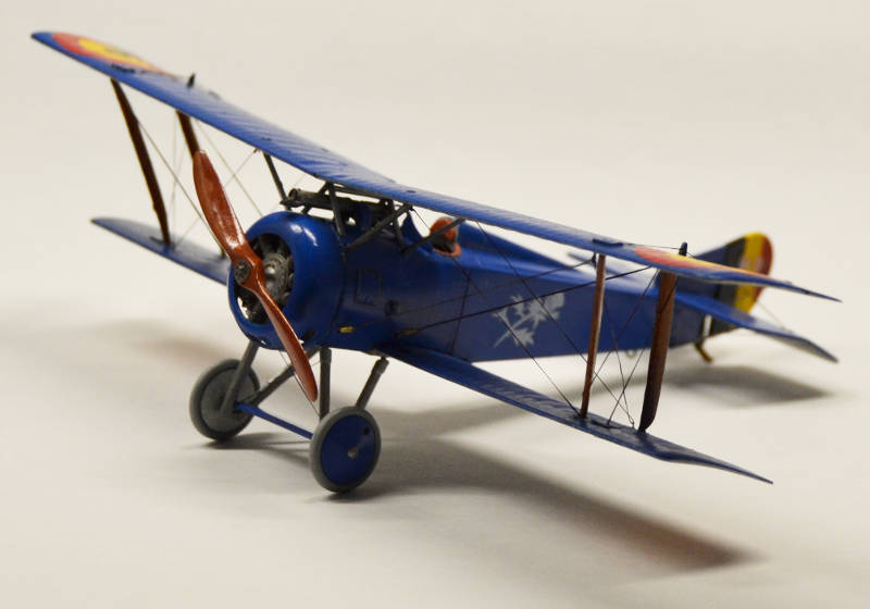

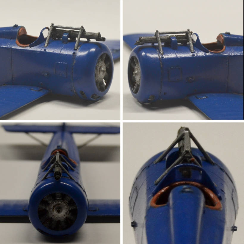

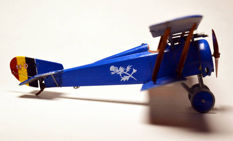

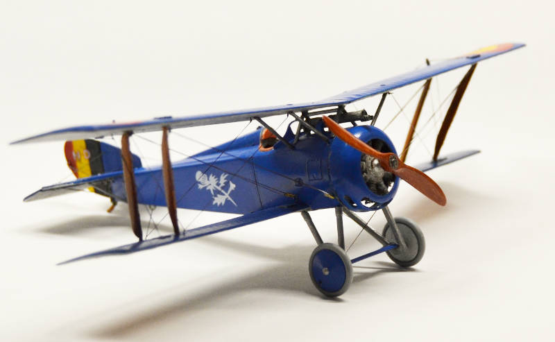

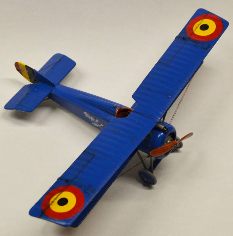

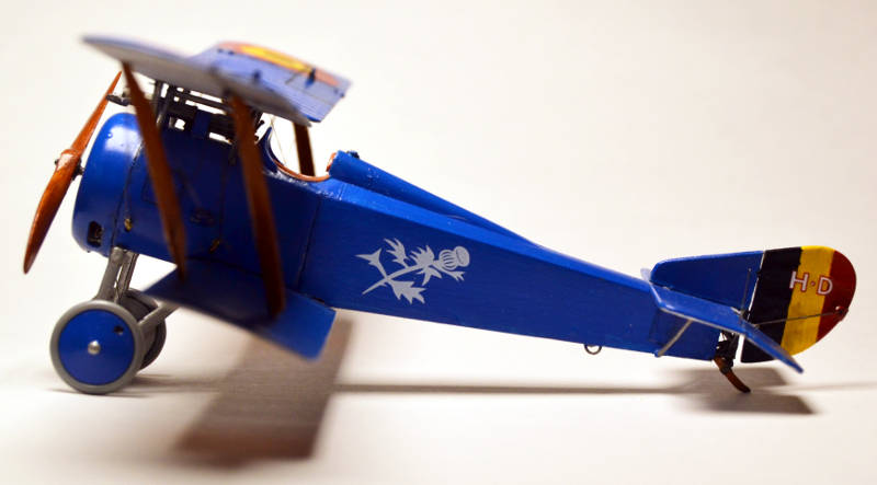

So, that's all for now on the Italians, but... what about Coppens????
Well, yesterday evening and this afternoon I succeeded in finishing the Blue Devil!!!
here are the pics:
Now Scaroni is on the operating table...
Hugs to everybody and thanks for looking!!!
AnDonio

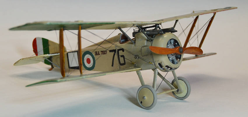

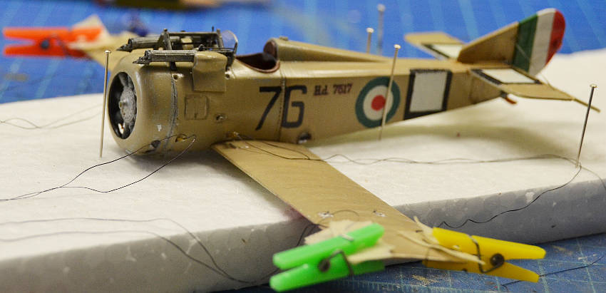

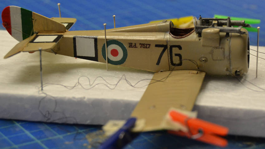

Thanks Rick!

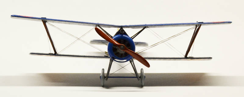

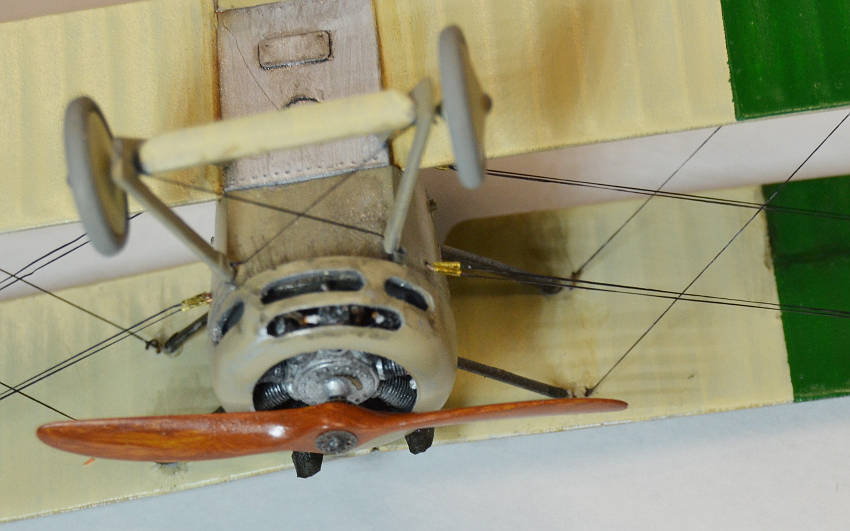

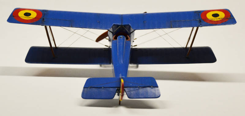

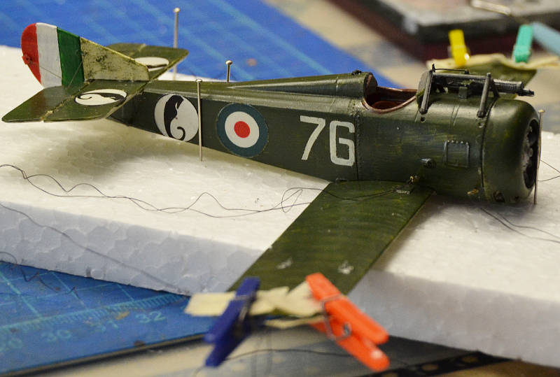

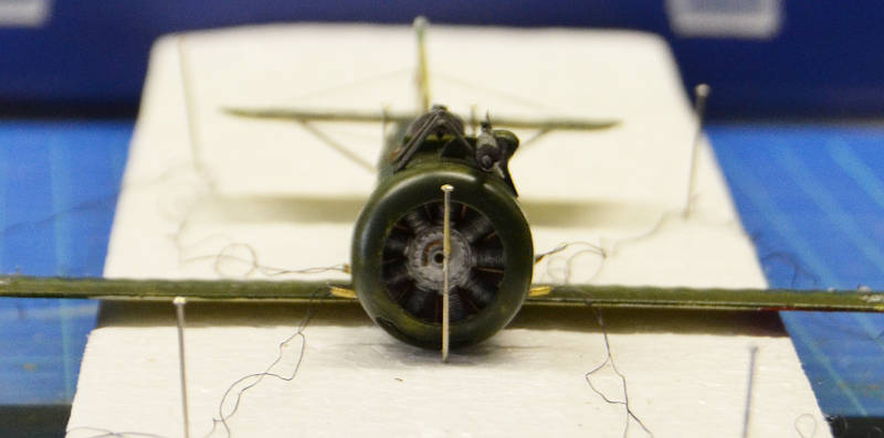

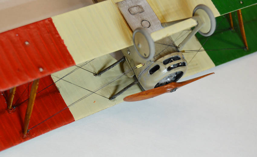

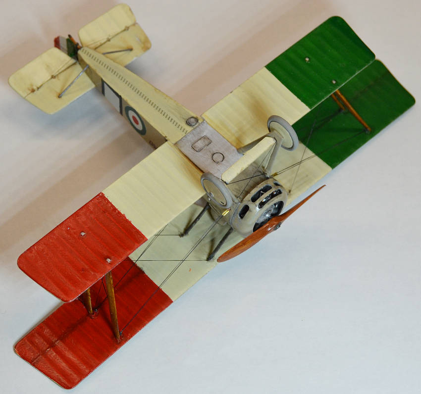

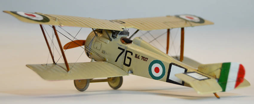

In the meantime I found a few hours to dedicate to Scaroni's plane, yesterday evening at least he took off!!!
Today I have a day off work and will concentrate on Michetti's bird to complete the trio.
Here we go with the pictures:
Following are a couple of detail photos taken to show how the double wires look.
I am not completely satisfied, I like the solution of the double turnbuckles on the fuselage end, then I put a larger eyelet on the underside of the top wing to let the two wires go through, then I let one of the wires complete its path up until the eyelet near near the cabane struts and the other one was glued and cut to the larger eyelet beneath top wing. But in the end the effect is that they do not keep parallel and converge. Next time I'll think a different solution.
Thanks for looking!
