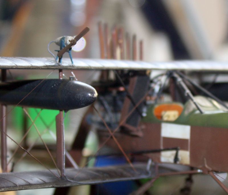

The exhaust pipes (probably a bit too long here) are made of brass diameter 1mm. It is a little thin but 1.5 mm is too big ..
Painted in brown with mig pigments.
The plastic generator:
