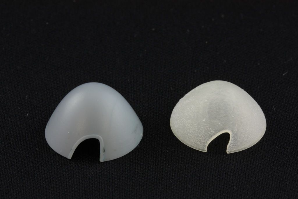

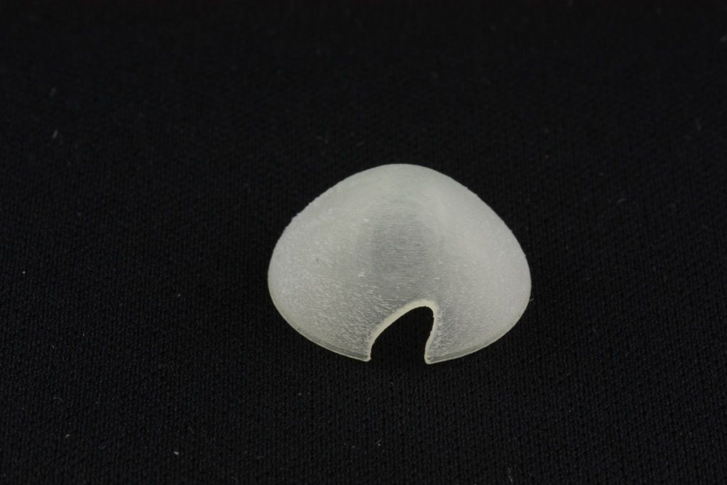

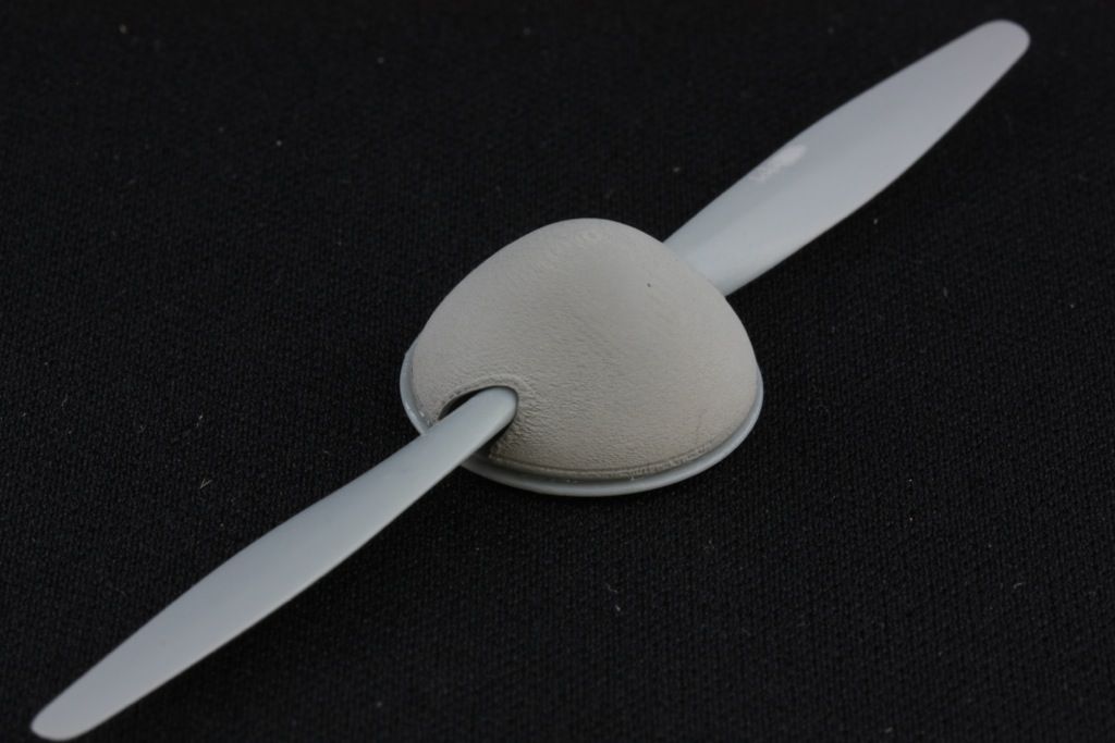

This is ready. Shown in FUD (the slightly cheaper stuff).
compared to WNW D.V/D.Va kit spinner. Is mine the right shape? I dunno. Looks better to me though. You decide :)

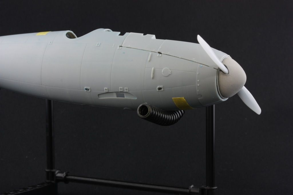

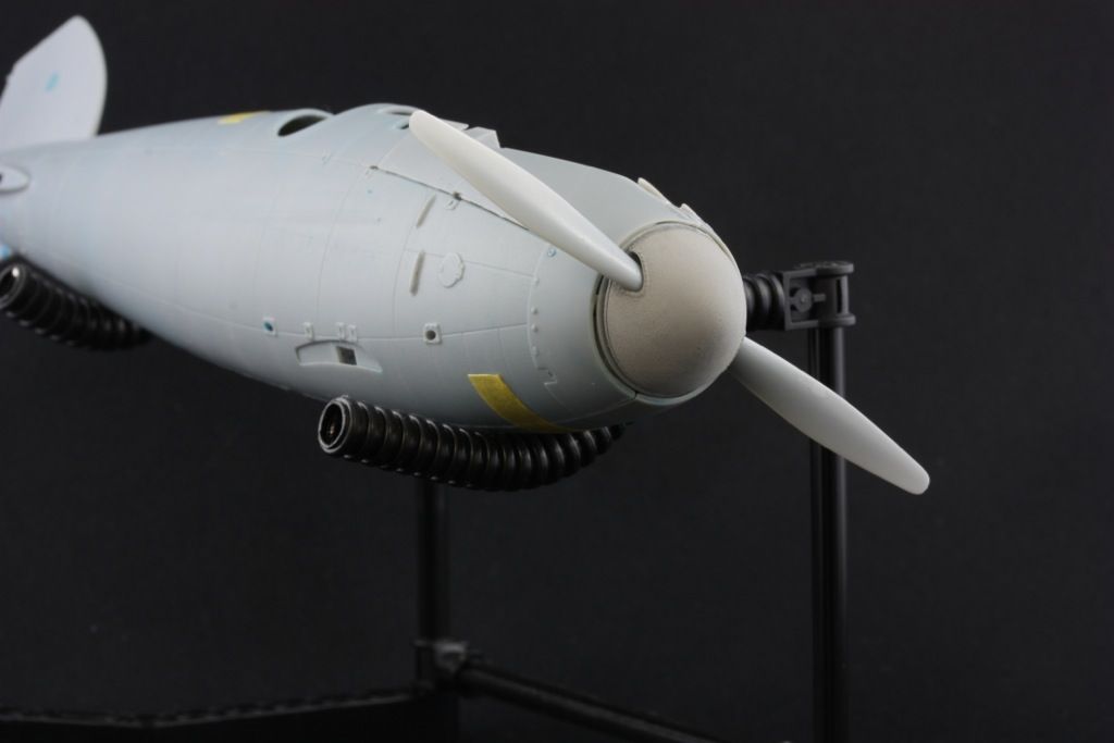

With prop and WNW kit backplate. Prep is quick and dirty for photos -- a quick coat of Sea Gray, and a perfunctory onceover with a sanding sponge.

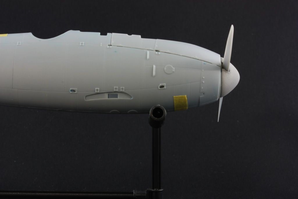

A few quick-n-dirty mockup shots:
Specially priced thru May 17: http://shpws.me/HHRV

I can't remember where I was reading it, but apparently Albatros spinners were different depending upon what prop they were going over. Once mated, the prop and spinner were then balanced together - so you might have to do a few...
Indeed they were*, and I plan on doing at least the props that I can find in WNW plastic. That's why this one is specifically marked as AXIAL. Maybe I need to make that even clearer -- other props will not fit this spinner. The openings were clearly different depending on the prop. WNW provides a(n overly) large generic opening that fits all their props. Whether the overall shape was different -- that I honestly can't work out. It is a very elusive shape, and camera parallax does not help.
*At least according to Merrill.

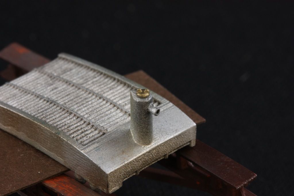

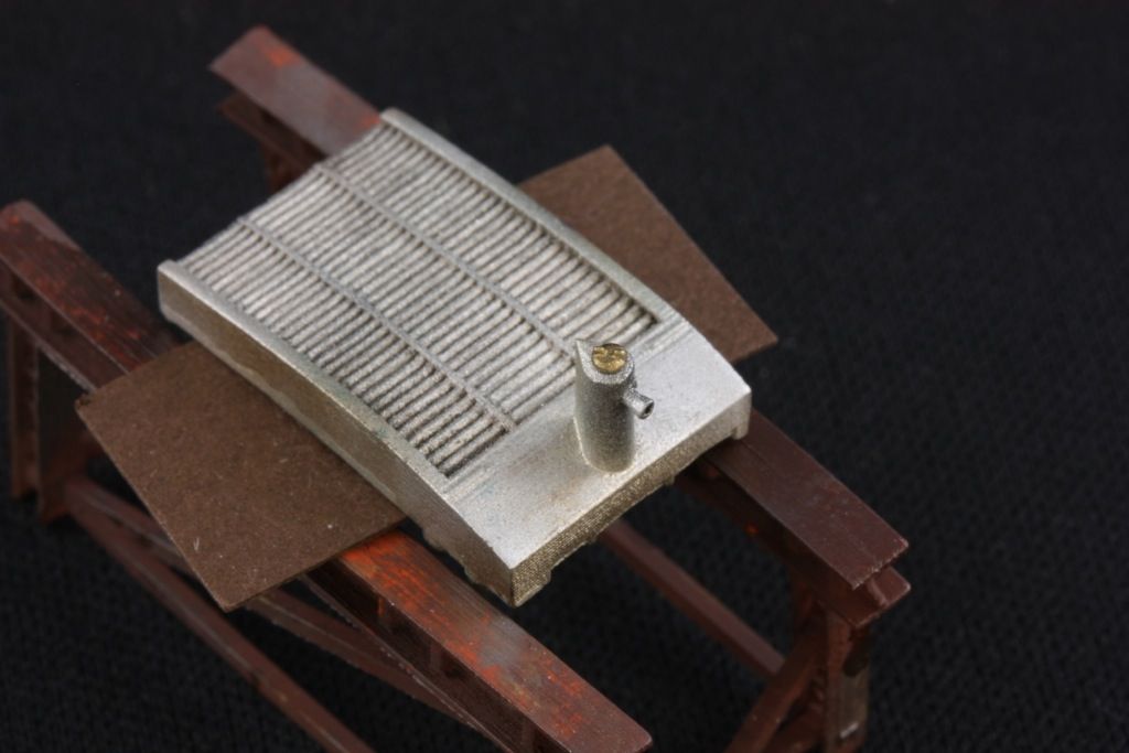

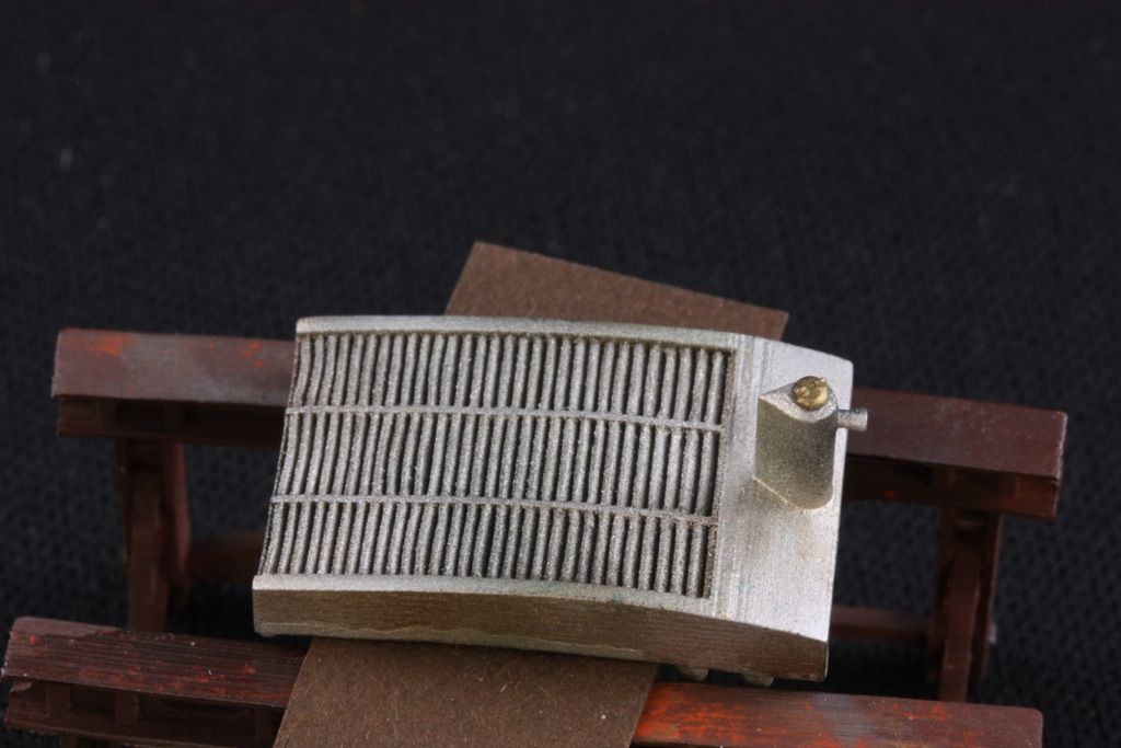

Re: 1:32 Teves & Braun Airfoil Radiator for Alb D.III/D.V/D.Va
« Reply #88 on: May 13, 2015, 10:32:09 AM »
showing air horn and filler cap installed...
Offline boggie
  • Posts: 420
« Reply #89 on: May 13, 2015, 11:30:13 AM »
Very Botiful!  ;D
