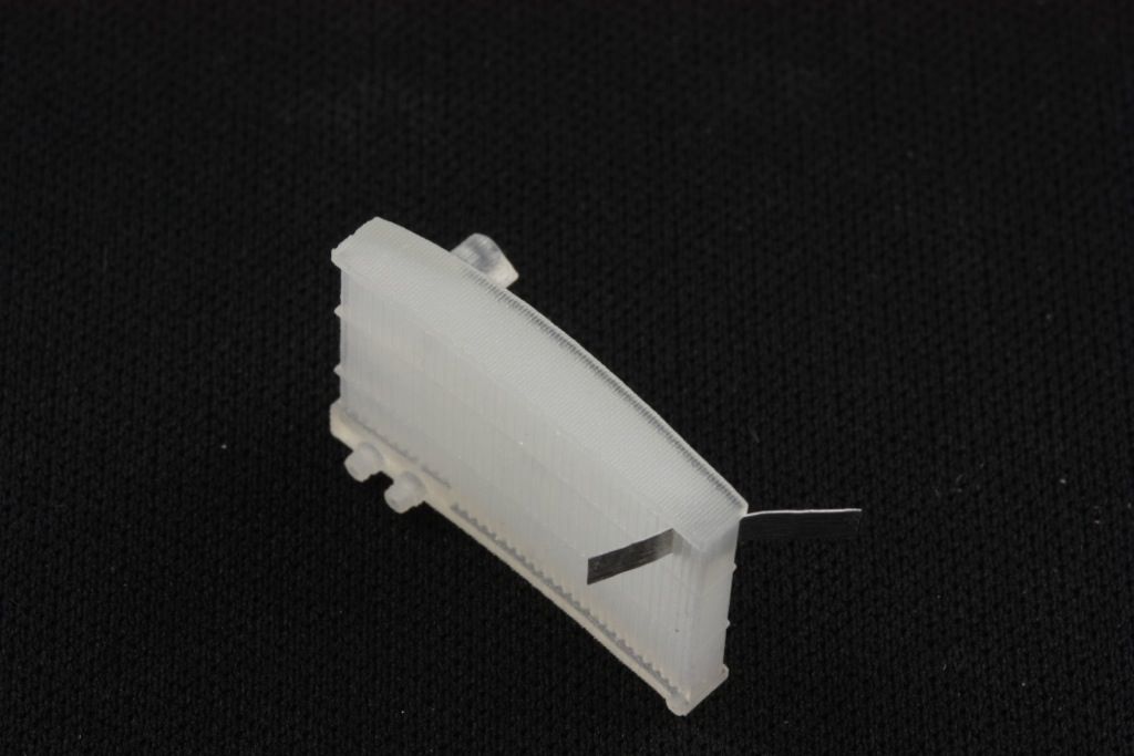

This photo shows how to use a small strip of .004" (~.12mm) thick aluminum to clean the support material from between the fins. the strip is about 2mm wide. Start from the top, back row and push between the fins at approximately 45 degrees towards the front of the radiator. it should easily push right through.
I recommend skipping the acetone bath or going very easy -- just a few seconds at most -- lest the fins start to warp. Instead try washing the part gently in lukewarm soapy water.

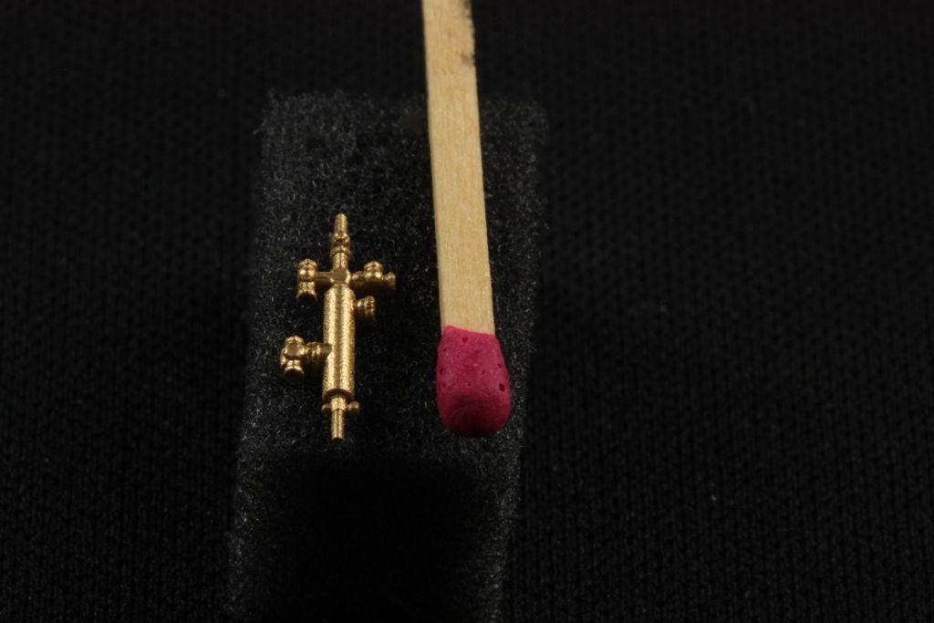

« Reply #128 on: June 07, 2015, 09:08:41 AM »
What is FXD? Is that the material they're made from?
Sorry, for the jargon -- though I think I explained this in the FAQ sticky... FXD is short for "Frosted Extreme Detail (Acrylic Plastic)"  it denotes both the material and certain technical specs. Their vendor calls the material something else, but anyway it's the exact same photopolymer as "FUD" (Frosted Ultra Detai -- the best rez stuff they had a few months ago)  and printed on the same types of machines -- the only difference is the Z resolution is higher with FXD -- only 16 microns per step vs. 29 with FUD. The X-Y resolution is the same, but it was already quite high.
A quick recap -- most 3D printing processes work by depositing layer upon layer of material one way or another, each step moving the z-axis one tiny increment...
So the Z resolution is nearly doubled with FXD over FUD, and depending on the orientation of the detail in question, the difference can be quite dramatic. For instance the T&B radiator was a total failure in FUD as many of the fins fused together.

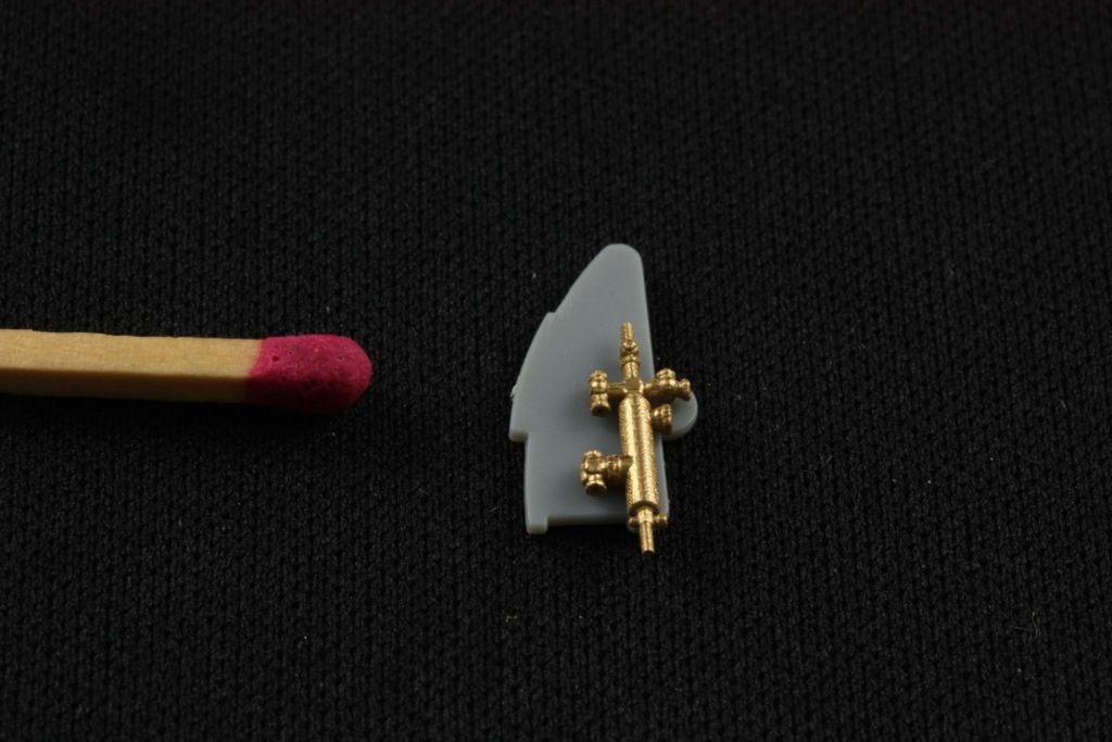

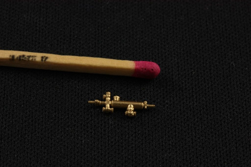

« Reply #130 on: June 08, 2015, 03:49:45 AM »
pics of a painted fuel valve...
Re: 1:32 Albatros Fuel Valves
« Reply #131 on: June 08, 2015, 08:06:25 AM »
Absolutely superb Bo.
« Reply #132 on: June 08, 2015, 11:48:23 AM »
Awesome Bo! I have to get  2 of these, one for the DIII and one for the DII. Should be close enough for Government work  ???
