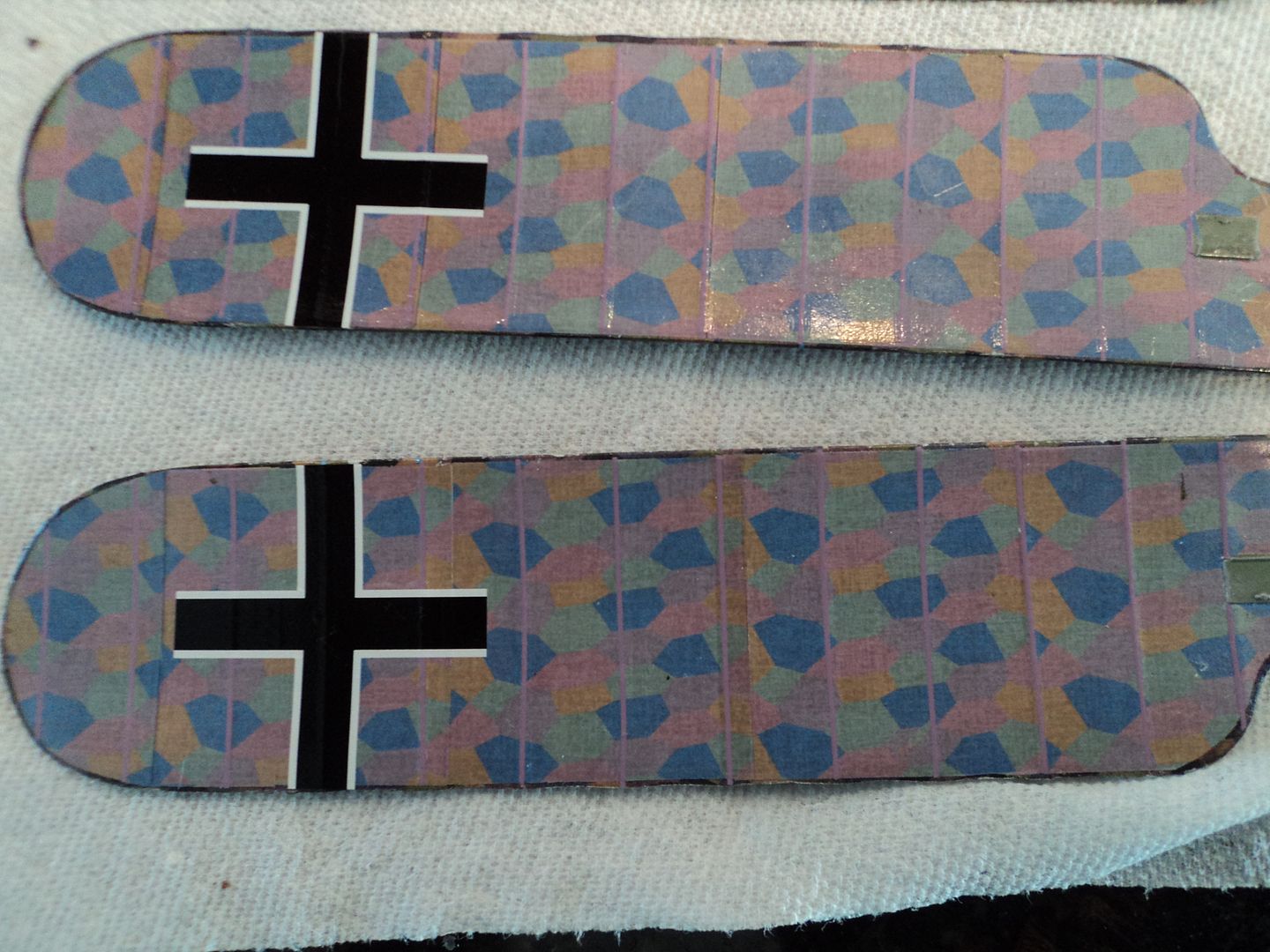

This is looking good.  I like the looks of the PC10 on the side panels and the CDL looks mighty good.  Good job Richard at Aviattic.  When applying strips of lozenge on my Pfalz and two LVG's, I applied the upper surface first.  Let the stuff wrap around without a real care as to eveness.  Just enough to cover the edge.  Then I did the underside.  I carefully measured each piece to ensure sameness and applied the underside.  This took care of the wrap around.  Much easier to do than trying to gauge the proper distance and size of the wrap.  Naturally, I experimented with paper to get the right the width.  This worked well and the application could easily be used on the PC10/CDL as well.
Here is a picture of the completed underside.  You can sort of see how the underside lozenge overlaps the upper to create an "even" underside wrap.
Hope this helps.
The WNW rotary engines look pretty darn good.  Best of luck with the Taurus engine.  I will be following along.  Hope you can get dug out too.

   I like your method, Mark however I've already got all the CDL applied to the bottom surfaces. I didn't get back to this yesterday so later today I'll be trying the thin strips of white backed PC 10, hopefully it'll work. The Kit engine is very well done but as Eindecker points out the seams on the cooling fins are a real problem. Perhaps a combination approach will produce the perfect product, and with my talents to rival Mr. Bean himself, what could possibly go wrong?!??!!? ::) :-\
