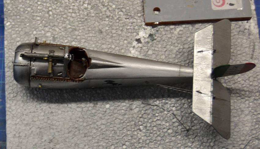

Let me show now the state of the art on my workbench yesterday night:
The result does not appear too bad, but to be honest the photos this time (due to the flash light) appear to be very benevolent and not ruthless as usual...
The color rendering on the surface showed many uneven areas that in the picture are not as evident as to the naked eye.
To mask this defect I used a heavy wheathering, but nothing of it shows in the flash light.
The nice effect I obtain is the evident difference between the metal parts (previously coated with glossy black) and the fabric ones.
I used Tamiya colors in rattle cans: TS-83 Metallic Silver, which revealed a lot of stains and uneven areas especially on the wings and tail planes (I made no picture of that horrible sight).
You can perceive some of the problems on the tail planes...
I had another small problem on the belly: inserting the tailskid in the hole the two fuselage halves opened a bit showing the junction line... It is visible although not so evident in this photo.
After taking the picture, I put some putty on it; later today, I will sand it and paint again but with a brush.
I rubbed the first coat of paint off the wings and used a different can: TS-17 Glossy Aluminum. All the preshading was useless because these canned colors appear to be totally opaque... No problem, but at the end the second coat of paint appears much better than the first, although it still shows some stains in the same place of the first coat, but in a much more acceptable quantity, like a sort of accidental weathering.

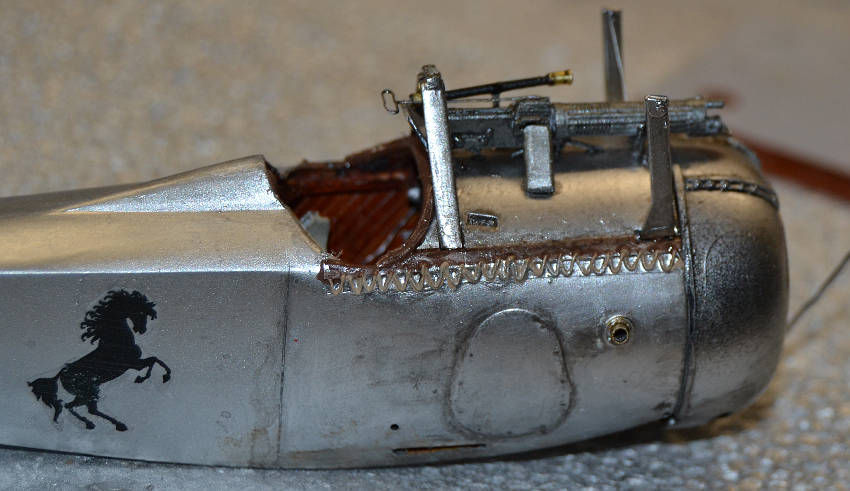

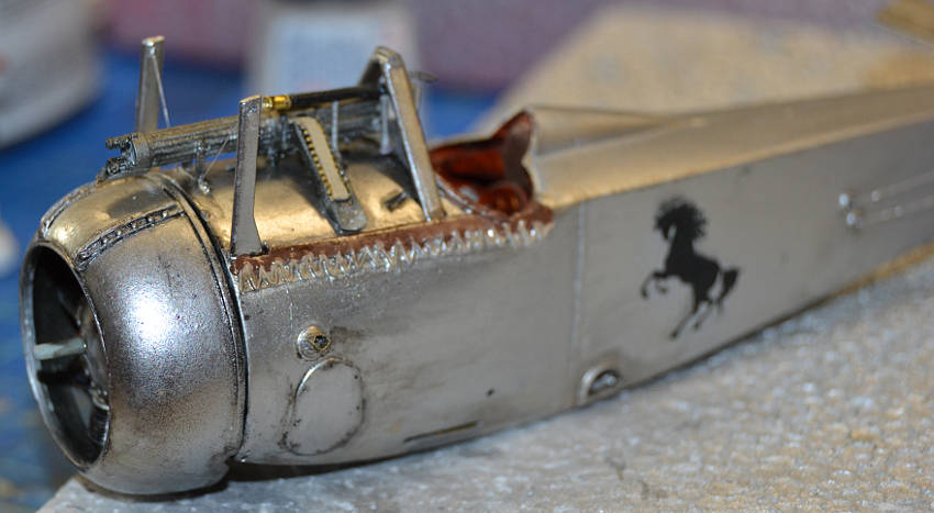

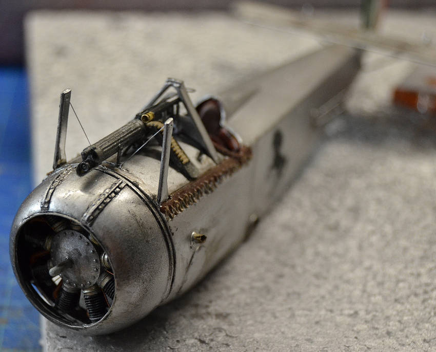

Here is a small update:
MG and Aldis in place:
the ammunition intake ramp, the Aldis pointing device and the exit ramp are made from scratch, the ammunition belt is a piece of the Gaspatch Vickers set...
here the horse is visible...
...and here as well, with its silvering halo, I still have problems with self printed decals when they are not cut precisely the transparent part is very visible due to the matt spray coat...
The Aldis appears pointing towards the sky, it slipped after glueing, but as I used the CA would be a highly risky operation to remove it from there...

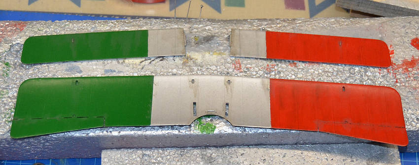

From the sky...
Tricolore and wheathering under the wings ...

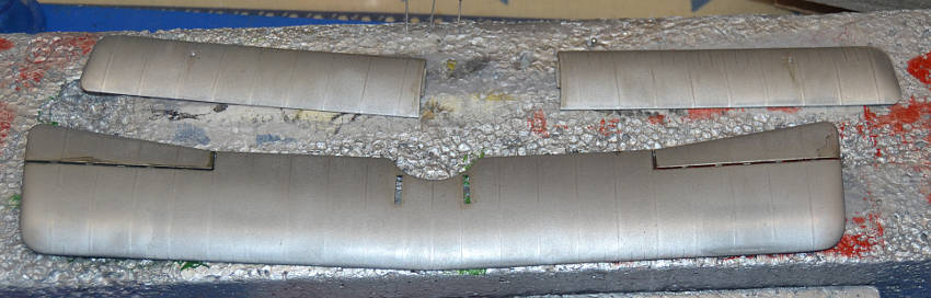

upper surfaces, the wheathering is there but the artificial light prevents from seeing it...
Yesterday I put wings and struts on and started rigging: 6 out of 8, I thope to finish everything by the end of the week...
