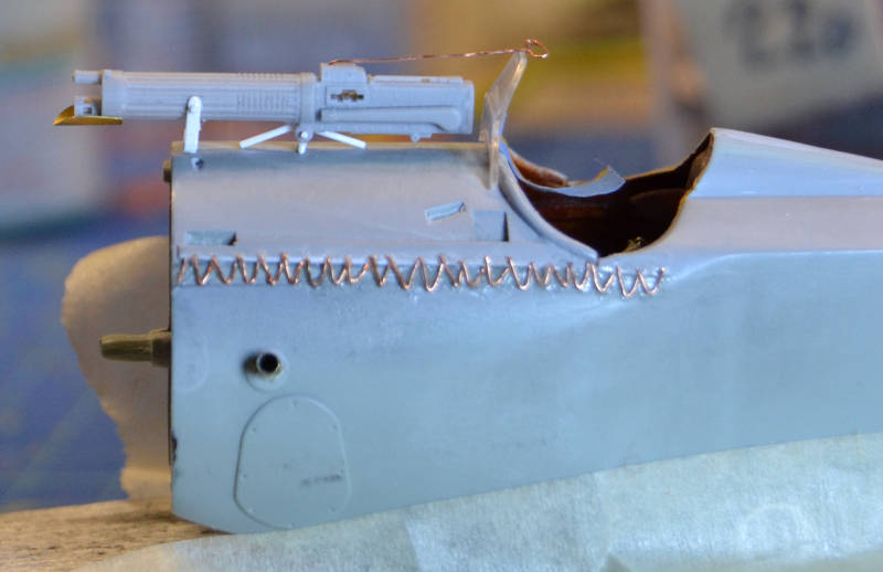

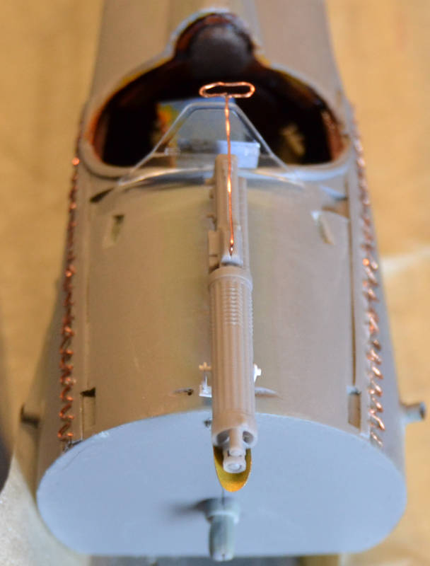

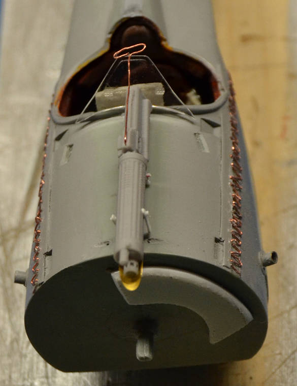

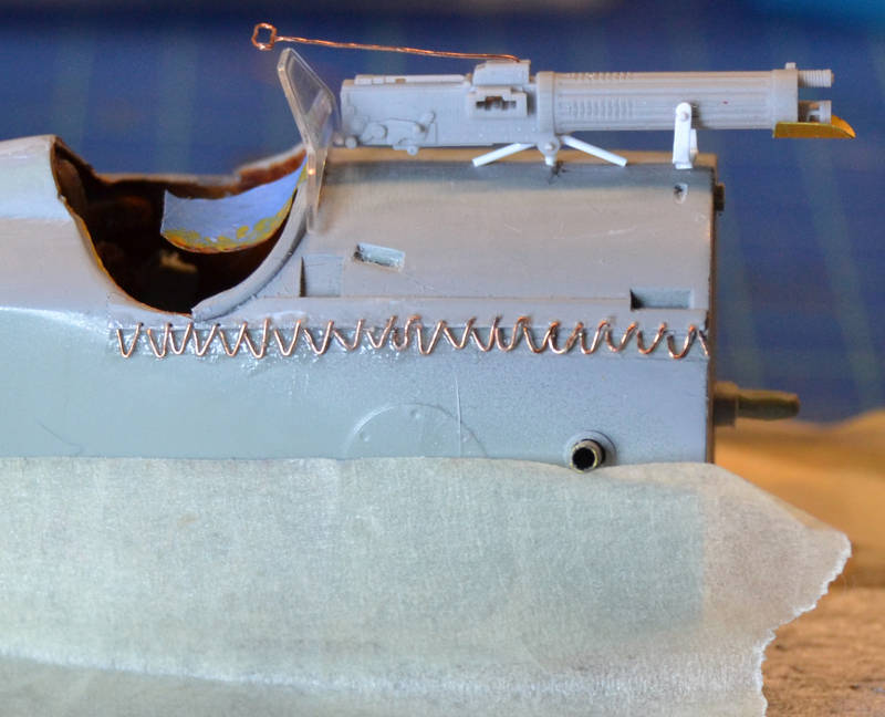

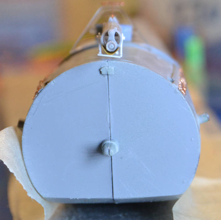

and prepared the Gaspatch MG with personal modifications.
The shield under the gun's mouth is a brass PE provided along with the 2 Vickrs kit by Gaspatch, the lever with handle was made by me with electric copper wire and the white things are plasticard added by me.
The front supporting pieces are not even in length, they have already been modified to a more acceptable and even dimension.
I understood just after completion of the piece that the small tripod was buried in the cowling so it was not visible... but I like the way I have made it and will leave it there!!
I was also mislead by observing this picture:
where the MG seems not to touch the cowling, all the other Ni17 pics I found around showed the MG laying directly on the cowling.
In the above pictures you can see also the attempt to recreate the seaming thread fixing the top cowling to the sides of the fuselage, I know, it's not a good work, also the thickness of the wire is a bit excessive... OK red mark on it but let's go ahead...

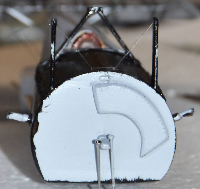

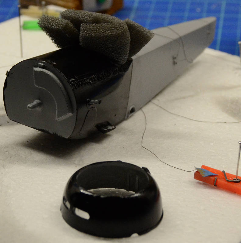

here you see the attempt to re-create the oil tank, the windshield was provisionally put in place to see the way it looked.
After I sprayed the fuselage with gray primer and painted glossy black the metal components to have a different shade of aluminum.
I will spray the model using a rattle-can of Tamiya TS 83 "Metallic Silver".

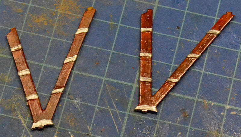

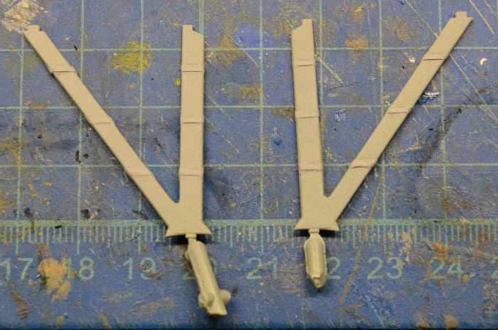

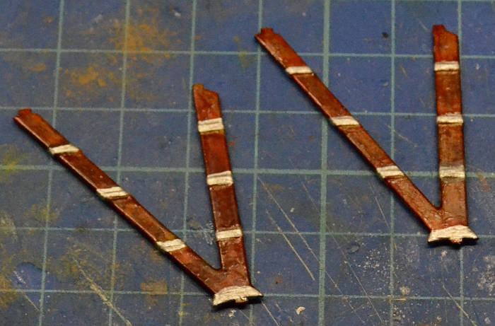

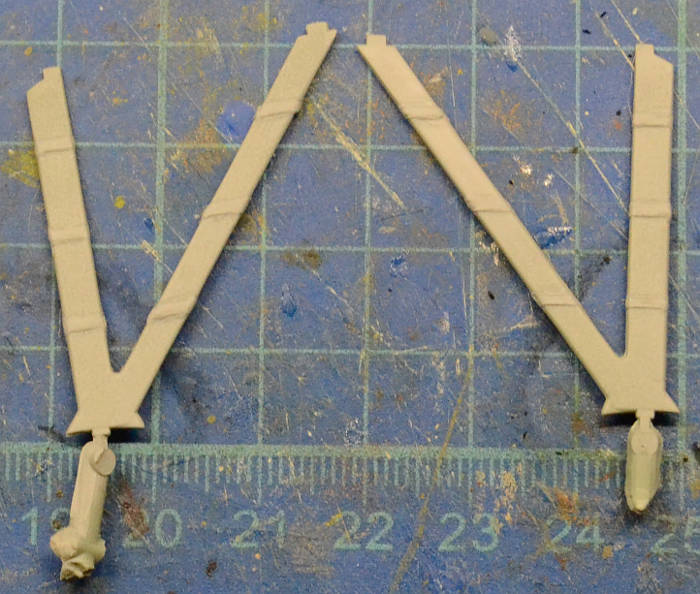

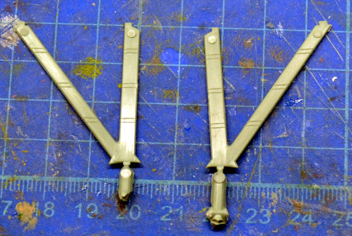

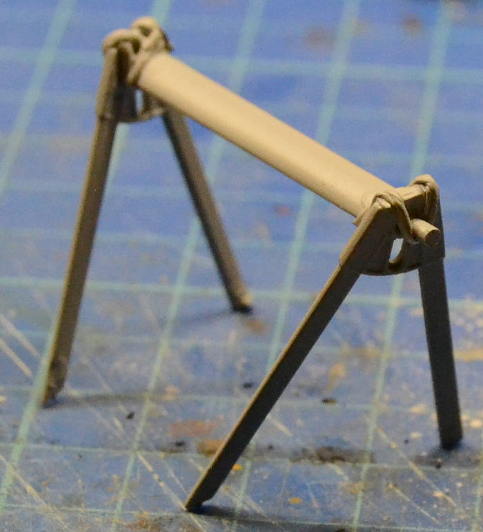

I turned my attention to the V shaped inter-wing struts: here they are: the metallic horizontal bands are just a couple of "positive" marks and the moulding marks are very thick.
So I filled the space between the positive marks with Mr.Surfacer 1000 and filed away the extractor marks:
Finally I painted them (some necessary touch up appears after magnifying...)

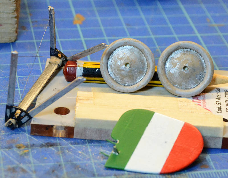

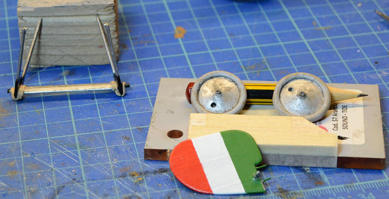

Undercarriage ready and primer-ed:
Undercarriage, wheels and fin painted:

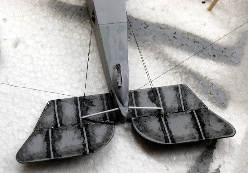

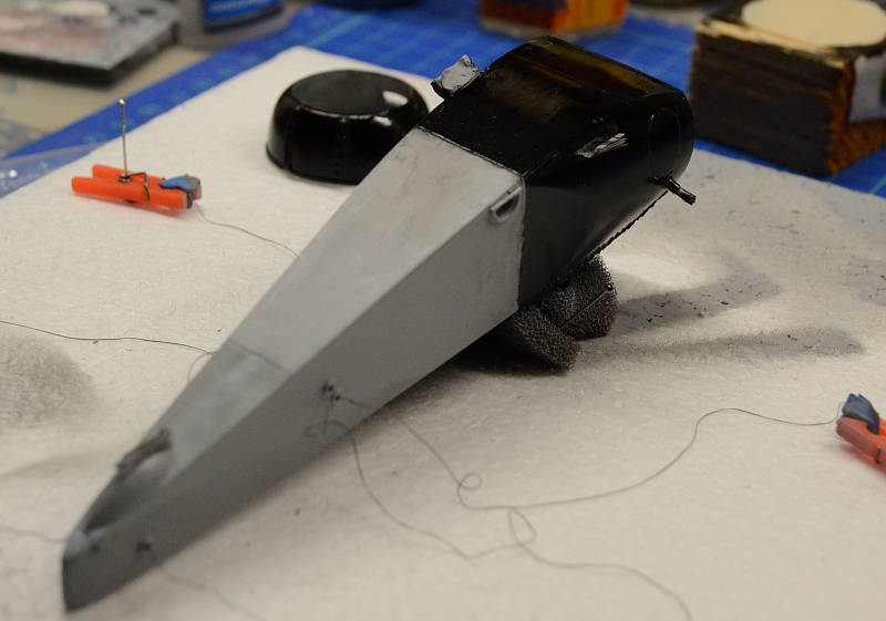

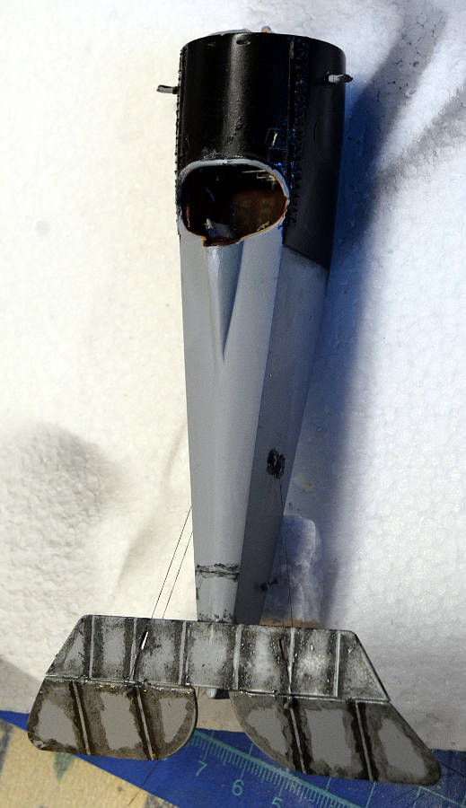

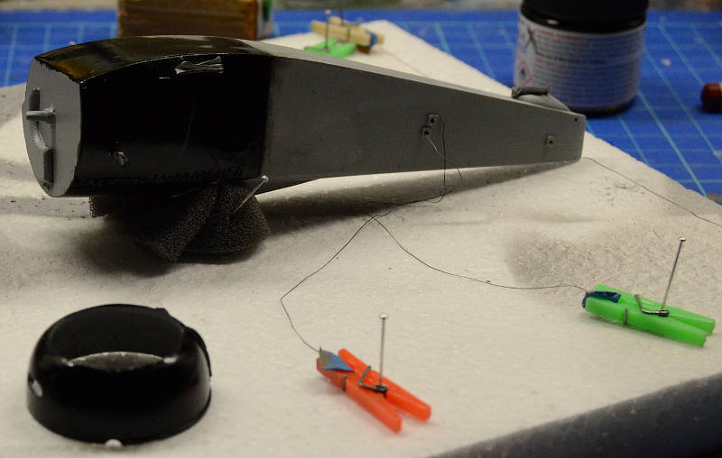

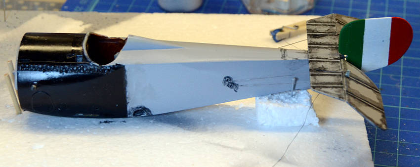

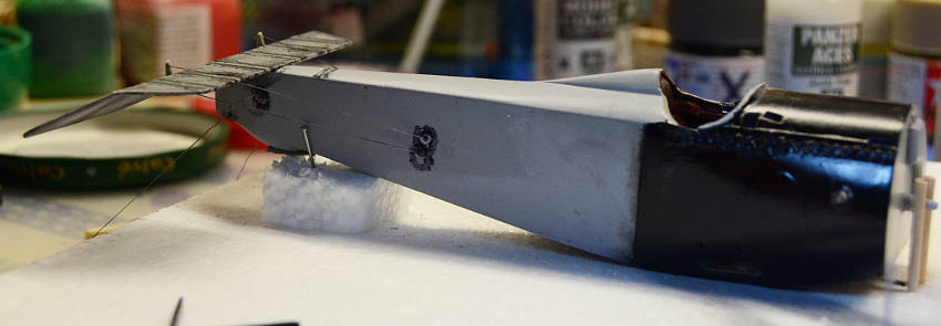

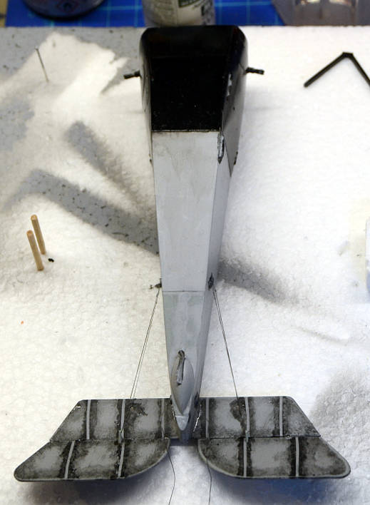

Last things done yesterday were to preshade the tail plans, glue the control horns on them, fix the assembly to the fuelage and set the rigging in place:
Here I completed the tail assembly with the small struts, I used 0.8 mm diameter plasticard rod in place of those supplied by the kit, in my opinion too thin:
Some preshading also on the rear part of the fuselage:
Dry fit test of the rudder on the model:

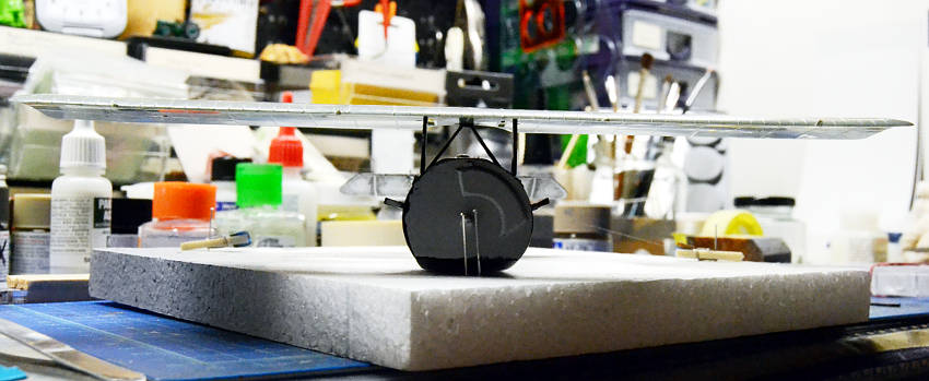

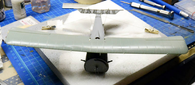

yesterday I had time to put in place the cabane struts and the rigging between the two front struts
Then I tried to position (just laying it on top of the struts) the upper wing
And it went to its place very precisely... wow
