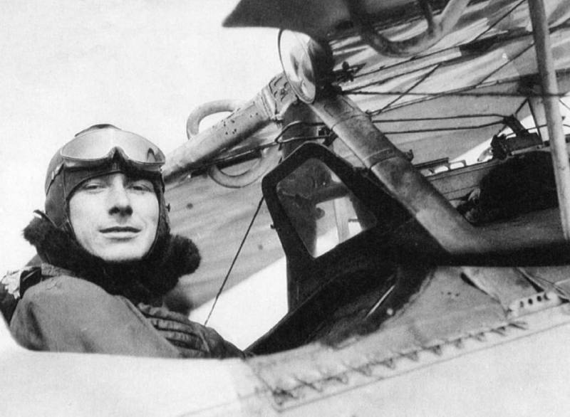

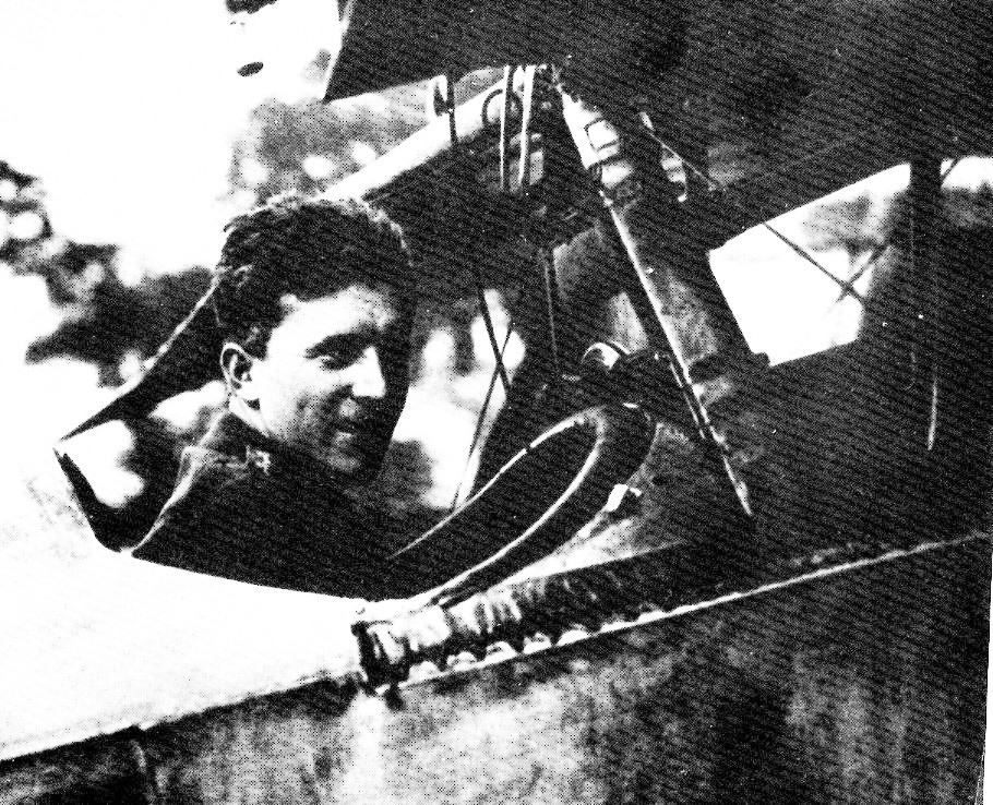

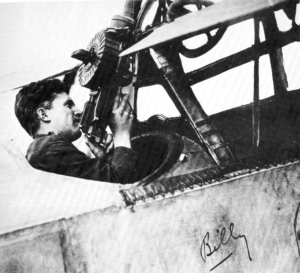

I found these three pictures:
Sgt Stephen Bigelow
Billy Bishop
So the leather belt covers the stitching. I will glue a thin plasticard belt over the stitching, leaving the lower part of the stitching visible and scribing the belts from behind so that they appear covering the rope.
Also the picture of Baracca's plane a few post above shows this ...
