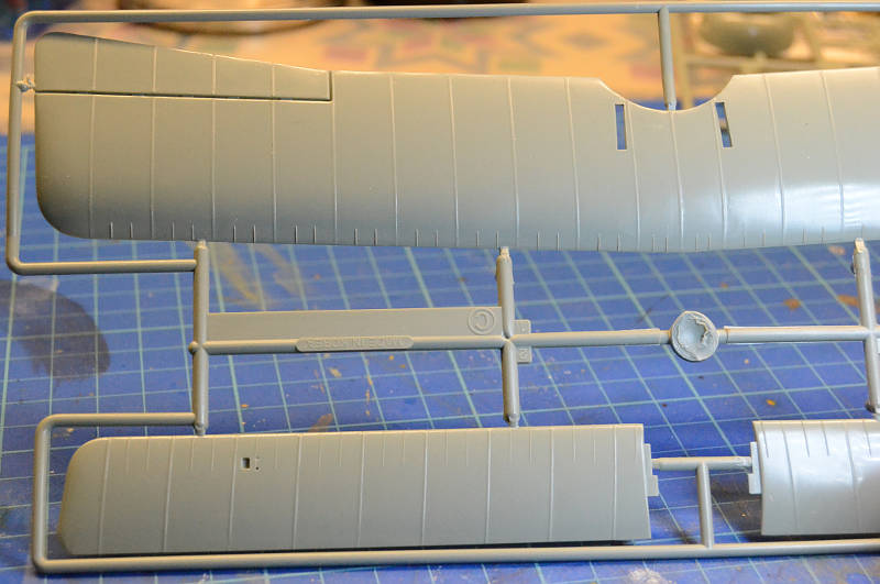

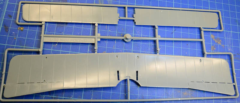

About the sprues: these are the wings, the shape seem s correct enough (to be sure I was searching for 1/32 plans but was not able to find them).
The ribs are simulated with a thin "positive" stripe, they don't either look as a rib tape or shape the wing canvas,
Any suggestion for improvements?
I think I should sand them off... but how to replace them?

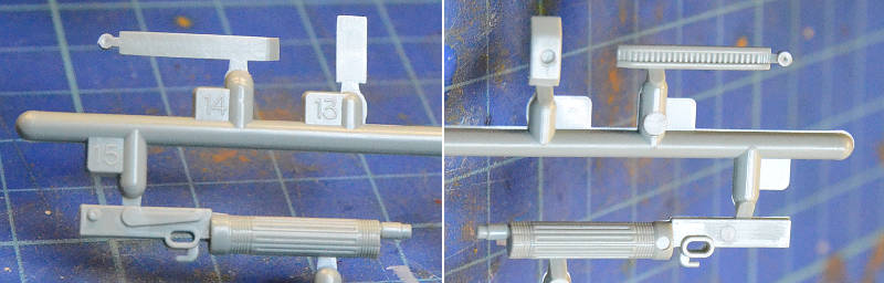

The Vickers mg is not  acceptable, I was thinking to buy the Gaspatch one.
In this Macchi built / Nieuport 17 the Vickers is clearly seen.

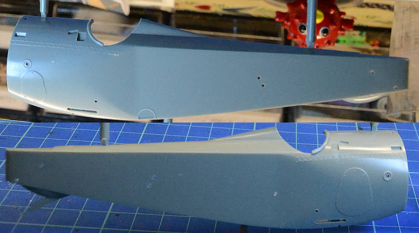

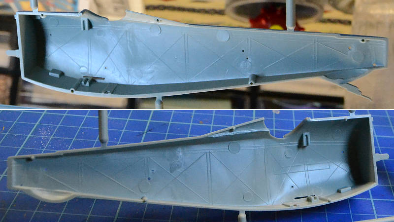

These are the fuselage halves, good looking on the outside clean and crisp detail...
... but on the inside they cast those horrible strut traces and fake rigging... WHY????
And what about the injection marks???
Everything should come off completely.

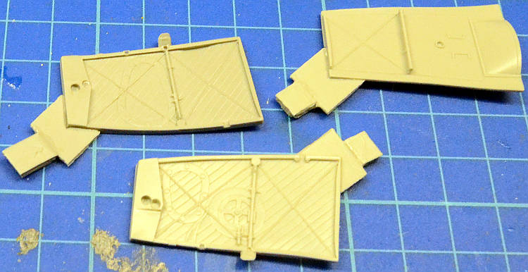

When I bought the kit I also bought the Mastercaster improvement kit, but as far as the cockpit walls are concerned also here they casted the rigging in the piece.
Apart from the cockpit sides and floor the set has a lot of great pieces that we'll see during the work here are the wheels

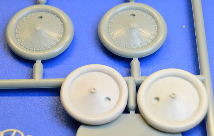

the wheels were shaped flattened to simulate the weight, but I don't like this so I will sand the tyres and try to make them even...

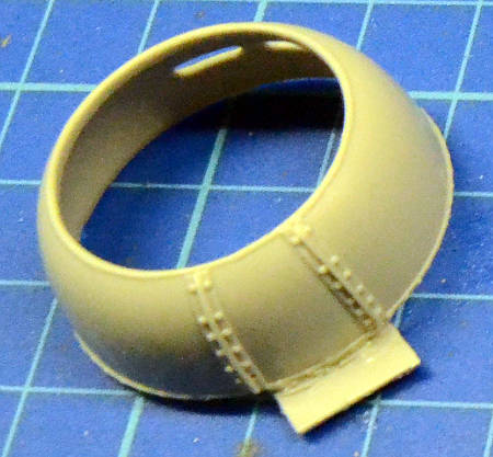

...and the cowling

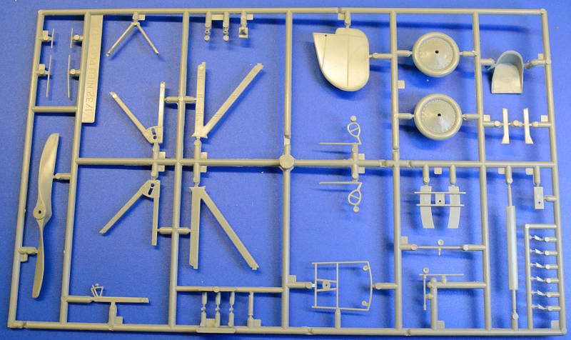

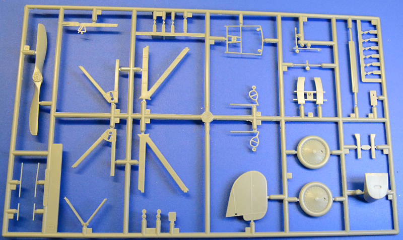

The other sprue (front and back):

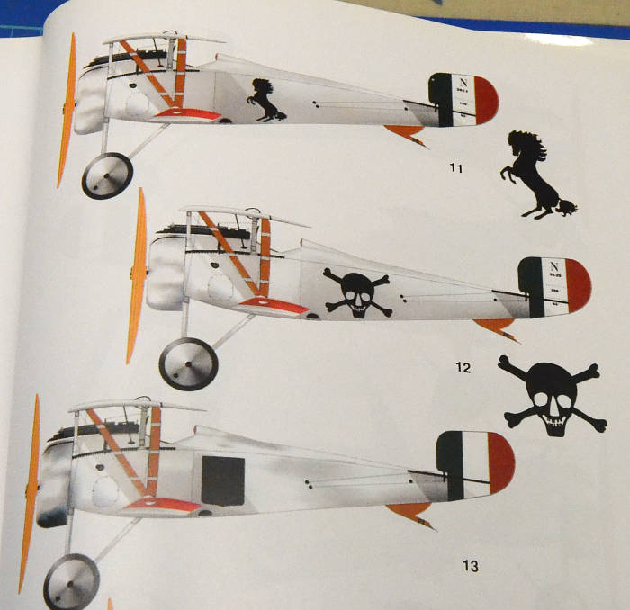

The documentation I have so far:
The profile, very easy...
At the moment I am working on a vector drawing of the horse.
The stencils on the rudder will be homemade as well:

I'd sand down the ribs and use the kit engine.

I think I will erase completely the interiors and use some of the Mastercaster pieces, not the cockpit panels.

I also agree in sanding off the "ribs" I shouls invent something to create them back after...

Yes it's dull indeed, I was thinking to sand them off not completely and try some shading to give the surface a bit more of "life".

I too have built this kit and like Gary, just sanded down the 'ribs' a bit.  As he said, once painted and a little shading, they look alright.  I too bought the Master Caster kit and have yet to use it.  Like Gary, it is just as easy to sand off the fake stuff on the interior, put a few sticks of plastic, rig and away you go.  Some of the Master Caster stuff is useful, but not having used it will withhold judgement.

The cockpit walls of the Master Caster package are very well sculpted but they have those inset wires I can't stand. Maybe I'll try to extract some details from them and re use...
Other pieces I have in my box also from that package are very nice and perhaps I will use them...

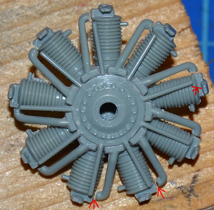

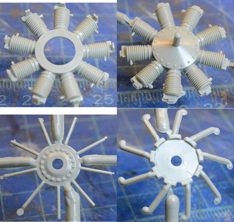

First of all I tried to pre-assemble the engine which - as said - is good enough, ...but
as you can see the exhaust tubes don't touch the heads of the cylinders, although most of the cylinder heads will be hidden by the cowling, from below some of the lower cylinders will be seen.
So I think I should operate on this.
Same problem can be seen for the rods departing from the centre towards the valves on top of the cylinders. They don't touch the cylinder, moreover they are too thick...
This is an example of the rear side of the engine.
I am considering to put tiny round slices of plasticard where needed to join the exhaust tunes to the cylinder head and replace the valve levers (I don't know their exact name) with thinner metal rods.
For the time being I put aside the engine working on other details.

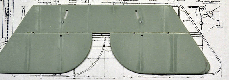

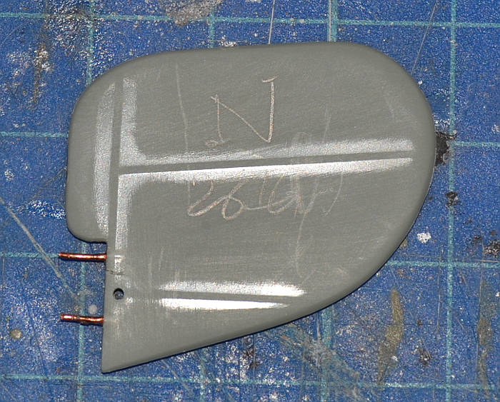

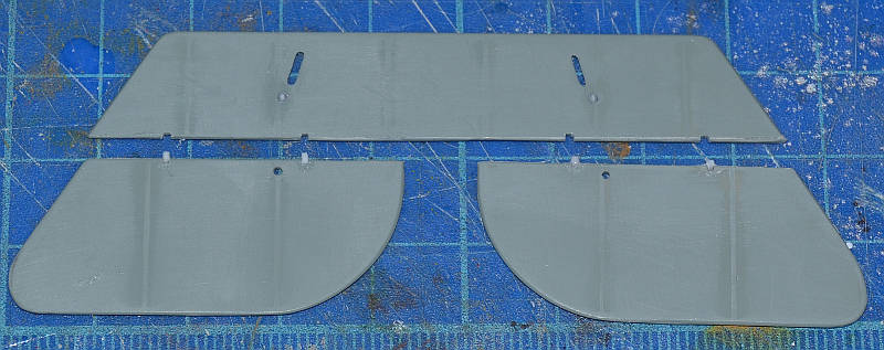

Here is the tail surfaces, I matched them to some technical plans I found on finemodelworks.com, really big and well detailed, I reduced them to a scale very close to 1/32.
The shape of the aileron tips was too pointed, I know it's not an important detail, but the transformation was so easy I decided to go.
Then I sanded the ribs, cut away the ailerons, put some plasticard bits to simulate the hinges
Same work done on the rudder ribs, moreover I added a couple of pins to fix it to the fuselage being able to displace it to a side.
The stencil on the port side will show the complete S/N + weight and fuel indication, on the starboard side there will be only the 2614 code

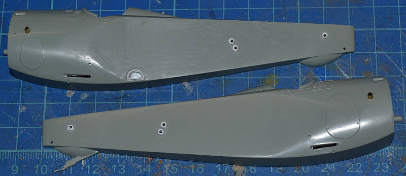

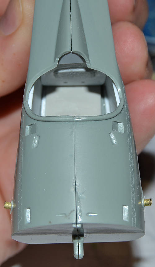

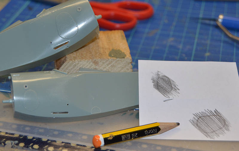

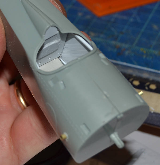

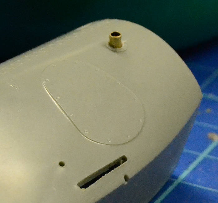

Then I started working on the fuselage:

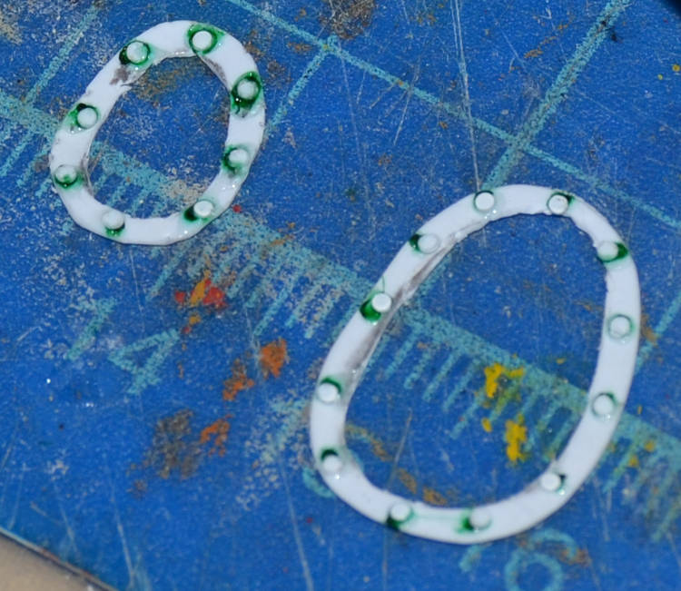

I traced (using a well known primary school method!) the two openings in the forward part of the cockpit (to be glued inside)
to replicate their shape which I decorated with nuts, I made them big hoping they will be visible after closing the fuselage.

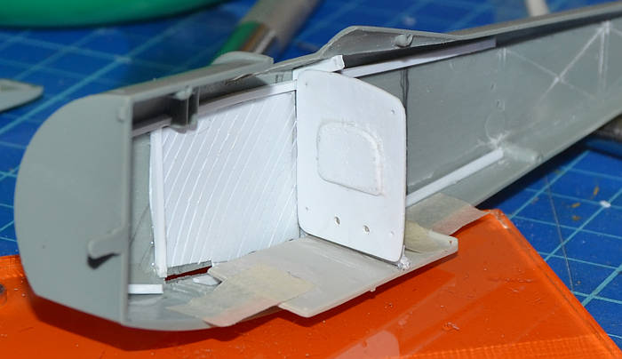

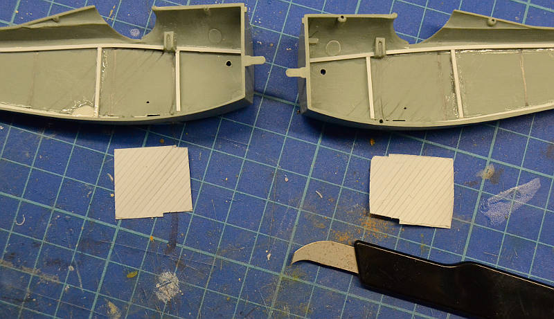

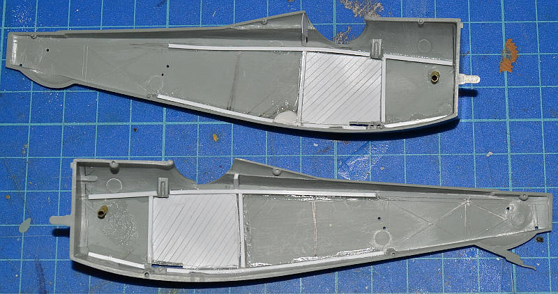

Stepping forward to the inside of the fuselage: I got rid of the horrible internal rigging cast into the plastic and, not being able to make a perfectly shaped cage, I decided to stick the woodwork to the sides.
I glued square rods of plasticard to the walls but before gluing them I pierced the vertical ones on top and bottom to let the rigging go through.
The cockpit part that goes from the seat back to the engine firewall was made of metal and as the Mastercaster set states it was covered with diagonal wooden planking. I remember I had seen somewhere on the web an old photo where
this structure was visible but am not able to find it anymore, in any case as I like this feature I decided to replicate it inside my model scribing some pieces of plasticard.
Some modellers (much better than me interpreted the diagonal pattern covering also the forward part of the cockpit but I thought it would be scarcely visible also because there will ba a lot of things there filling the available space,
so I decided to stay just with one panel per side:

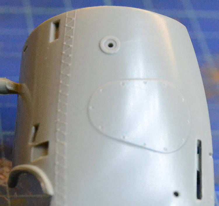

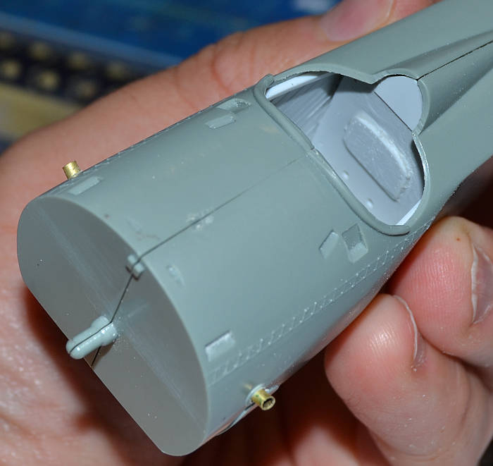

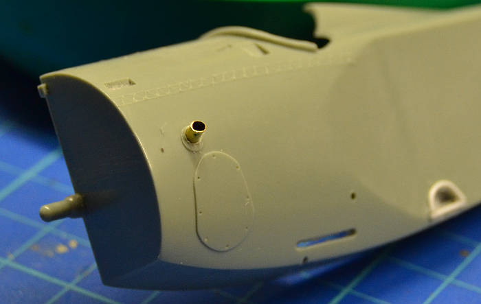

Some minor details on the fuselage outside:

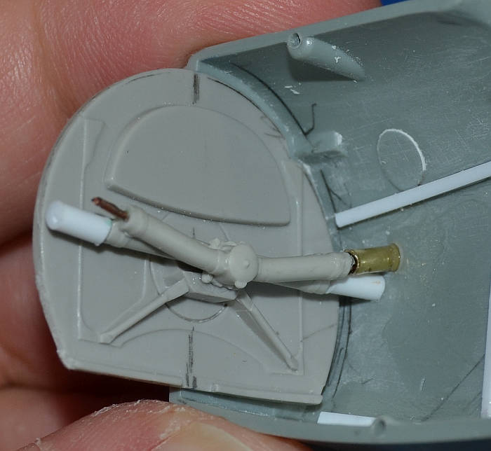

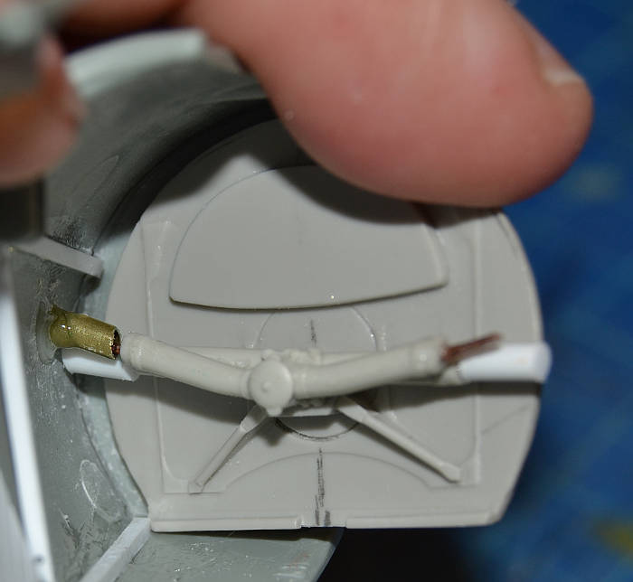

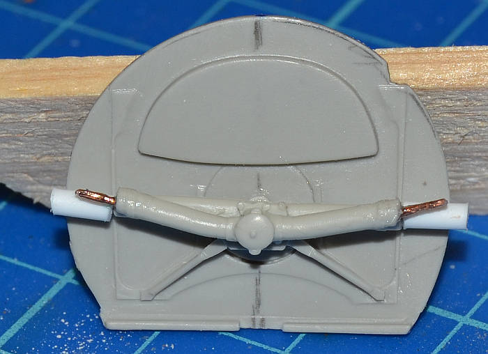

I used a .8 mm diameter brass tube to replicate the exhaust on both the sides
letting them pass through inside, where the brass tubes will join the inner front assembly as shown in the 2 pictures following:
Maybe this will not be seen from the cockpit hole but in some way helped placing the round piece I took from the MasterCaster set
Here you can see the copper pins I put into the exhaust tubes and the white plasticard I put to let the support tube touch both the cockpit sides.

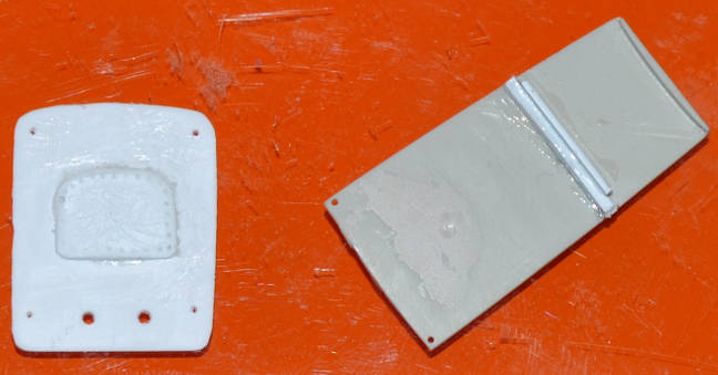

Here you can see on the left the piece that will close the space behind the pilot (the small holes are for the rigging and the big holes to let cables run towards the tail control surfaces.
On the right the floor piece I took from the MasterCaster set: I sanded it off, put a bigger rod to hold the plank behind the seat and made some tiny holes for rigging.
Here is a first try to set the cockpit structure, maybe the top corners should be further rounded to leave room for the headres piece that should be glued against the white plasticard piece
Here I tried to dry-close the fuselage, and the result is satisfying althugh not yet finished.
