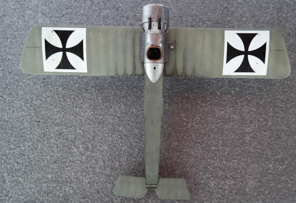

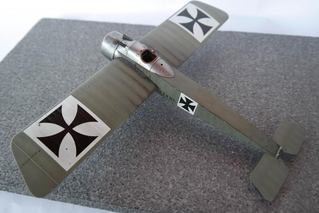

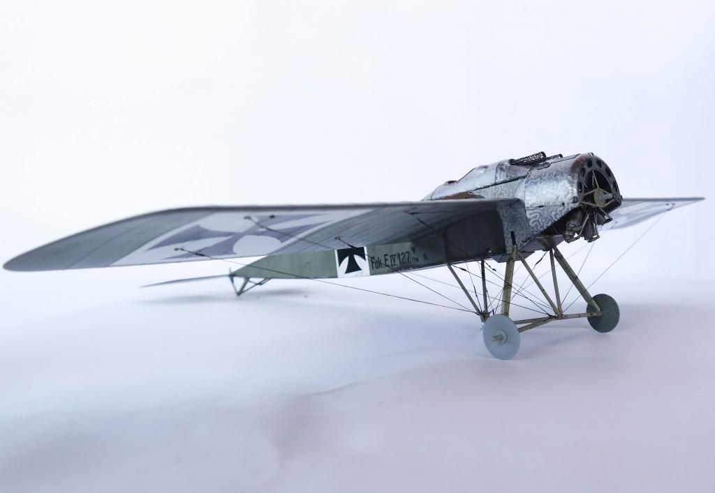

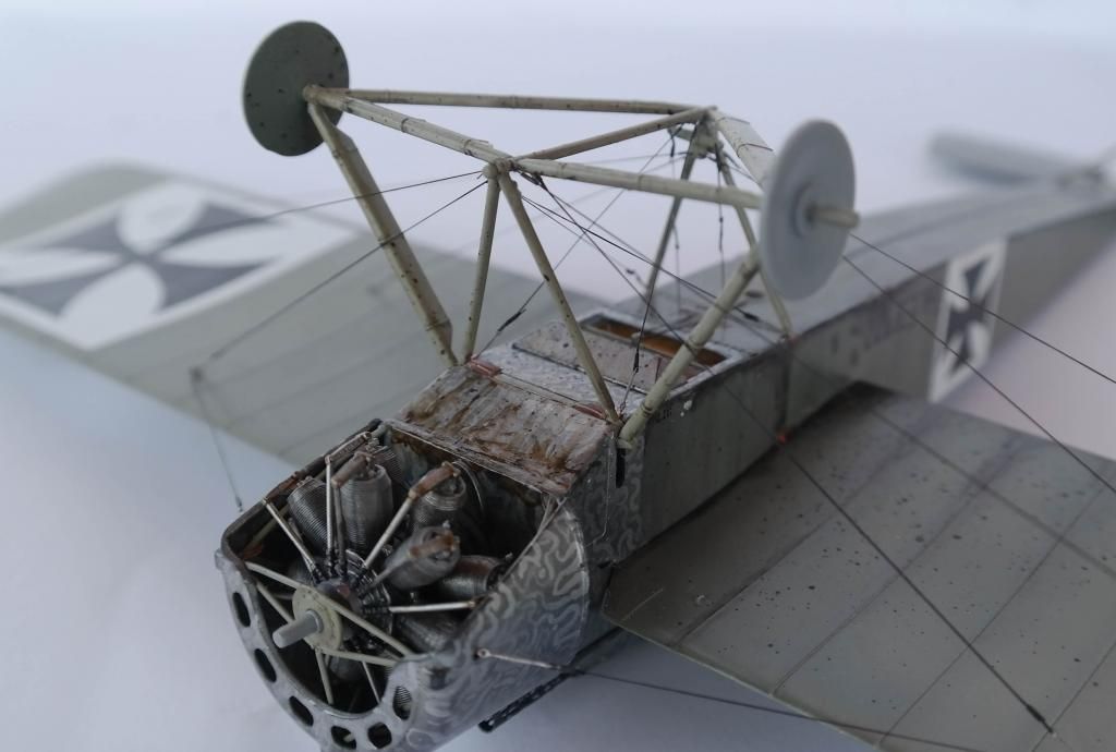

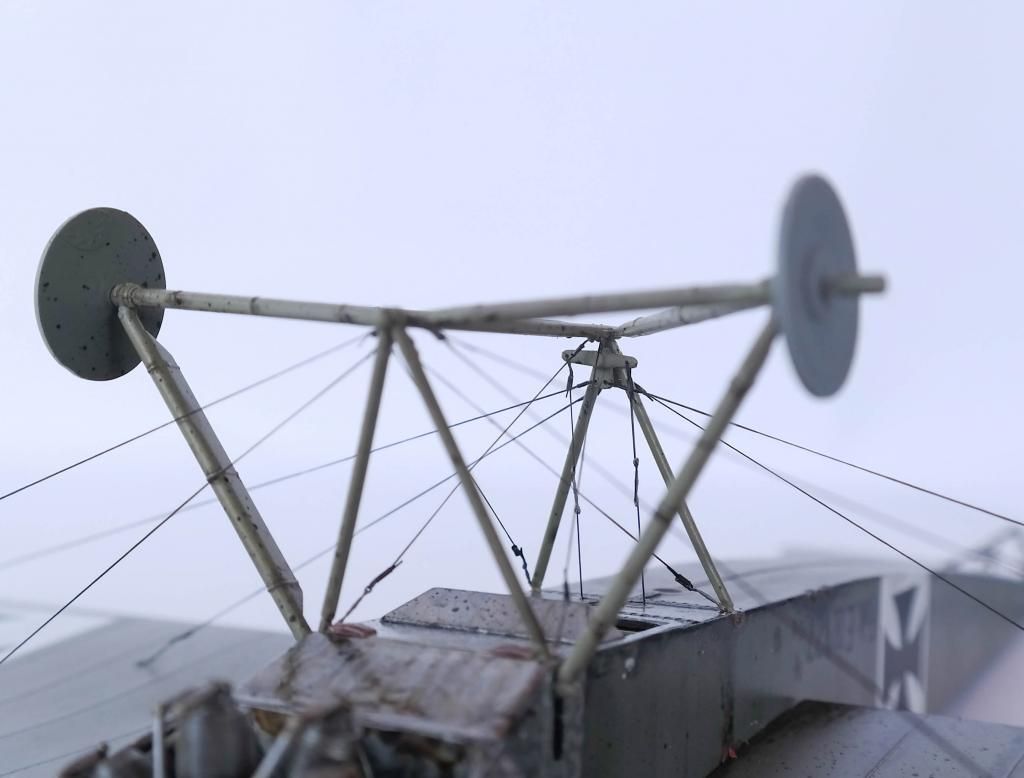

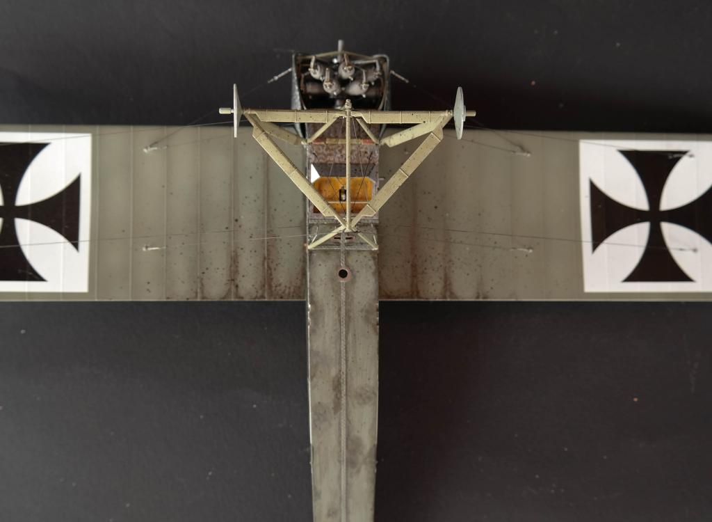

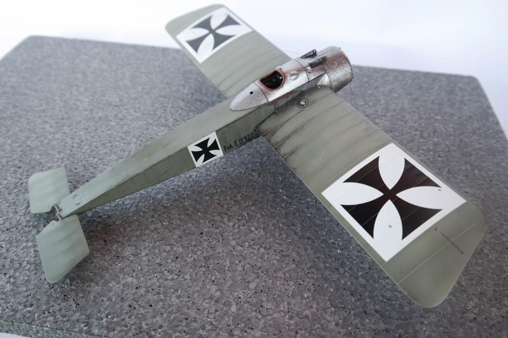

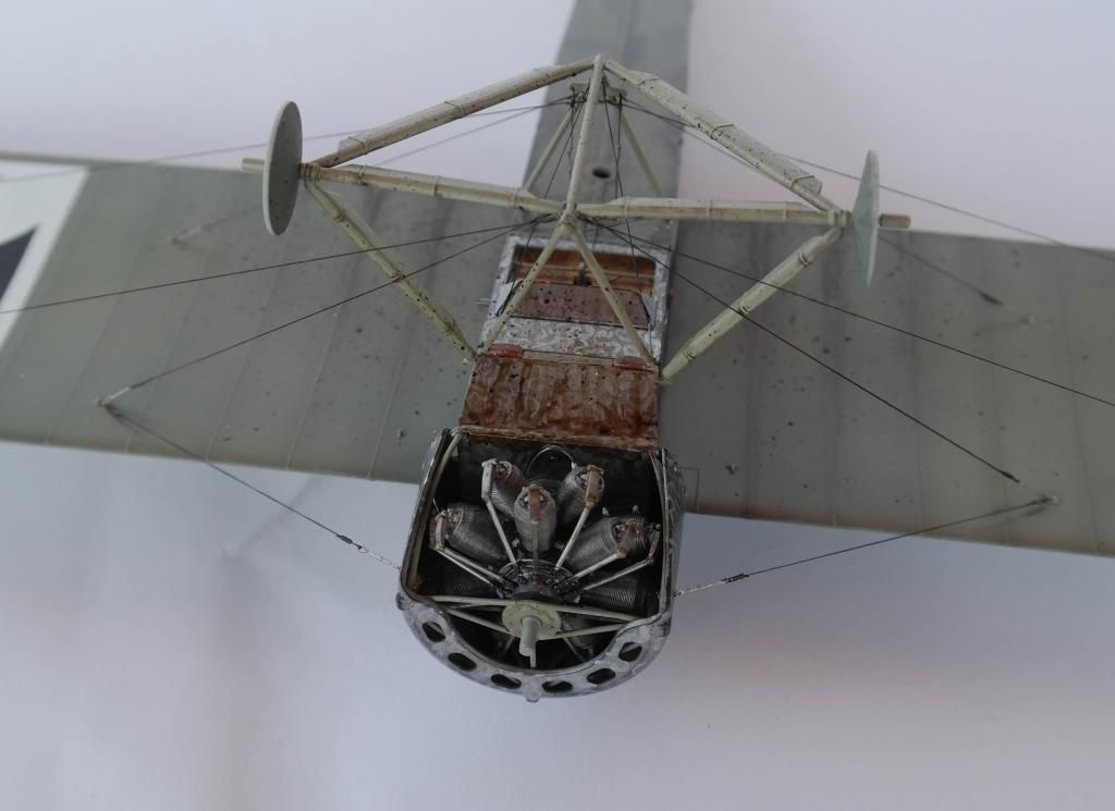

Hello,

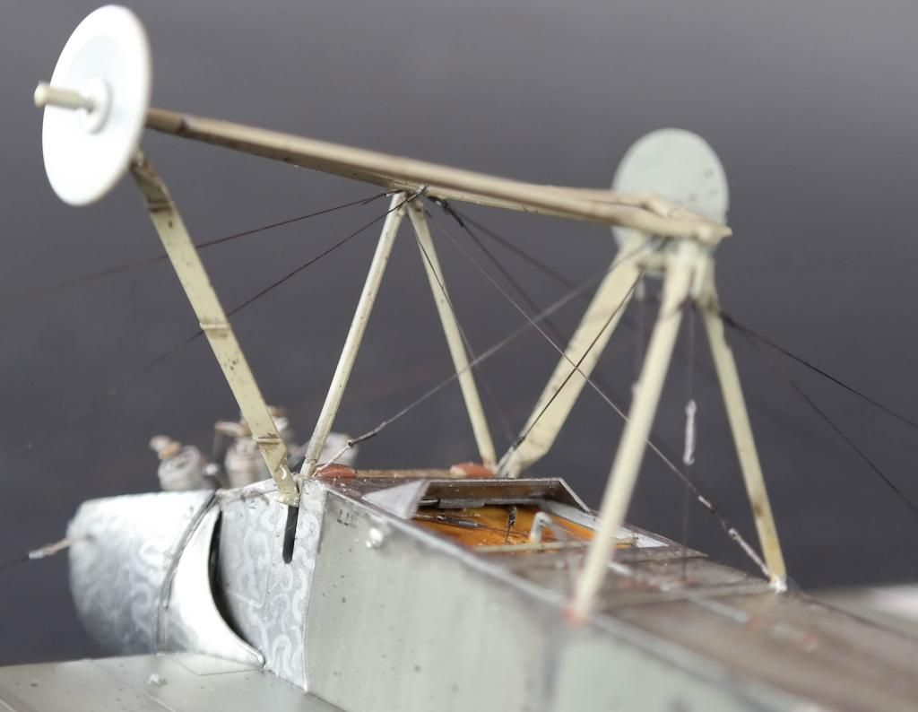

thank you very much for the nice words and for the recomendations, I was very carefull not to overdo the weathering as this was what got me scared also - making her too dirty and ugly.
Well after staining the wings I think this phase is over, I iwll probably add some more in the tail area and just a tad more on the wings, thou I haven't decided on this for now.

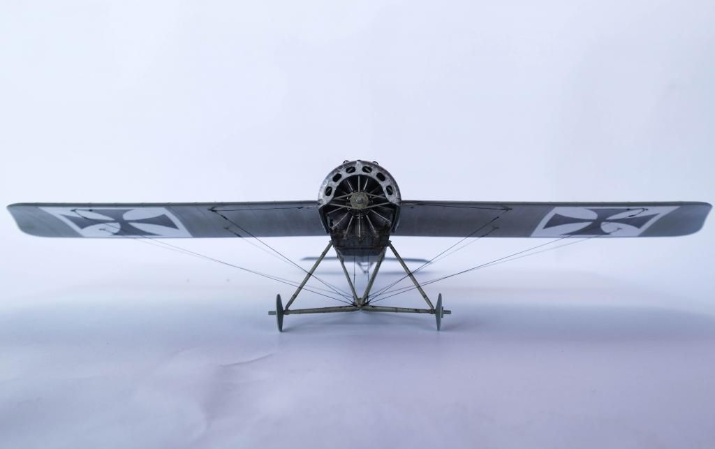

On a side note, at the moment, we have 5 Eindecker builds and at elast 3 of them are on the same stage - undercarriage rigging :) My build is also there and I keep an eye on the others, so I will adhere to the advice of colour coding the turnbuckles red/green/blue, but just in the central area of each turnbuckle as I think the paint on the " eyelet"area will peel off and so I doubt it was painted at all. I used several photos of the undercarriage from the instruction booklet and WnW website to get the right location of the turnbucles as I don't want to screw this aspect of the model.
I also finished the tailskid, glued it and then got it broken, so I had to replace the plastic pin with some brass tubing, but that was easily fixable! I glued the wings and I will be working on the tail in the next days, I also have few decals tro put here and there :(
Here are the pictures, as usually any questions, comments, reccomendations or constructive criticism are welcomed
Best regards,
Sasho
PS: I just realized that I got too much pictures, but I will post them anyway
« Last Edit: August 02, 2014, 11:49:48 PM by Ssasho0 »

On the top view, it looks in my eyes, as if the left-hand elevator bent forward....... ???
Be careful when bending back. :-\

« Reply #53 on: August 03, 2014, 04:02:56 AM »
I have missed this up to now. This is a truly first class model with a standard of weathering and worn finish that I have rarely seen matched. This will be a winner when it is finished - no doubt.

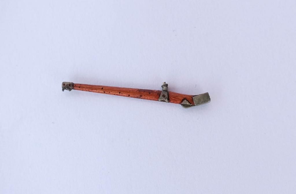

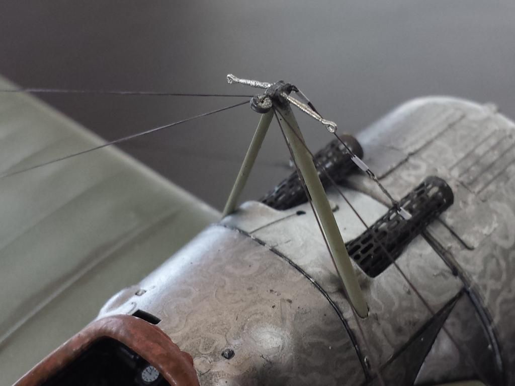

@Bertl - the tail elevators are not glued yet and by the way I got the part broken, but it is no isue and even makes the things easier. The left one is juts not fitted good enough but I will come to this ssoner than later :)

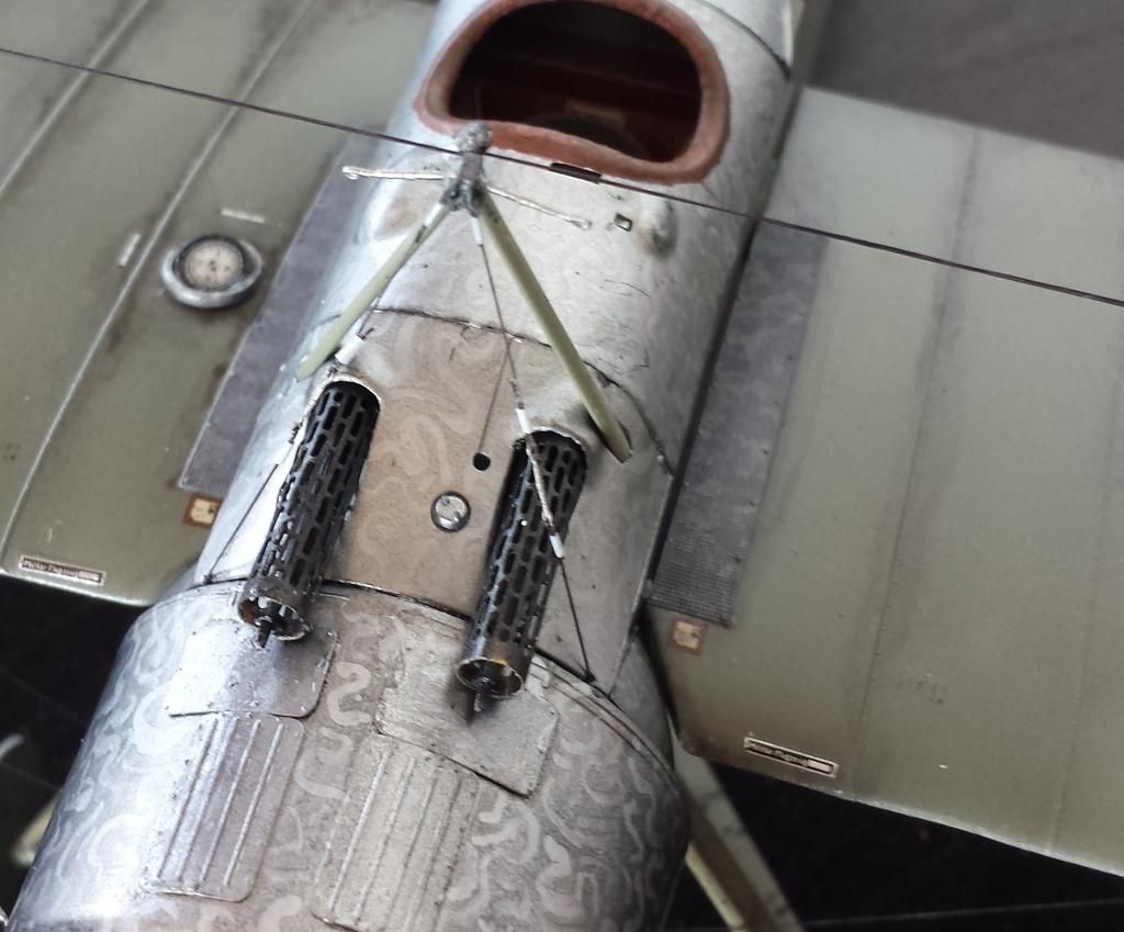

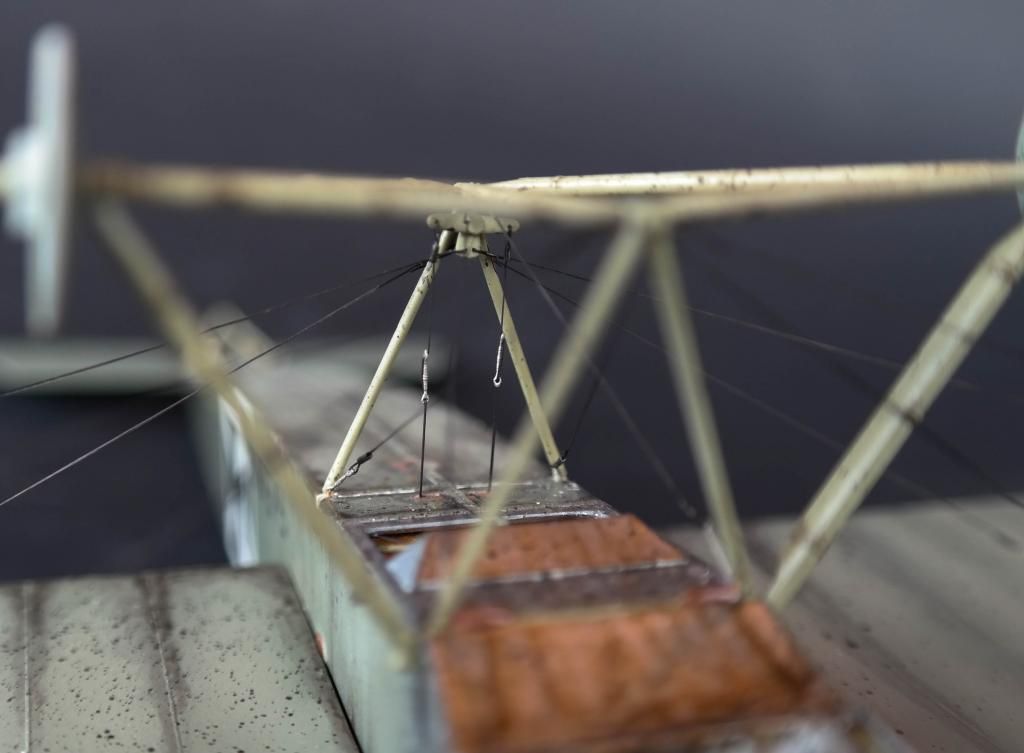

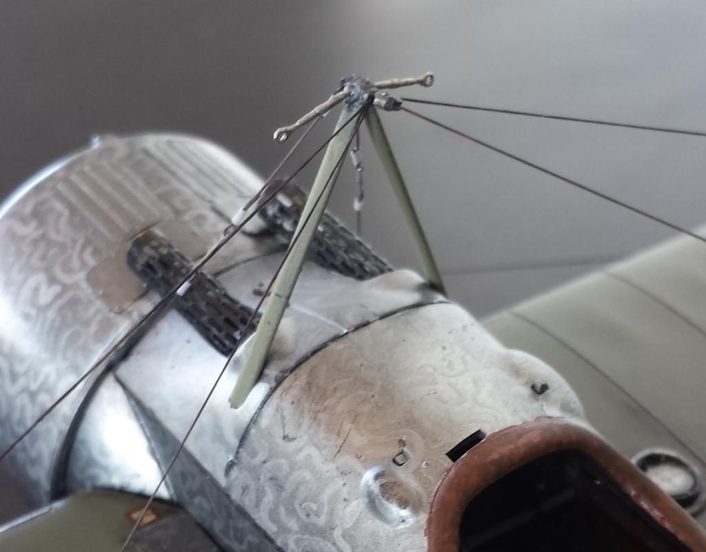

In the last days I was working on the rigging of the upper part. I made some changes ot the original parts G12 and A33: First I cut th epin of part A33, made a hole in the middle of the reel and with a bit of steel wire I made it working and with a hole behind in which the cables go. Then I cut the moulded turnbuckles in part G12 and replaced them with Gaspatch 1:32 turnbuckles. I used 1:48 Gaspatch bukles for the rest of the build so they look pretty much in scale :) To tighten the cables I used streched earbuds/cottonbuds. Unfortunately I don't have of this nice tubing Bertl, Bo and some others use.
Still there are 4 cables to be rigged and then I will have to fix all the small issues around the build and proceed with the tail rigging.
Best regards,
Sasho
