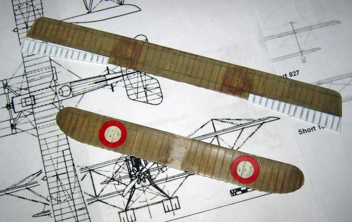

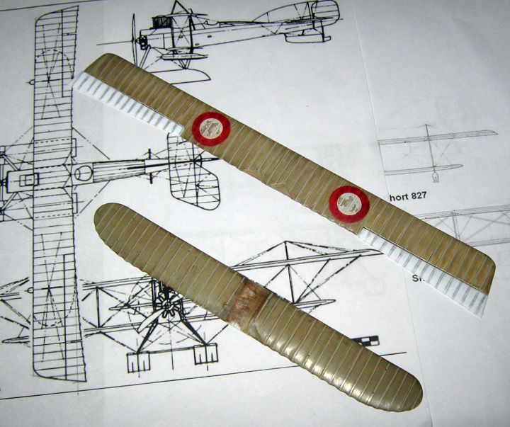

Further progress on this, my friends....
First, here are the wings, finished on both surfaces, with ailerons made but not yet painted or attached:
Framework on undersurfaces is drawn in with ordinary pencil before painting, and painting is stopped while it still shows through. The roundel indication on the undersurface of the upper wing was put in by drawing with a red water color marker, which was then spread about with Future on a brush; this was done before framework was drawn in, but after rib indications were scored in.

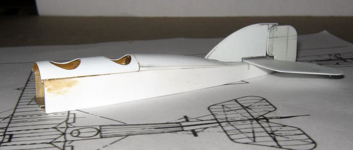

Here are the blanks for the tail surfaces:
These are made from 0.30" inch sheet (0.75mm). They are just tacked in place temporarily to check that everything actually fits together before I put in ribs and such.

Bit of further progress here: the wings are assembled to a unit and structural rigging put in....
Here is a look at the fuselage and wings in something close to their proper relation....
Just about everything in front of the leading edge of the wings will be the Sunbeam motor on its bearers and frames.
When the time comes, the center of the lower wing will be cut away with a razor saw, and fitted to the fuselage sides. Then the cabane struts will be added. This machine was a 'folder', with the wings constructed to fold back alongside the fuselage, hence the interplane struts alongside the fuselage sides. The struts were of oval section steel tube, without further fairing, and I think it most likely the naval habit of slathering grey paint on anything metal at sea would apply.
Putting in detail on the tail pieces and fuselage is on the card for next week, but I will soon run out of excuses to put off doing the motor any longer....
