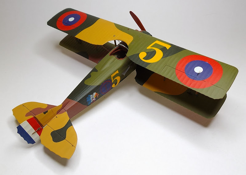

Here is my 1:32 scale Roden Spad VII c1, this was built quite some time ago.
Full build log can be found here   http://www.ww1aircraftmodels.com/page18.html

Fantastic build again Des, tremendous painting, very nice interior. I didn't know the rigging was so difficult! Congratulations.

That's about what I was thinking.  The rigging would certainly give me pause.  Fabulous
paintwork, Des.

Through the brilliant colors I really like   :D

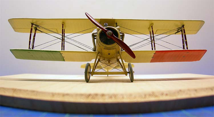

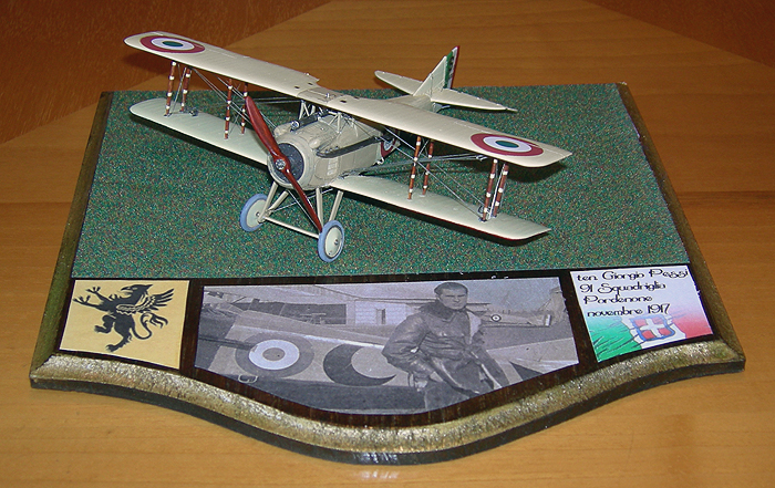

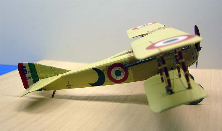

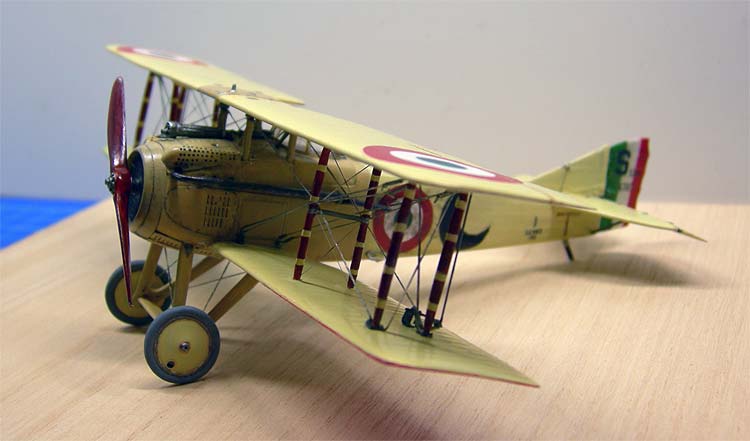

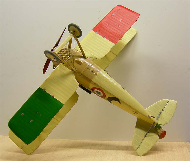

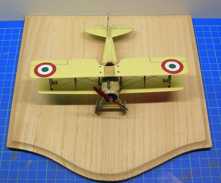

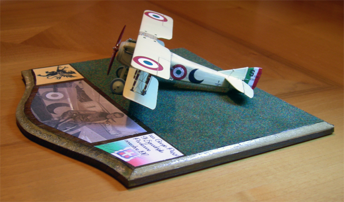

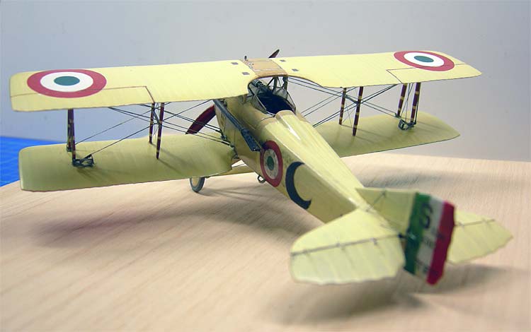

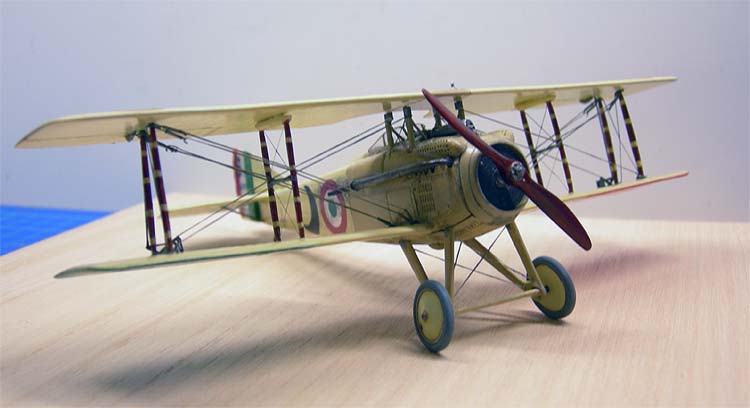

My tribute to
Giuliano Parvis AKA Lt. Giorgio Pessi, 91a Squadriglia (8 victories - 6 officially credited), wingman of Capt. Francesco Baracca
Pordenone Nov. 1917
kit Special Hobby 1/48 "French and Italian Aces"
More shots:
Build log here

Gorgeous SPAD, Antonio!  Which kit is it?  Your build log link is to your beautiful SVA.
Re: Show us your - Spad VII c1
« Reply #13 on: January 17, 2015, 02:39:27 AM »
Thanks for spotting the error Bud, I updated the post now!!!
« Reply #14 on: January 17, 2015, 03:20:16 AM »
I remember this build Antonio. You came through with a beautiful SPAD inspite of some difficulties! Well done!
