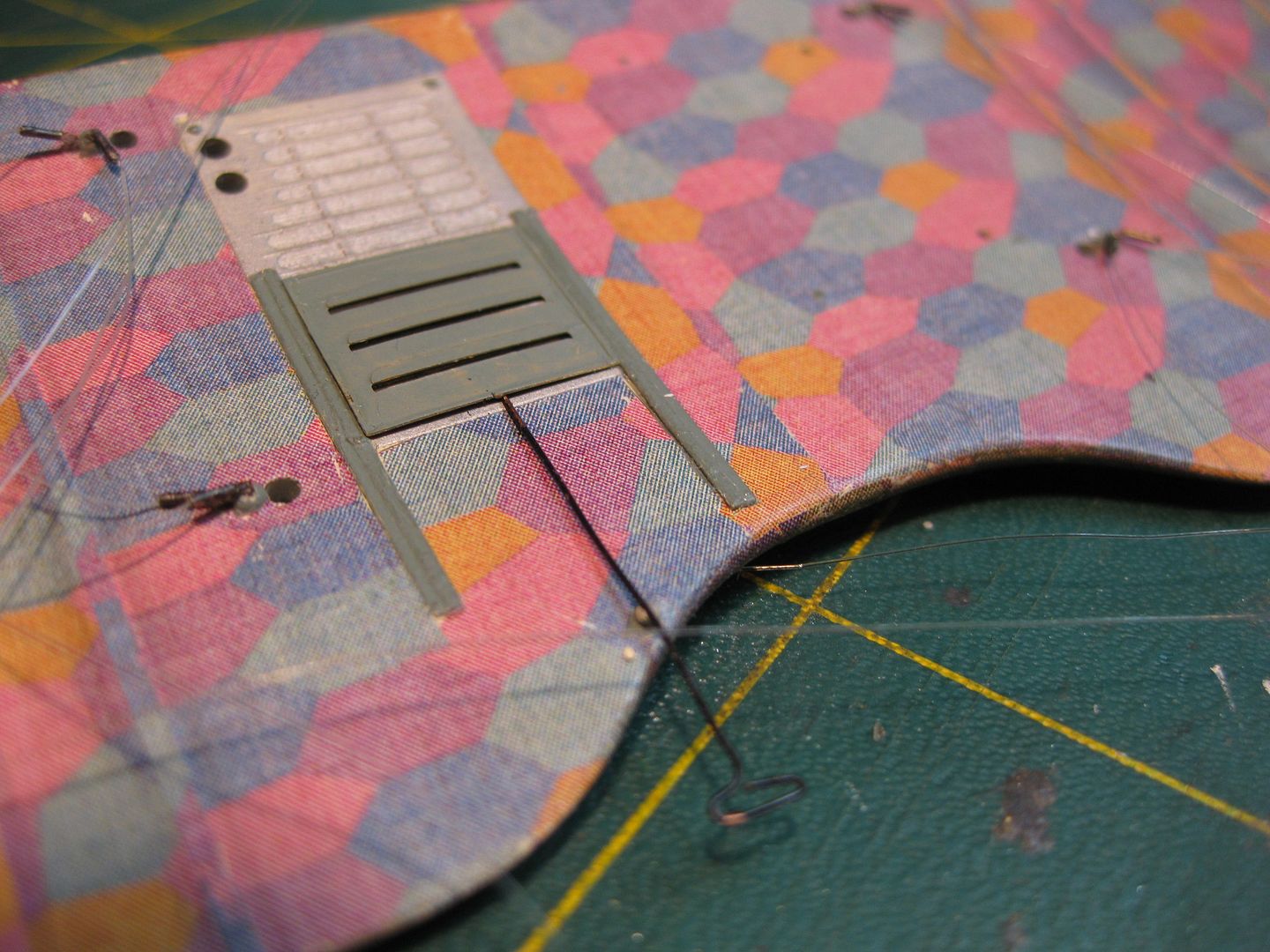

   A lot of the sub components were completed and have been installed. The engine side panels, guns, a hand carved laminated prop, spinner, folded down windscreen, and landing gear (dry fitted only at this stage) are complete and on the airframe. The upper wing is completed and ready to go on the aircraft and all upper buckles (von Buckles variety) and lower buckles (GasPatch) are done. The upper wing is pre-rigged with .013 and 0.15mm Mono.

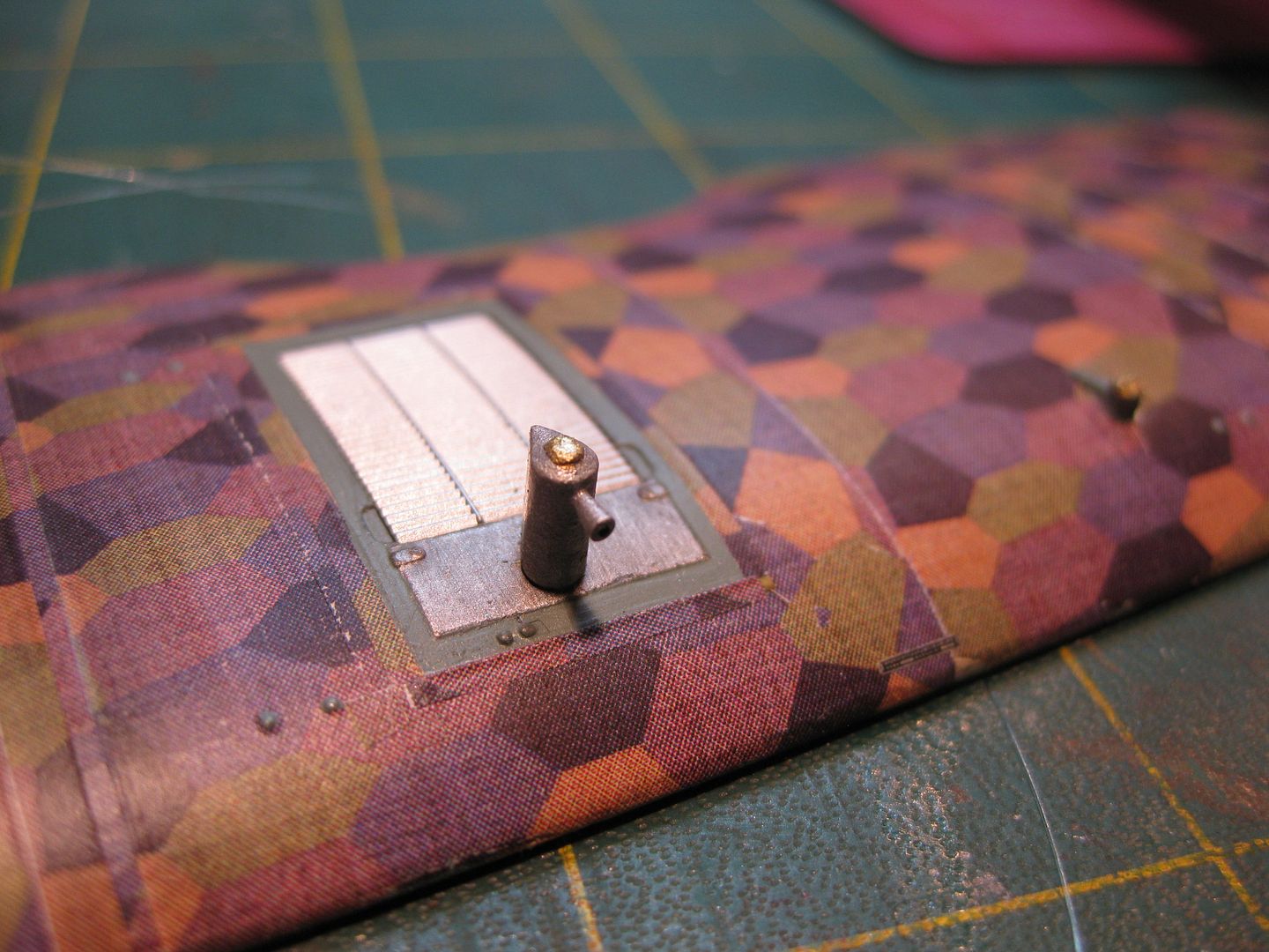

   Here's the top and bottom of the upper wing with the Radiator assembly...........
   The control handle for the Rad Shutter is posed and still needs a coat of grey-green.

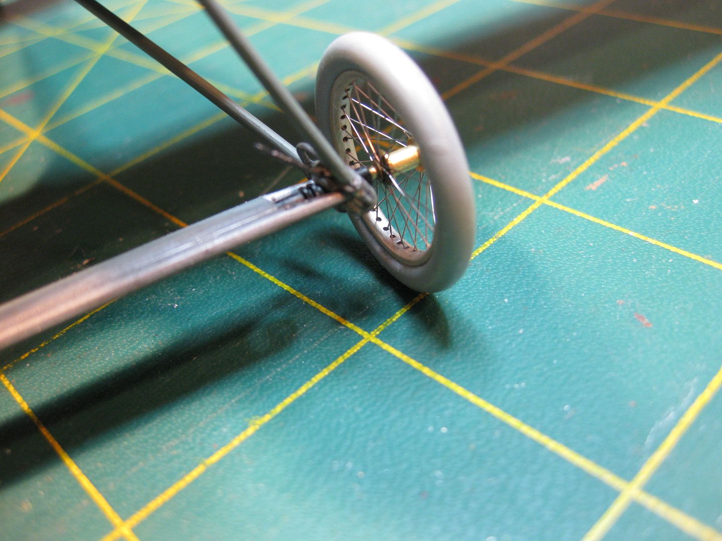

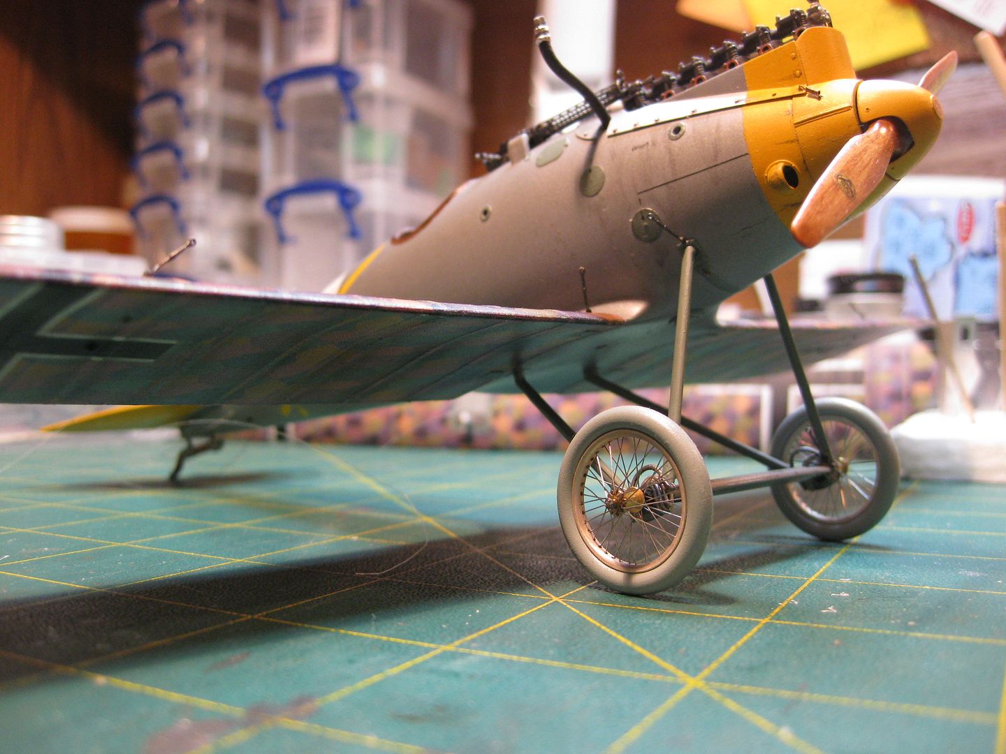

   Here's a few shots of the landing gear with Steven Robson's wonderful spoked wheels mounted. The tires are the supplied O-rings painted dull grey and I'm going to finish the Kit wheels as well in the event that I don't find the end product worthy of these little jewels! Has anyone tried spraying these with a flat or satin finish??
    I've installed Gas Patch Turnbuckles on the landing gear as well.

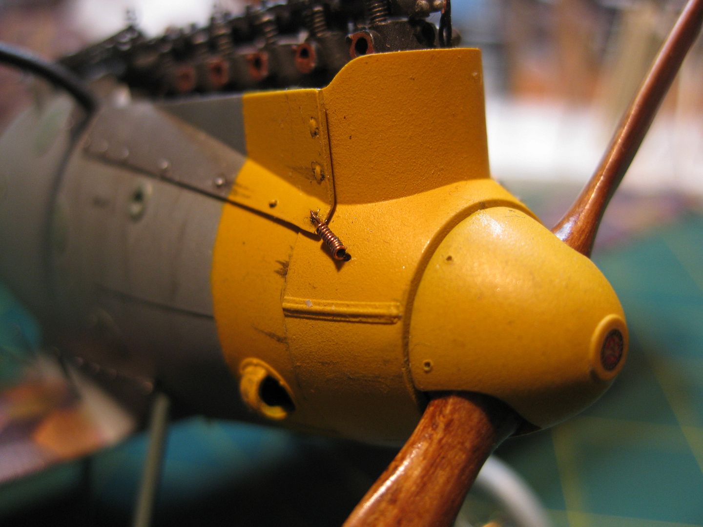

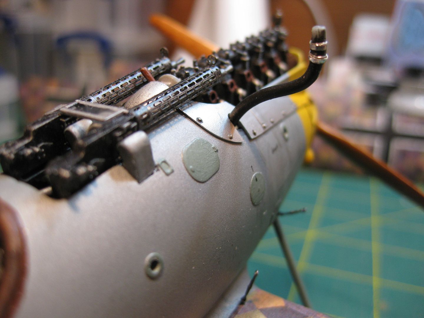

    I added the panel retaining springs to the engine side panels, made from very fine copper wire, I'll be repainting them as I managed to wear the stainless colour off installing them. I also added the spinner mounting bolt holes; some photos showed 6, others 8 total. I used the smaller number.

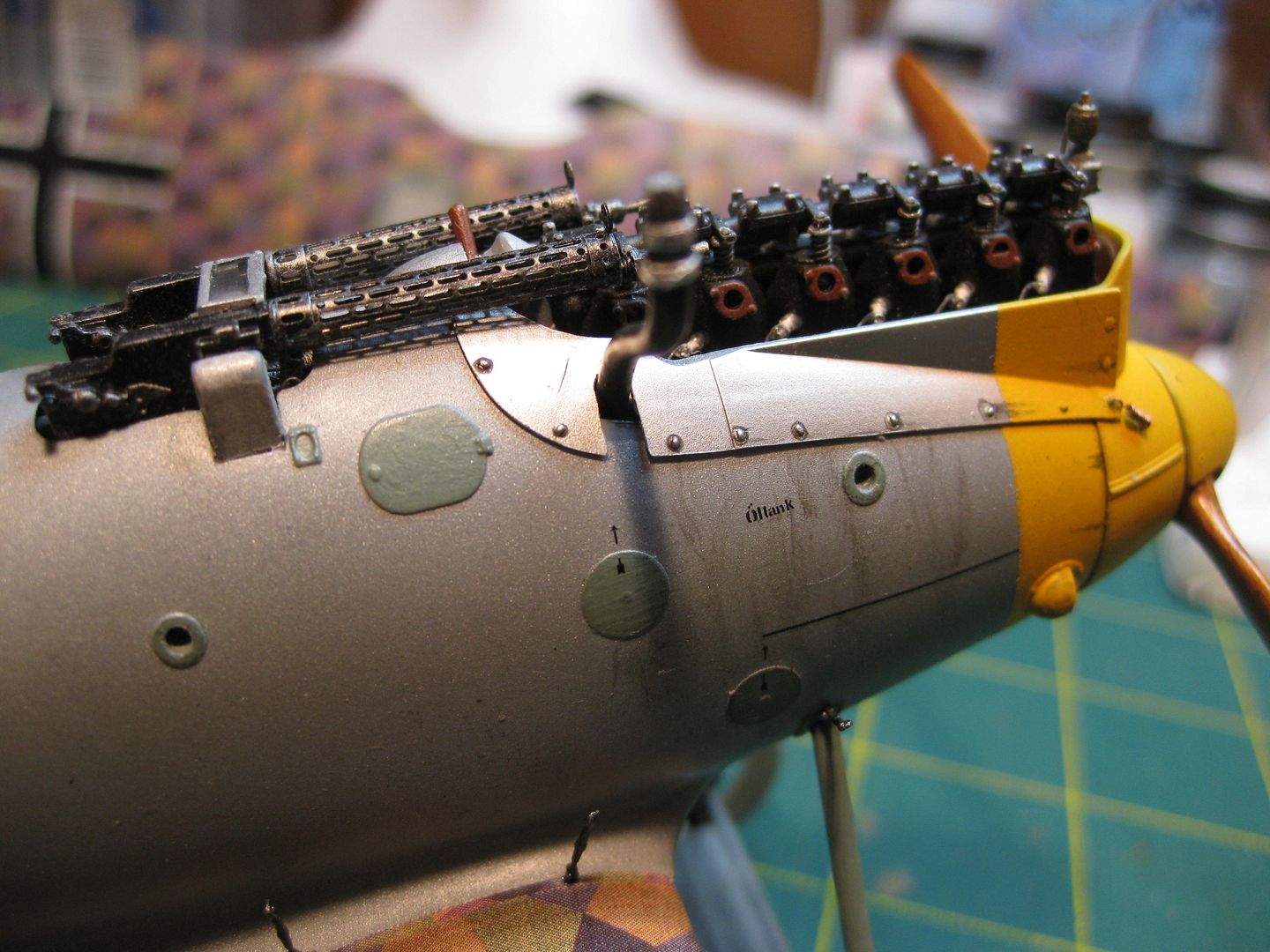

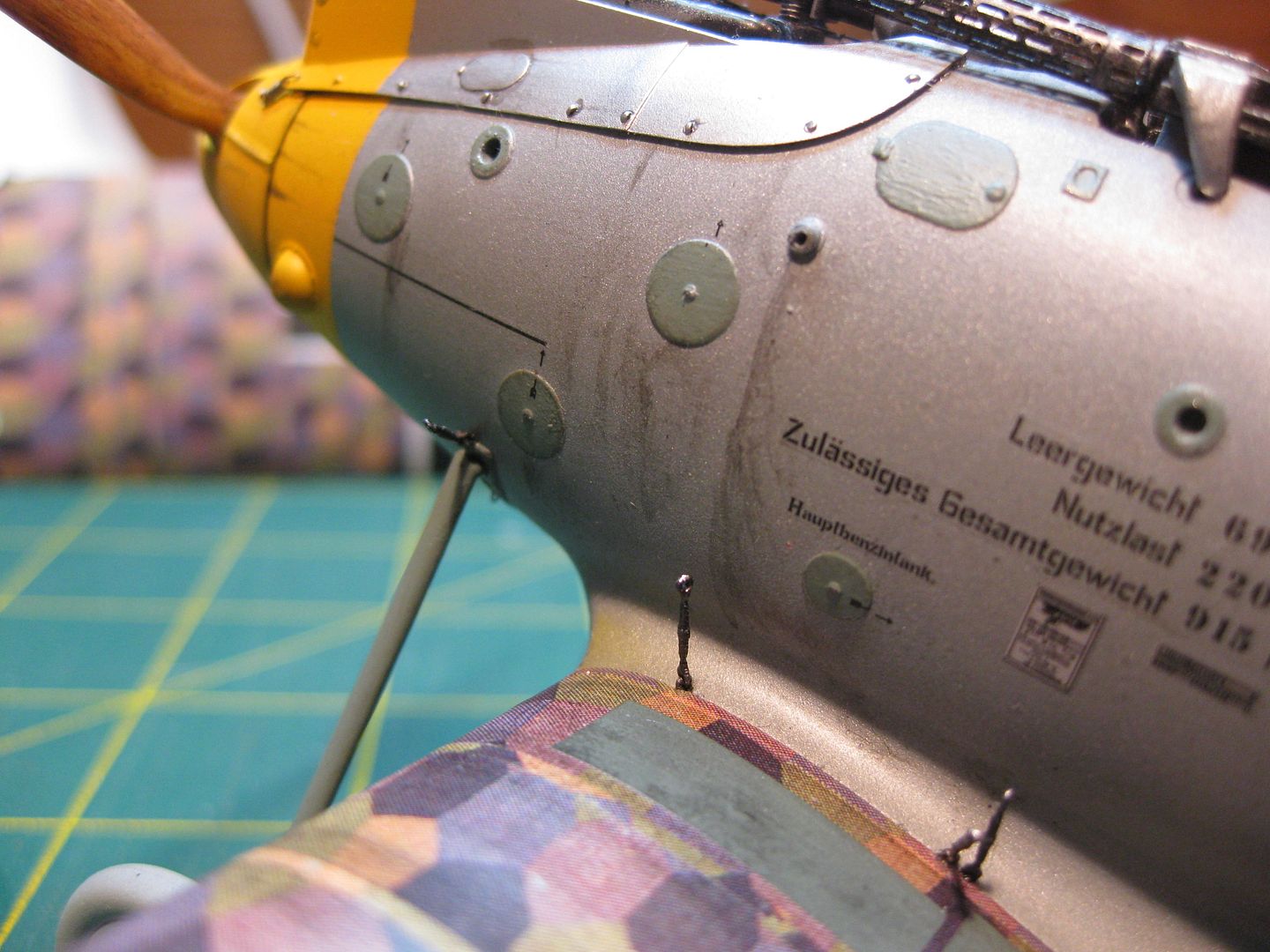

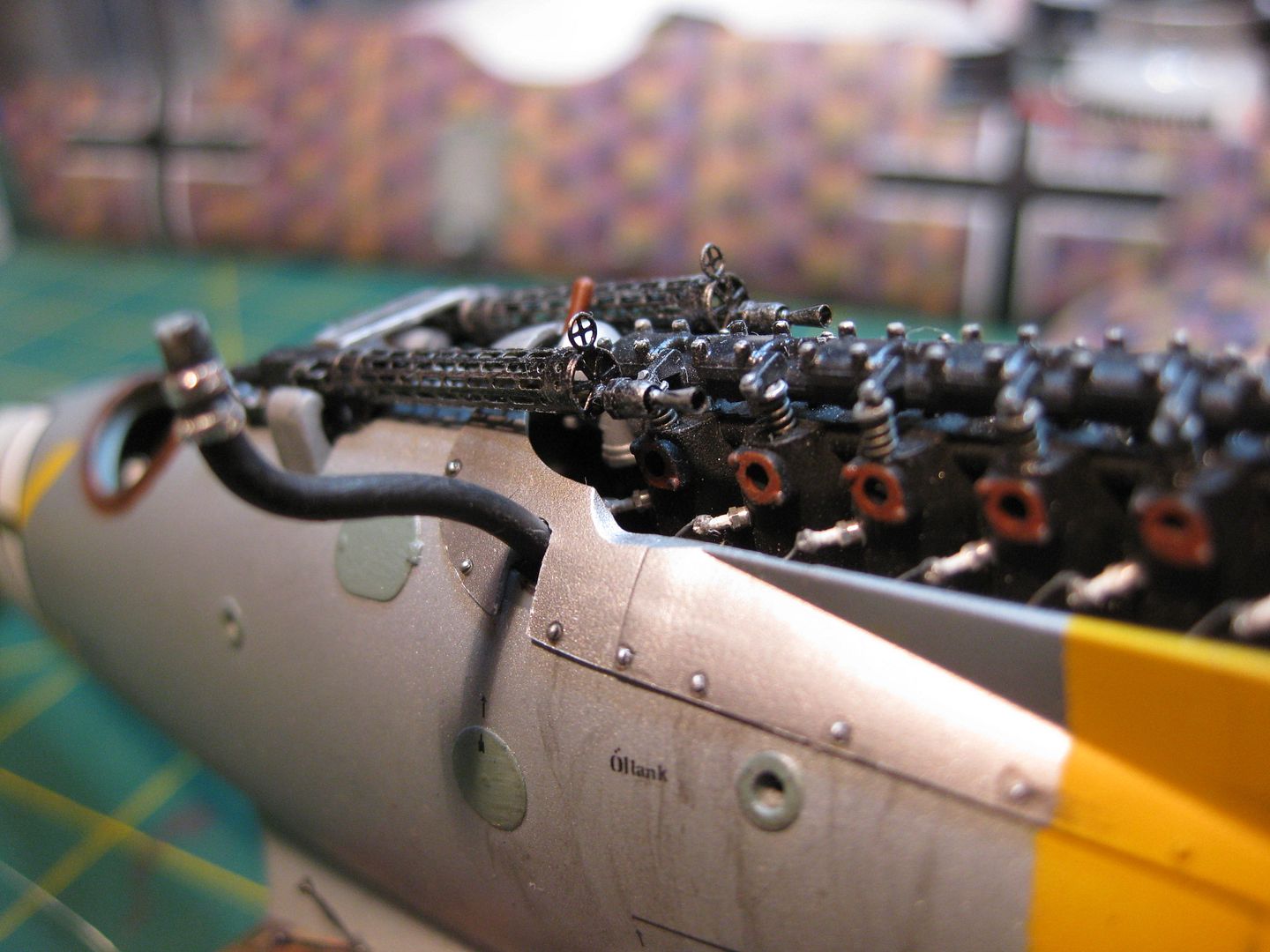

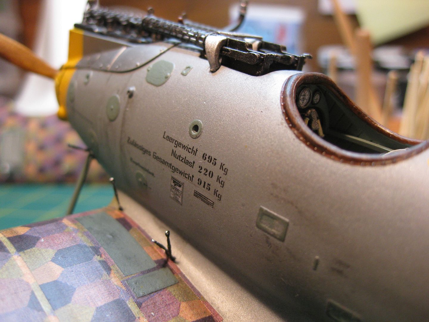

   The forward fuselage has been weathered with all the "mechanical" ingredients of oil and fuel stains and grease marks; I still want to add a bit of mud and dust to complete that process and get a tiny bit on the aft portions. Here's a number of shots showing the weathering and the additions of panels, guns etc.

    More weathering and Gas Patch items.....................

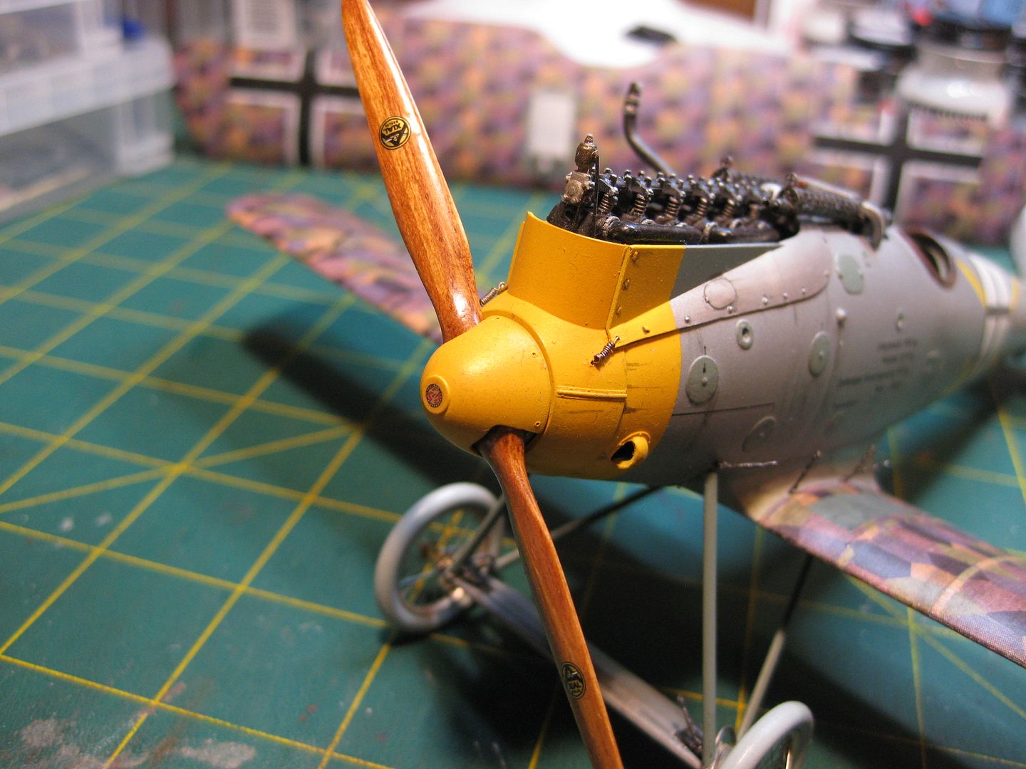

   and last a shot of the hand made prop, (Axial) In retrospect I wish I'd chosen a tighter grained light colour veneer to get more contrast however this one will fit the bill; it does show the laminations quite well under most light conditions. It's a six layer veneer lamination and I got lucky, usually takes two or three attempts however this one worked as the only one required right from the beginning!

This is one sweet Pfalz, Lance!  ;D  The finish and details look just great, and I am in awe of your hand-carved laminated prop.  Even without the darker laminates, it really looks most excellent.  I love it!  That's quite a skill you've mastered.  What kind of wood do you use, and where do you get it?

Outstanding work Lance. Love all the detail, wheels are great and your prop is indeed magnificent. This is a fantastic build all the way. Looking forward to see what's next. Meanwhile I wish you all the courage you need to clean up the snow poor fellow!

    I bought a large variety package of thin veneers at Lee Valley Tools, the sheets are approx. 9X12 inches and most are 1/32 to 1/16 thickness. I use Carpenters White Glue and press the "blanks' overnight in a vice. I also have some Flying Model Aircraft Plywood that works quite well; made by a company called Midwest in the US. Look for the Birch type and make sure it`s 5 layers or laminations thick. I sometimes add another layer to it. It`s 3mm (one -eighth inch thick) which is sometimes a litte thin for the profile of the prop.
   If you`re interested take a look at my Tutorial in Hints and Techniques.

Incedible good progress. I really like your macro-photos.
And the spoked wheels look really really well.
