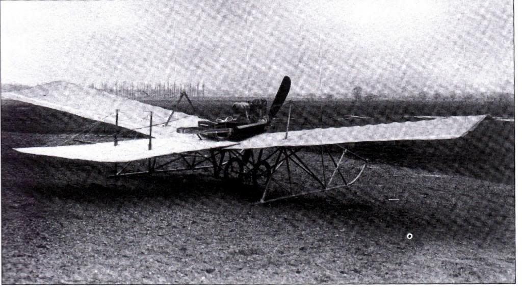

Des,
The frame that you made will only be useful for the Spin 2 or 3. Spin 1 is different. I have one picture and I'll try to make a scan of it, then you will see what I mean.
regards,
Ivo
Offline IvotB
  • Posts: 426
Re: 1:32 Fokker Spinne (Spider)
« Reply #55 on: September 11, 2013, 07:22:00 AM »
Spin 1
No rudder, no keel, different landing gear.

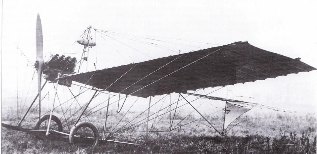

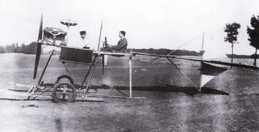

Spin 2
Side image, without the wings
Spin 3

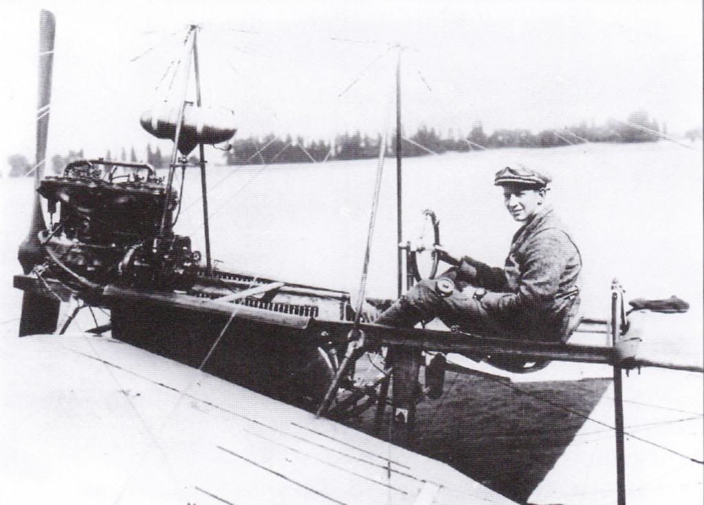

with Renault engine
with Argus engine and Anthony Fokker at the controls.
