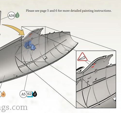

You're off to a nice start Pete!
You missed snipping off the little buggers on the upper left side of the cockpit opening, I noticed because I made the same mistake :)
Hi Bo;
Which little buggers are you refering to?
Thanks for the eng ref numbers info.
Pete.

« Reply #41 on: August 21, 2013, 03:32:36 AM »
Hi Bo;
Pete.
page 11 of the manual... not sure what the bumps are for... they aren't used on the D.Va kit either. Maybe supposed to be a lug for mounting an accessory altimeter in the yet-to-be-seen deluxe version?...

« Reply #42 on: August 21, 2013, 06:23:22 AM »
Oh! them little buggers, damn I forgot them, I will soon remove them, many thanks.
Pete.
