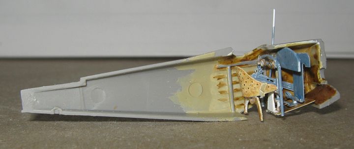

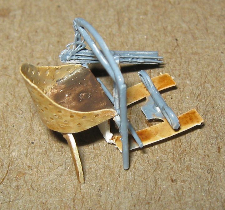

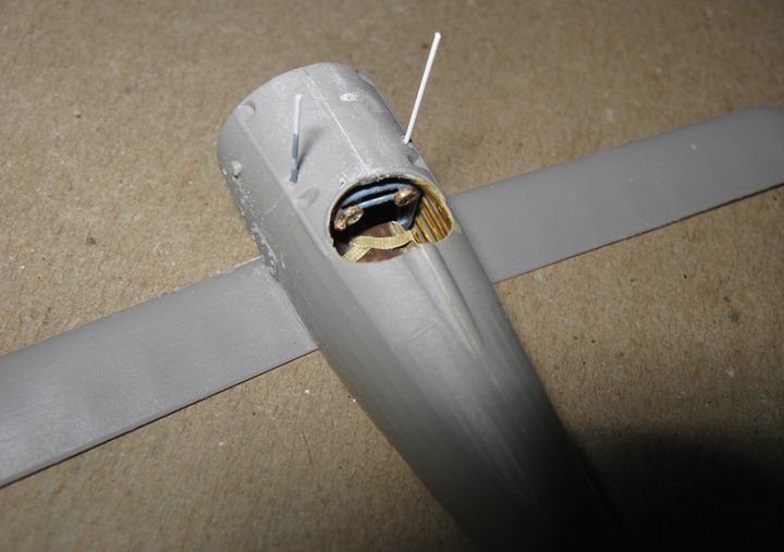

This is the basic interior structure. It is a mix of photo-etch from Tom's Modelworks (seat back, foot slides, 'throttle' and rods), scratch-built bits (the tube frame, and the backing for the throttle, and the aileron rods off the stick), and kit pieces (rudder bar, stick, seat bottom, and rear seat support).

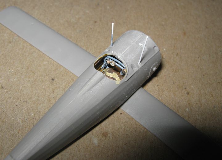

Here is the finished interior in place. The front of the fuel tank is scratched, the vertical piece between the foot slides (a combination ammo box and collector for links and brass) is from Tom's Modelworks. The gauges are scratched, with bezels from the photo-etch set. Seat-belts are foil from candy. The vertical rod is the aileron actuator, slid through a hole where the kit piece for this part is intended to go. The external portion will be trimmed, but passing this through the hole to engage the pieces going to either side from the stick let me be sure the angle was right.

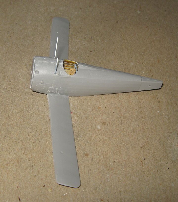

Here is the fuselage closed and lower wing attached, with looks into the cockpit....
The lower wing to fuselage joint needed a bit of work. Before I did the interior, I tacked the fuselage halves together with a couple of dots of CA gel, and did a bit of trimming and dry-fitting on the mating surfaces. An excellent fit can be easily gotten this way.

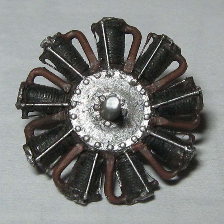

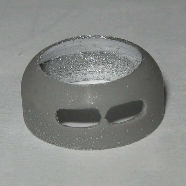

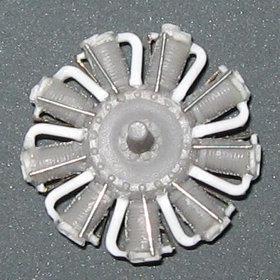

The Roden kit includes a decent LeRhone, but it is of the higher power type with all its works behind the cylinders. I had a spare from an Eduard N.17 kit, with a front manifold and cowling as well, but the outer circumference of the Eduard cowling was a hair too small for the Roden kit's nose, and so could not be used. I decided to work the Roden LeRhone into an 80hp motor, and use the kit's cowling pieces. I thinned the cowling interior before and after assembling its pieces, and enlarged the cowling's vent cut-outs (these were positioned so that, when a cylinder was expelling exhaust and oil, its head would be where a hole was).
The Roden LeRhone fit a little loose in the original thick cowling, so after removing the 'works' in the rear, I sanded flat the tops of the cylinders and add a disc of 1.5mm rod to each to make them longer. I dressed this up with a bit of square .25mm rod across the top (to represent the dual valves), and a bit of square .25 rod in front of this, only half-way across the top (to represent the revolving valve actuator). Lengthening the cylinders put the spark plugs moulded to the piece too far from the top, so I trimmed them and replaced them with bits of round .25mm rod. The fuel feed pipes are from .5mm round rod; the push-rods are 34 gauge beading wire; the ignition wiring is .004" brass wire.
Here is the motor painted:
All these pictures are very much magnified....
