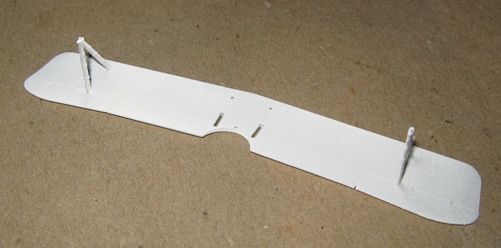

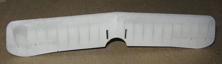

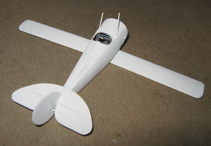

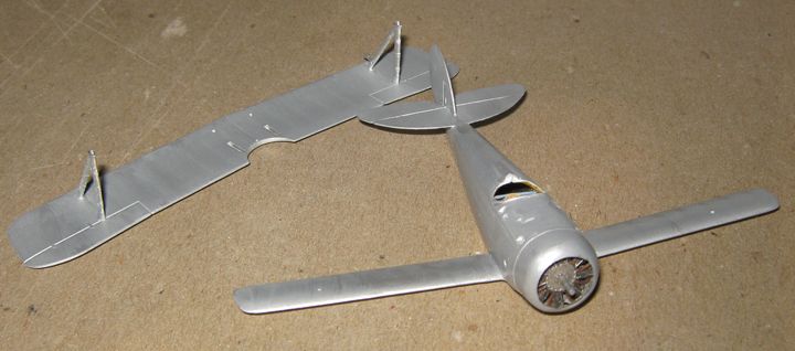

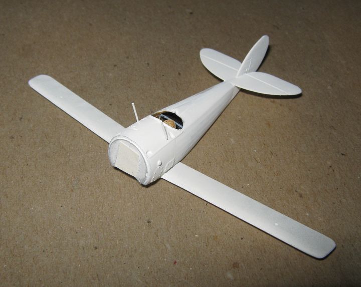

Here is are the larger pieces: the fuselage and lower wing with tail surfaces attached, and the upper wing with interplane struts attached, all under primer:
Everything fit well enough, though it is a good idea to trim the fuselage a little where the horizontal tailplane seats, and also wise to trim the locating pegs down on the interplane struts.
I am going to leave this to rest about a week, to be sure the primer dries down properly. I ran out of my usual Tamiya white, and my local shop, it turned out, was it of it too. What I am using here is an elderly can of Floquil figure primer. It seems to have a tendency to get a bit tacky when handled after seeming, to all appearances, and to initial touch and handling, quite dry. So I  intend not to touch it at all till next Saturday or Sunday, which I expect will do the business....

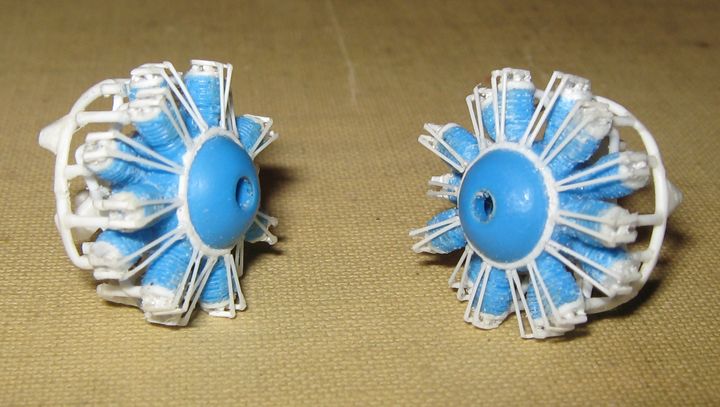

The maddest bit of engine work I ever did was this....
A pair of Armstrong-Siddeley Jaguars; there were about a hundred fifty bits of plastic added to each of the pair.

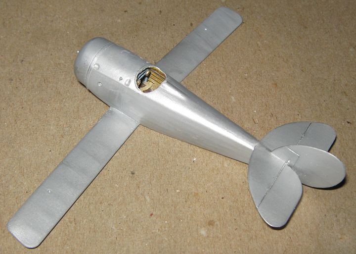

« Reply #21 on: August 08, 2013, 01:15:11 AM »

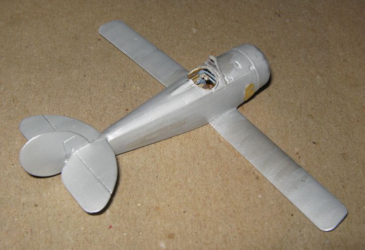

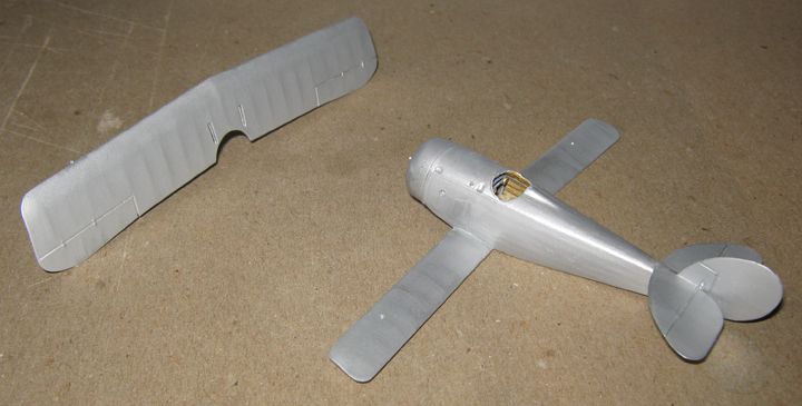

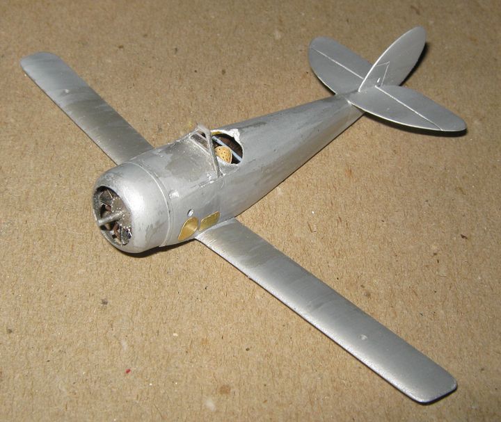

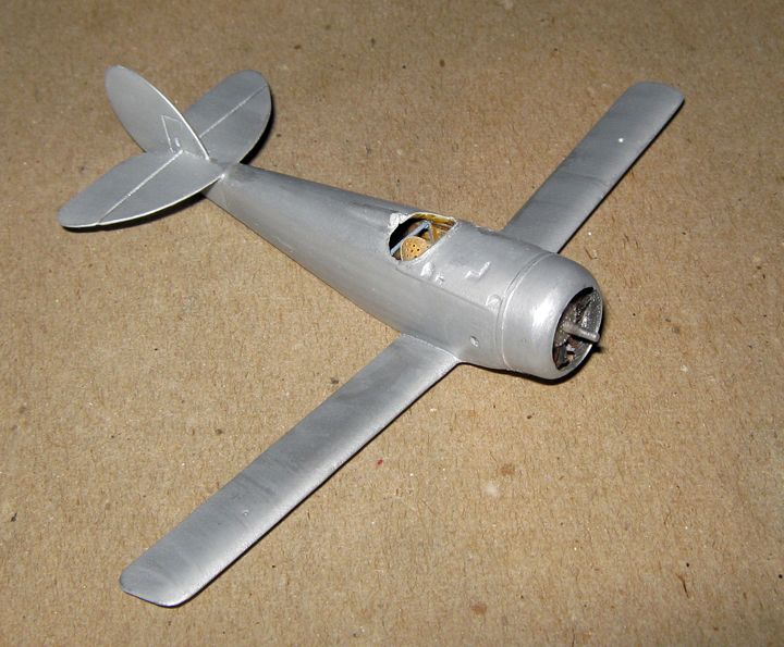

Well, she's silver now, Gentlemen...
Cowling fit was a bit off, but I expect this owed to cleaning up the seam where the two cowling pieces join: interior fit was good, but the fuselage was a bit wider than its outer diameter, especially the lower portion. Dealing with this pretty much required removing the moulded on panels; they will be replaced from the Tom's Modelworks fret. The motor lost two actuating rods during this (look at the lower cylinders closely): these have been replaced after the pictures were taken. Cowling retainer band is a strip of heavy foil.
The substitute primer had dried hard, at least, but had a grainy texture even after extensive work with the 3000 grit pad.
Finish is an initial coat of Tamiya spray silver, followed by a craft acrylic silver tinted with white, and heavily cut with future. Later, plywood and metal areas will get coats with a different tint....

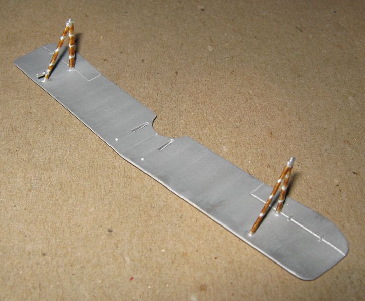

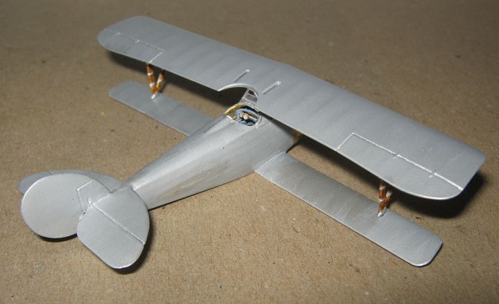

Further progress here, Gentlemen....
Most projects will run onto a spot that is all at once small, maddeningly difficult, and essential. On this, it is the windscreen, tucked away inside the inverted vee of the rear cabane trestle. I had only seen this pattern of windcreen on RFC Nieuport Scouts before, and thought it peculiar to them, but the Arawasi article has several photographs clearly showing the windscreen to be of this pattern. It is very different from what usually appears on French Nieuports, and I am wondering if perhaps it was a general export pattern.
Doing it was complicated by the vagaries to be expected in a Roden kit. I have learned to approach these with a wary expectation of ambush, and viewed in this light they do not disappoint. I had to do a good deal of trimming at the top of this piece, and a little bit at the bottom of its legs, to get it to fit properly, and always with awareness the plastic could crumble at any moment. But this had to be done before fitting pieces inside the thing. It took about three hours, a fair amount of which was spent re-placing clear bits which, after trimming and apparently fitting well, fell out of place into the black hole, which is especially voracious where clear strips a bit less than a quarter inch long are concerned.
But that hump has been got over, and I expect things to move a bit more quickly now.
The brass bits showing are the inspection hatches from the Tom's Modelworks set.
A bit of color has also been added, with wood tone on the interplane struts....
Finally, just for a lark, a test-fit with the upper wing resting in place....
