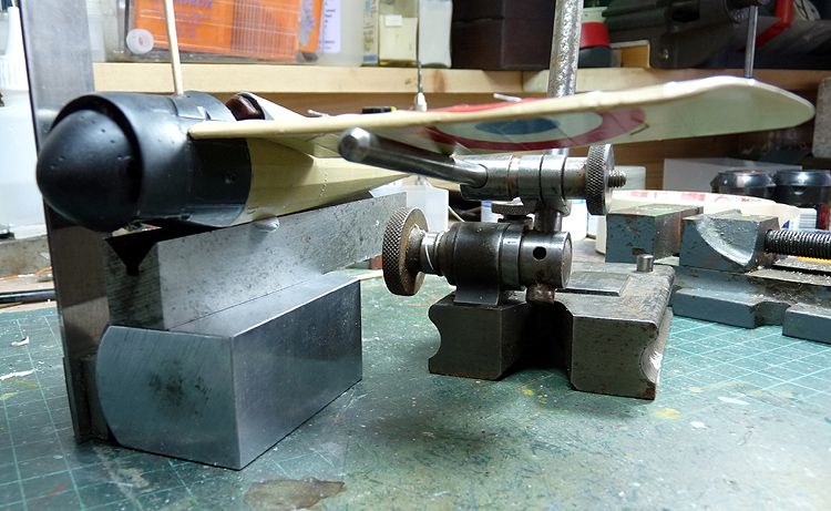

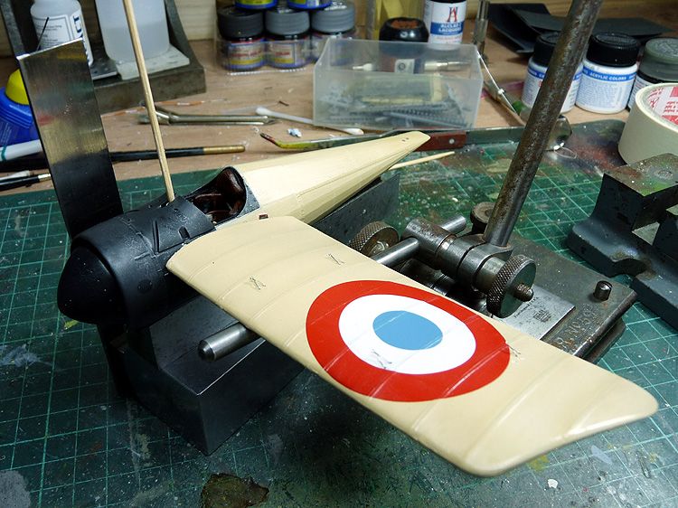

Re: Morane-Saulnier type N ...(Special Hobby-1/32).
« Reply #55 on: September 15, 2013, 08:08:56 PM »
Des, sorry I didn't get straight back to you! Embarrassment more than anything I guess? I do seem to be struggling to make headway at the moment ... not just at the bench, but rather life in general. A bit like driving into heavy rain when your wipers only give you a glimpse of what's ahead: just seems like at the moment my wipers are going like the clappers and I'm still driving blind!!!
Anyhoo - despite the weekend Philosophy, I've taken a couple of drive-by pic's, as much as I thought they might amuse. I've been struggling with the very vague assembly of this "Special Hobby" kit - abandoned pretty much all the photo etch as being for another kit [a ship probably] as it seems to have little or no relevance to the rest of the bits in the box. And I've wasted countless days worrying over the fitting of the wings - all sorts of thoughts of turning a tie-bar or filling holes and providing new spigot arrangements but in the end just thought "Sod it" ..... glue the bliddy things on and make sure the rigging is  nice and tight.
Here's a couple of pic's then - more as proof of minor progress, but as much to show my overkill method of supporting the wing till the sticky stuff goes hard.
Cool huh? .......................
KBO ............. Andi.
« Reply #56 on: September 15, 2013, 08:15:04 PM »
Man, that is one hefty looking jig you are using there, at least it won't bend with the weight of the wing sitting on it  :) :) Looking pretty good so far Andi and I can assure you that there is no need to be embarrassed, you are doing an excellent job, thanks for the update.

« Reply #57 on: September 15, 2013, 11:31:56 PM »
I agree completely with Des! Nnothing to be embarrassed about at all. Your Morane is looking great.

« Reply #58 on: September 15, 2013, 11:56:54 PM »
Looking good to me as well.  I ended up gluing toothpicks into the locating holes in the fusilage, trimming both ends, embedding wire in toothpicks and drilled out holes in the wings, as a way to attach the wings. Actually worked a treat if a little laborious.... until my daughter leaned over the workbench trying to grab something and rested her hand on the plane. Crunch. Dad was a little unhappy but all was forgiven and you would barely notice now (just don't pick it up!)

« Reply #59 on: September 16, 2013, 01:49:38 AM »
Nice to see this one shaping into a plane. Looks great and that jig is industrial strength!! Glad you took the leap!!
