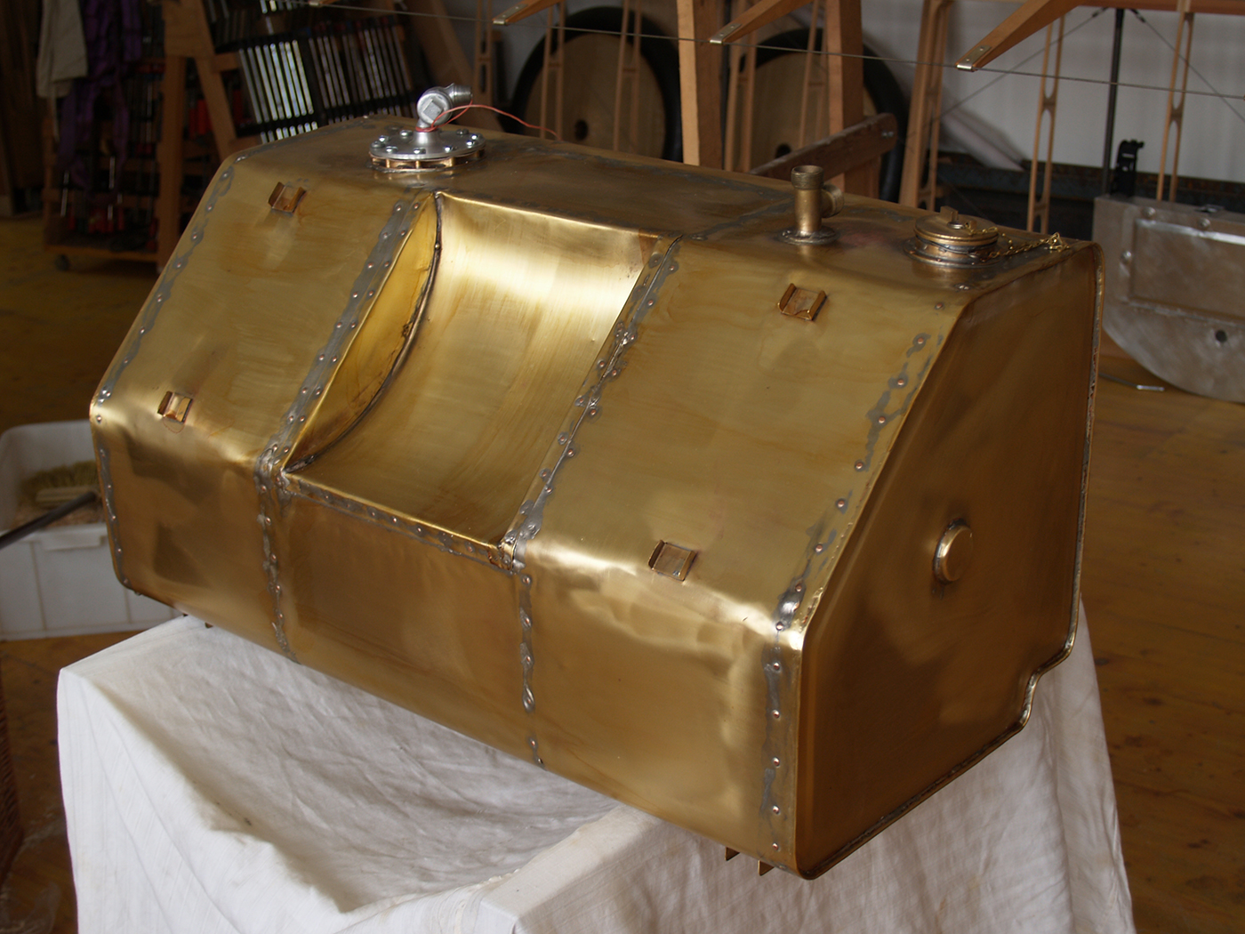

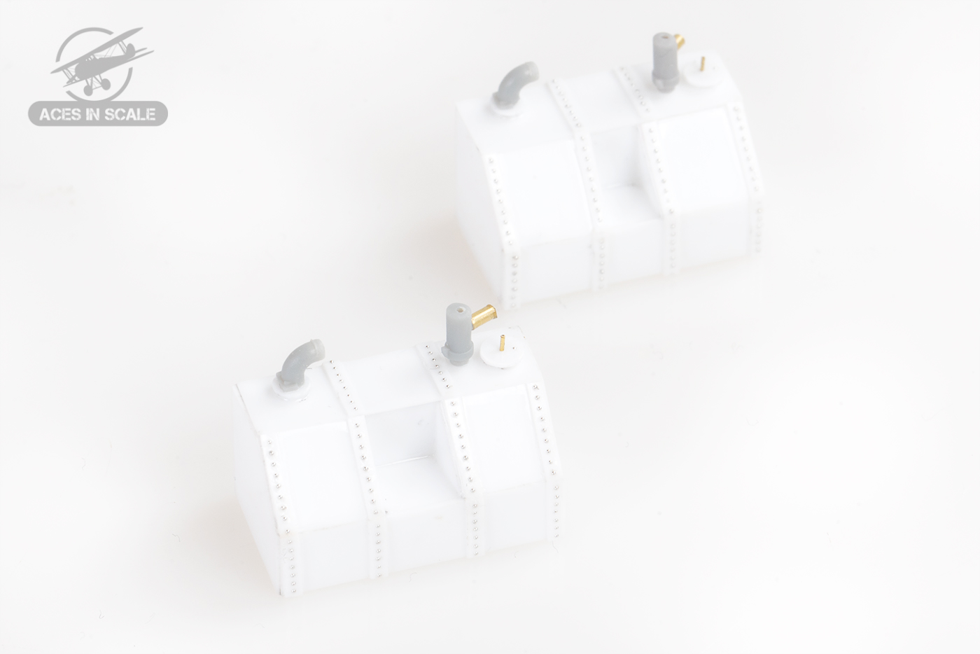

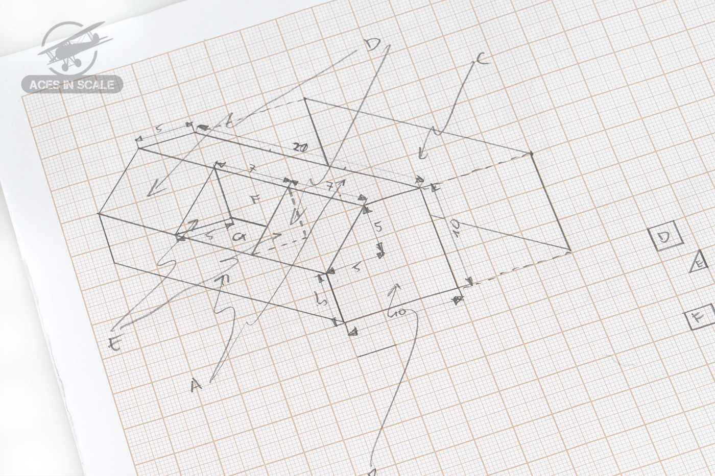

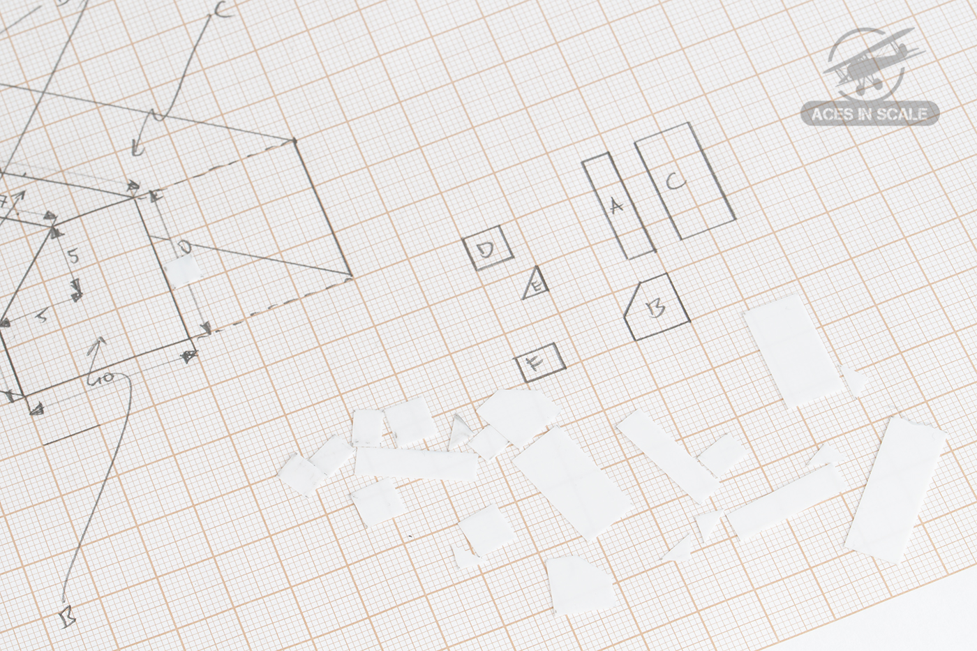

Workshop update - Fuel tanks
The past few days I've mostly been working on the documentation for this model, preparing for the upcoming Moson Show. So not much happened in the workshop itself - but I did manage to make progress on one element: the fuel tanks.
The rear tank, located deep behind the engine, will be barely visible in the finished model. The kit doesn't include it at all. Still, I decided to build it - mostly thanks to the excellent reference photos I received from Craftlab (huge thanks!).
Since I'm documenting this build thoroughly, even hidden details like this are worth doing.
I started by sketching the tank and the general fuel system layout - although I'll tackle the system itself later. For now, the focus is just the tank.

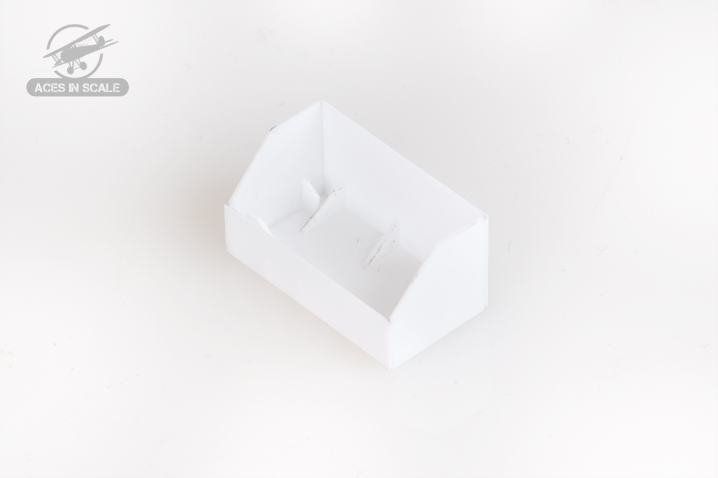

I cut all the necessary parts from polystyrene sheets of various thicknesses and began the painstaking box assembly. I simplified the curved recess in the center into a more angular shape for practicality.
I reinforced the inside with braces to prevent collapse and ensure the structure was rigid. I also added fuel line connectors - leading to the gauges on the left side of the cockpit, the central area, and the engine. I scratch-built the filler cap using punches, scrap bits, and brass tubing.
Finally, I added clamps, filled the seams, and drilled all the rivet holes. First I marked them with a rivet tool, then drilled each one by hand. Then came the slow part - riveting both tanks.
