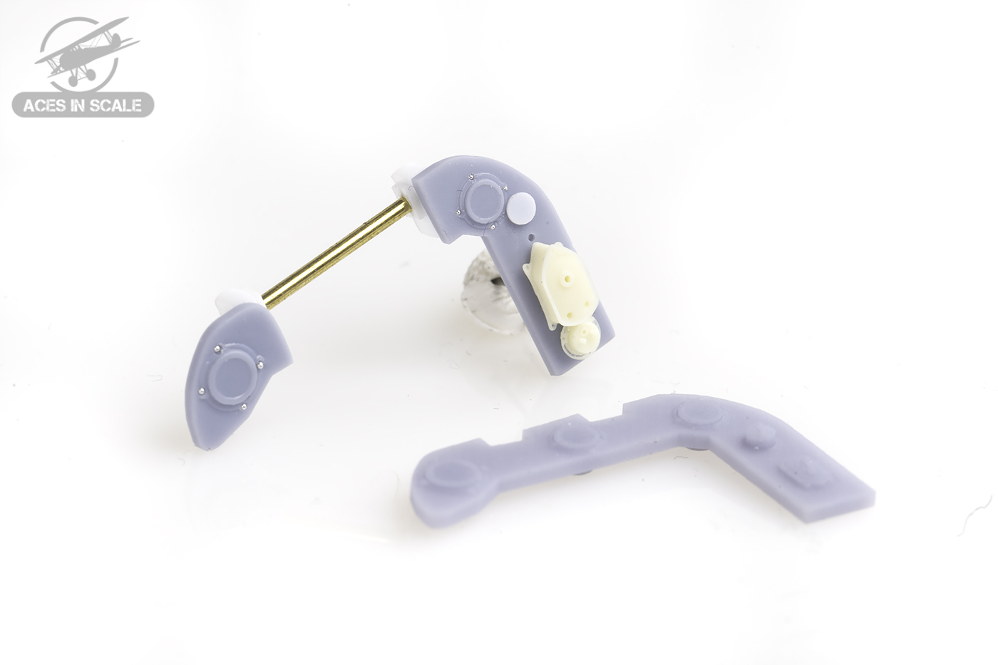

Instrument Panel
The biggest challenge at this stage turned out to be the instrument panel. It required not only cutting but also rearranging the equipment layout and repositioning the gauges.
The starter switch and magneto selector were sanded down - I will replace them with resin parts (you can see them in the photo, though they are not yet complete).
The additional gauge above the starter will serve as an inclinometer.
In the original kit, the inclinometer is placed at the base of the seat - however, I plan to install a compass there instead, which I will scratch-build.
The tube connecting both parts of the instrument panel received guides, which I further detailed with small strips of styrene.
The screws and rivets holding the gauges were replaced with metal alternatives.
In the photos, you can see the modified instrument panel dry-fitted together, with the original panel in front of it for comparison.
All additional elements are mounted on small locating pins - this will strengthen the CA glue joints, making them more durable and resistant to damage.
