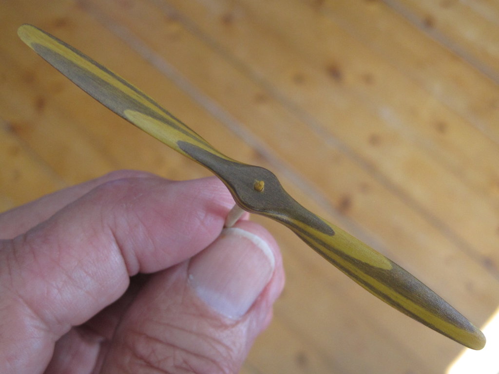

Unfortunately, my Roland C.II is still parked on the side of the road.
But I have at least finished painting the axial propeller for the Fokker D.VII (OAW) from Post #905.
As usual - I swear by this technique - painted with colored pencils.
Then sealed with clear varnish and a little clear orange. Finally, a very thin layer of oil paint was applied - in this case natural sienna.
Now the oil paint has to dry well, then the last step - sealing with semi-gloss varnish, decals, some aging and sealing again.
There will be pictures when I have finished.
Photographed with a flash, the effect of the oil paint is emphasized.
I had always done without oil paint for the propellers in the past, but the effect is better with oil paint.
Servus
Bertl
Translated with DeepL.com (free version)

Offline Umlaufmotor
  • Posts: 1268
Re: Wingnut Wings WNW Roland C.IIa "White 2", Schusta 6
« Reply #138 on: June 11, 2024, 07:19:45 PM »
Thank you very much Rafael and Edo  ;)
@Edo
Hi Edo,
I know this problem, I had it quite often in the beginning.
There are pens that have a slightly softer lead, try it once.
However, they then have to be sharpened more often.
However, you must not press too hard with the soft pencils as this will also scratch the surface.
Another way to prevent scratching is to pull the pencil while painting, as if you were painting with a brush.
If the pen is “pushed”, there is a real risk of scratching the surface.
However, it is also quite possible that the primer will not bond properly with the plastic surface.
Wiping over briefly with isopropyl alcohol before painting works quite well.
The applied layer should not be too thin, it is better to spray over it several times with the airbrush.
And very important: The surface for the colored pencils MUST be matt.
Servus
Bertl

The AXIAL propeller for the Fokker D.VII (OAW) is now completely finished.
The mounting plate (hub) painted with Mr. Metalcolor "Stainless" and dabbed with "Iron" from the same manufacturer.
Then polished and sealed with silk matt varnish.
The color on the hub is unfortunately darker in the pictures than in real life.
After drying, the decals were sealed with a mixture of silk matt lacquer, matt clear lacquer and smoke.
All colors from Tamiya.
"Smoke" is used to filter the somewhat strong colors of the decals and thus break the shine.
The addition of matt varnish is necessary to prevent the propeller from shining like a bacon rind - this would completely destroy the scale effect.
The sharpness of the wingnut decals is unbelievable.
You can decipher almost every letter of the gold-colored propeller identification.
The white numbering on the hub is the indication painted in the field that this propeller belongs to the Fokker D.VII (OAW) with the serial number 2035/17.
This aircraft comes from the first production batch manufactured by the Ostdeutsche Albatroswerke (OAW).
The D.VII was delivered to Jasta 66 and assigned to Ltn. Rudolf Windisch.
The aircraft was lost on May 27, 1918 when it was shot down.
Here the prop (center) ready for assembly on the model.
The AXIAL prop with the white spinner belongs to a Roland C.II and the lower one - with the rounded, brass-tipped leading edges - is a Niendorf propeller for a Hansa Brandenburg W.29
Interesting:
All three propellers were painted with the same colored pencils, i.e. always the same combination of colored pencils - only the primer was a different shade each time.
The AXIAL for the Roland C.II "Late" was painted with Mr. Hobby H318 "Radome", the AXIAL for the Fokker D.VII (OAW) with Mr. Hobby H34 "Cream Yellow" and the Niendorf for the HB W.29 with Tamiya XF-15 "Flesh".
Servus
Bertl
