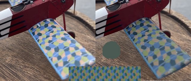

Hi Fred, just as a theoretical exercise I ran part of your photo through Photoshop and applied a transparent layer of olive green (the round color swatch in the center) over the lower wing. At the bottom is the Aviattic lozenge, and it actually came out looking pretty close:
Surprisingly, it didn't change the color of the rib tapes too much. Might be worth experimenting on some spare lozenge decal, if you have any left.
Now that is a cool trick!  Well done. I’ll have to try using that color instead of the brown.

That approach with green looks like it might work.........
