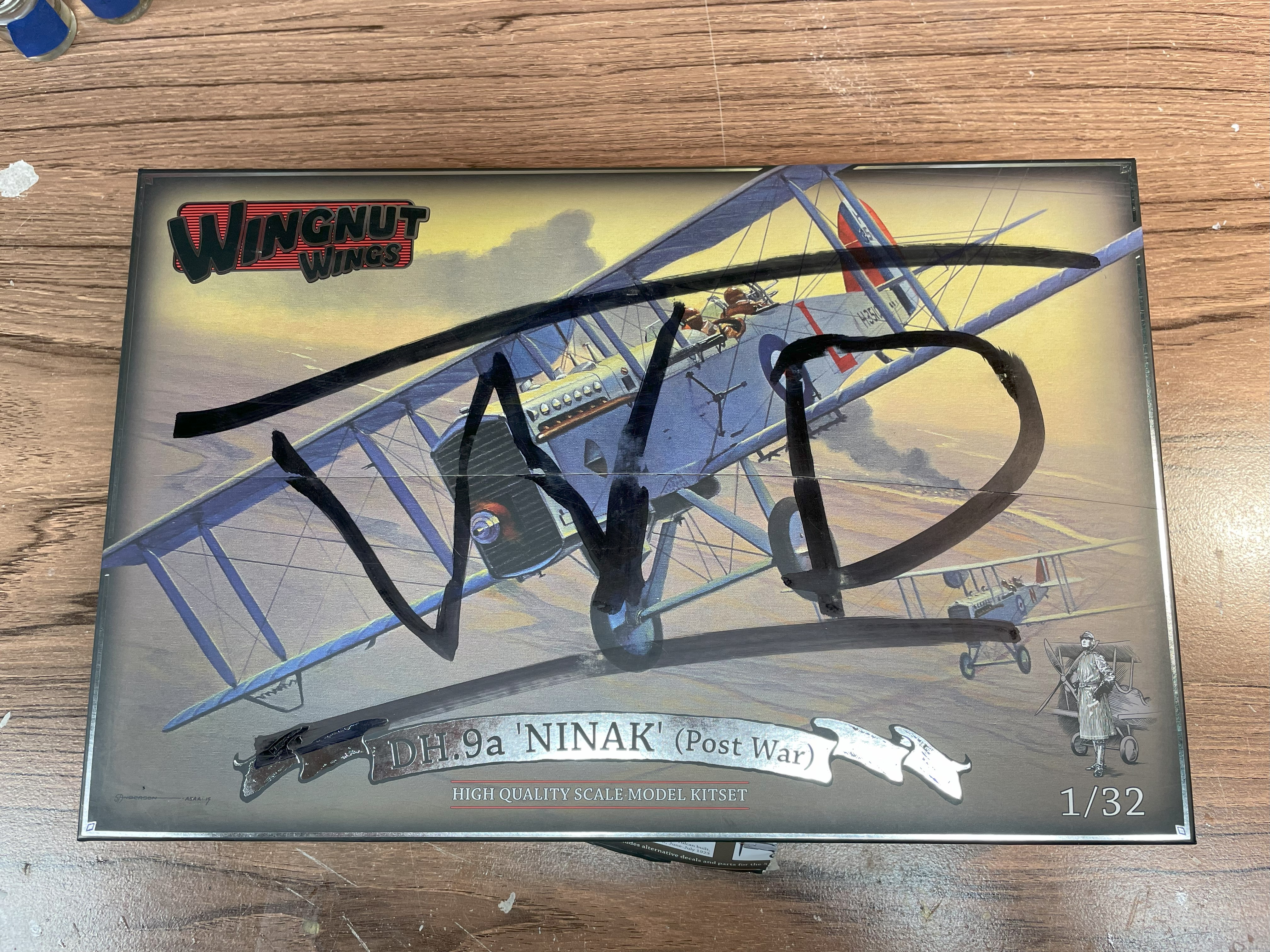

I’m starting my first WW1 model in a while.  My last one was a few years ago, and there have been a lot of life things and a few non-WW1 models in the interim.  I’m going to build the WNW post-war Ninak (which I guess technically isn’t WW1, but it is almost).  I purchased a few kits during the water damage sale around 10 years ago, and this is one of the last of them.
I’m a little torn between schemes.  I’d like to do E8650 from No 84 Squadron (pictures in Eric Larson’s amazing log https://forum.ww1aircraftmodels.com/index.php?topic=10490.0).
The Pheon decals are long unavailable.  I need to make masks or decals myself of the serial numbers on the fuselage (black), tail (black on white background), and JAN in white letters on the fuselage.  The JAN was in honor of Group Captain Arthur Longmore’s daughter Janet, and I’d like to modify slightly to JEN (not historically accurate, but my daughter is Jenny).

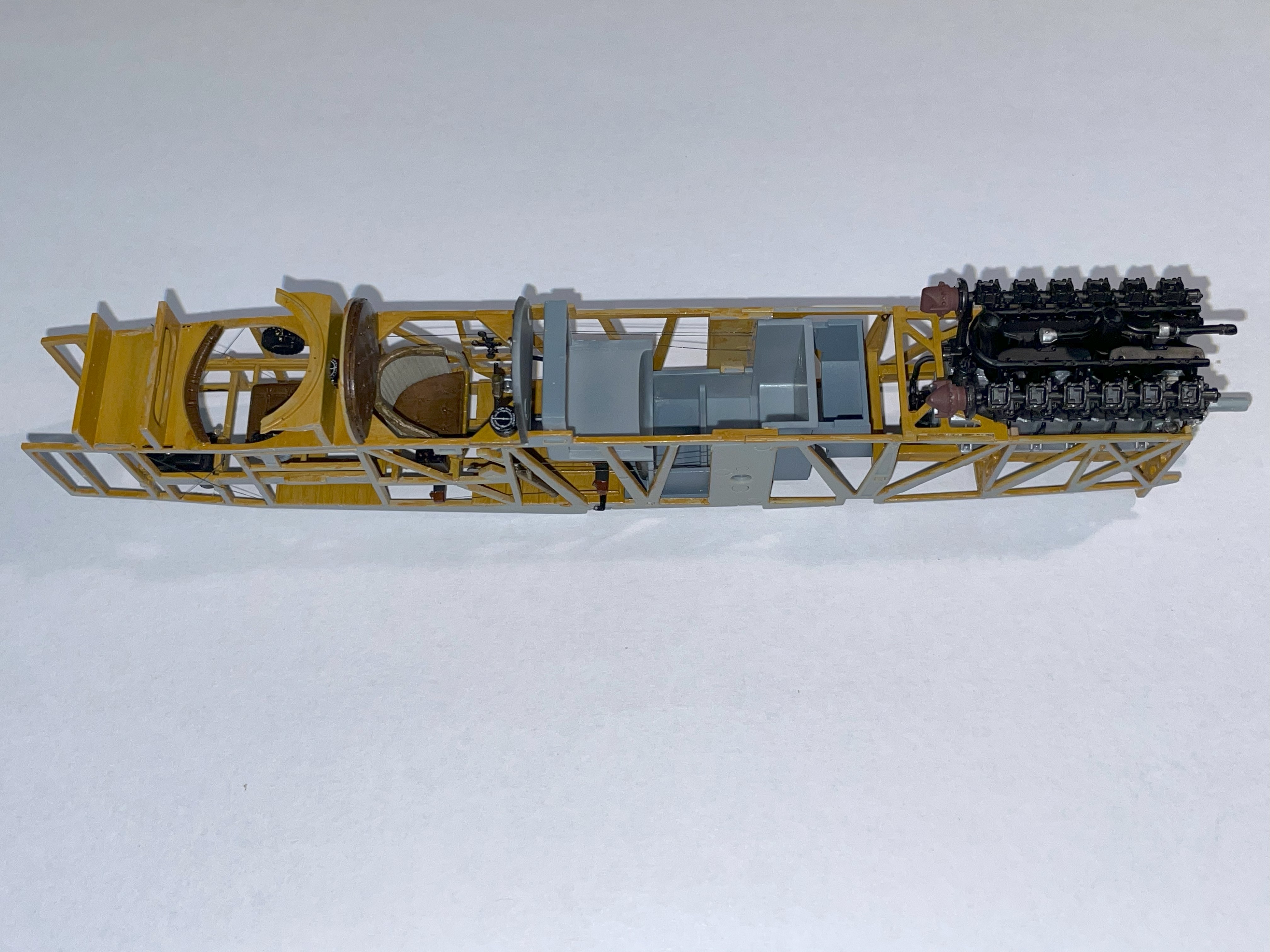

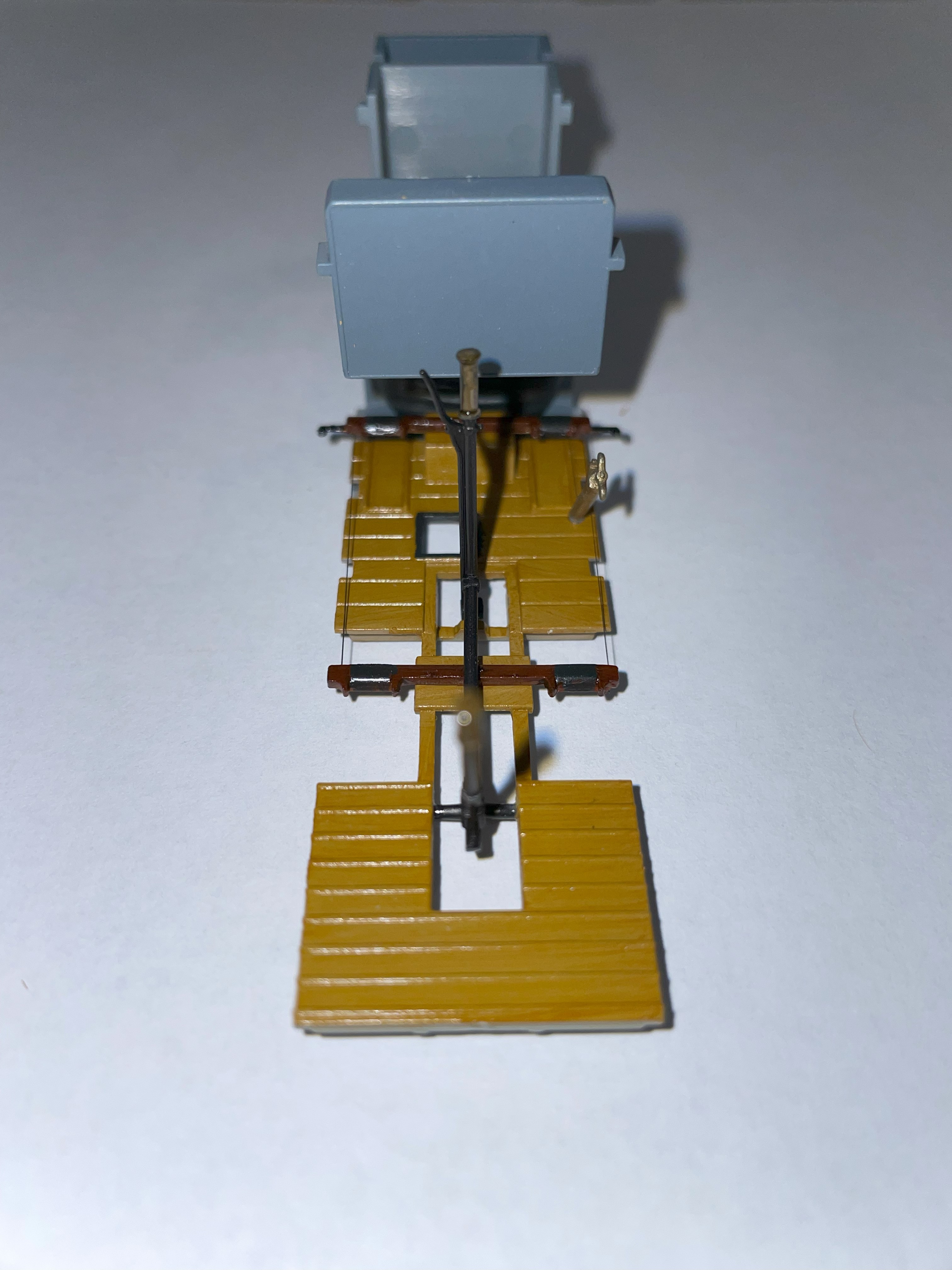

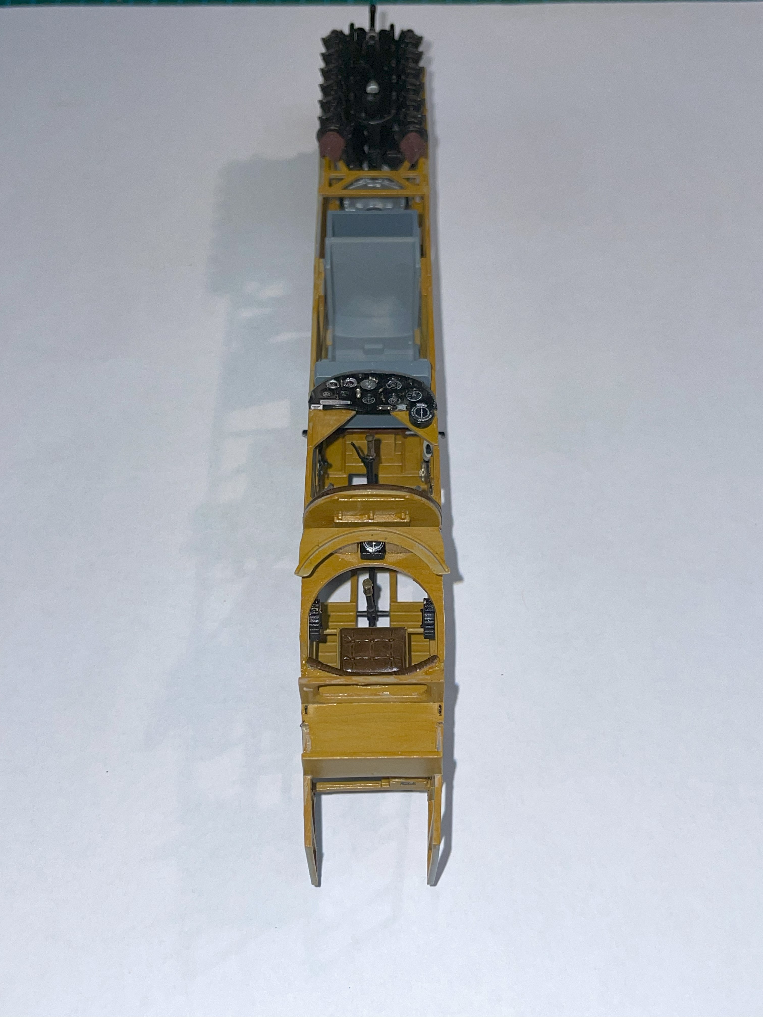

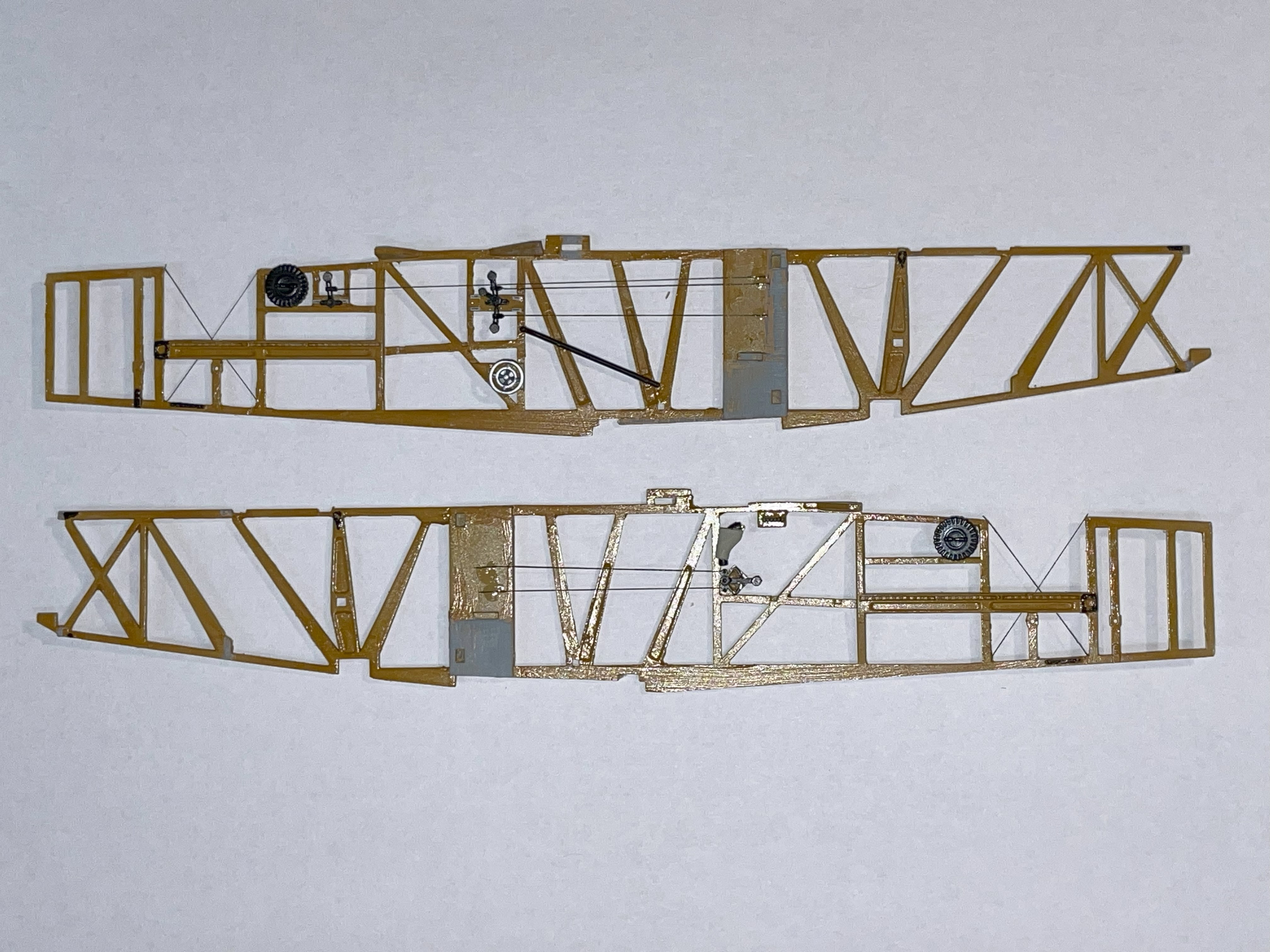

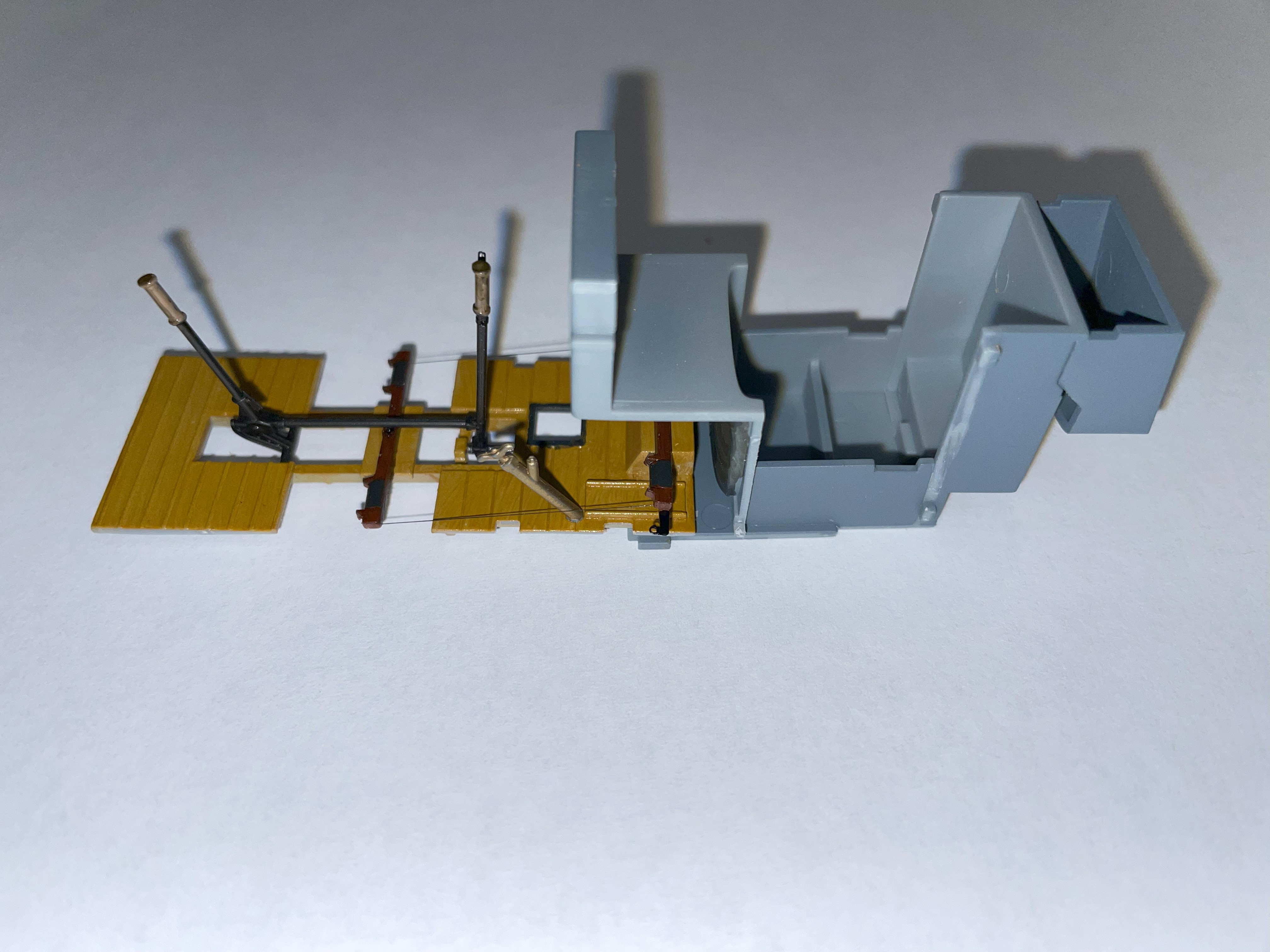

At last, enough progress to post some pictures.  I did the woodgraining and started to assemble the cockpit floor and sides.  I’d appreciate comments about things I could do better.  Some of my substantial blocks of time in the workshop happen after I’ve worked overnight.  It feels great at the time, but when I come back later, the work is never as nice as I thought it was at the time.
Most of the woodgraining was done with yellow ochre and raw sienna winsor and newton alkyd oils over Tamiya desert yellow then coated with Tamiya clear yellow.  The other models that I have built were mostly darker wood.  I’m much happier with how my dark wood comes out than this did.  Next time around I plan a little more brown and less yellow/orange hue.  I wanted the grain to be subtle, but this is a little too much so.
Next step will be a coat of clear flat or light sheen to knock down the gloss.
The control levers are from the HGW set.  I was going to use their instrument panel until I realized it was a different configuration (maybe for the wartime Ninak?) and I didn’t have all the decals for it.  I’m largely focused on the areas that will be visible, so did not run the control wires all the way to the engine/radiator.  One of the victories this time was I've finally had some luck touching up where I get paint on the wood grain.
I’m not sure which interior details went with E8650 – the color scheme seems to come from a single picture. I’m using details from scheme B with the kit, which is another RAF Iraq airplane from the same time period (1923-24) and will be the fallback if I can’t get the masks working the way I want.

Excellent Start! The interior is looking good!

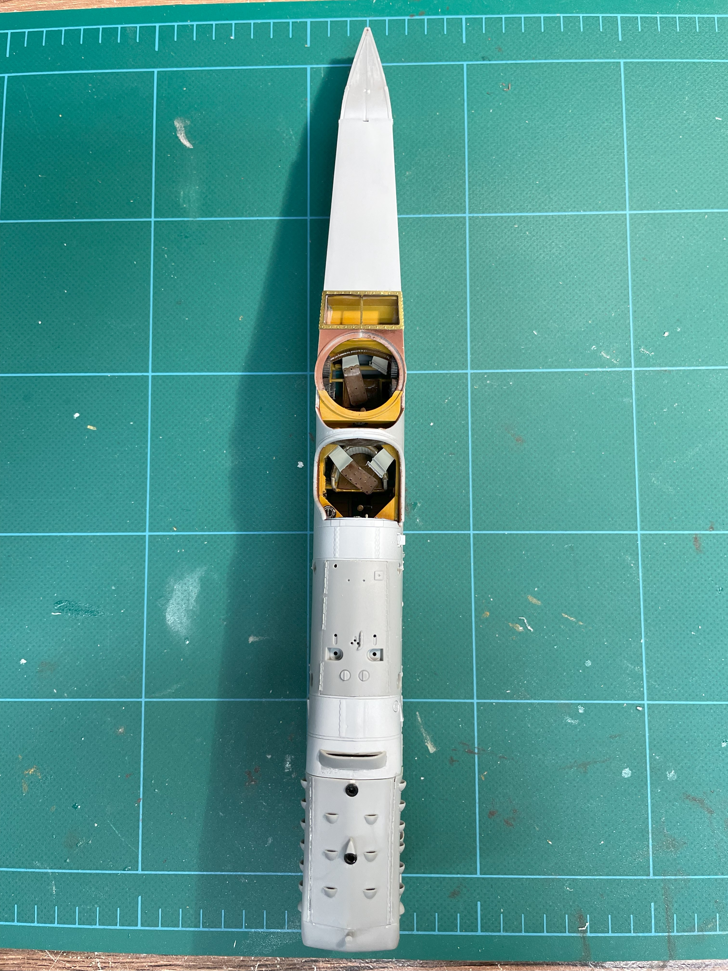

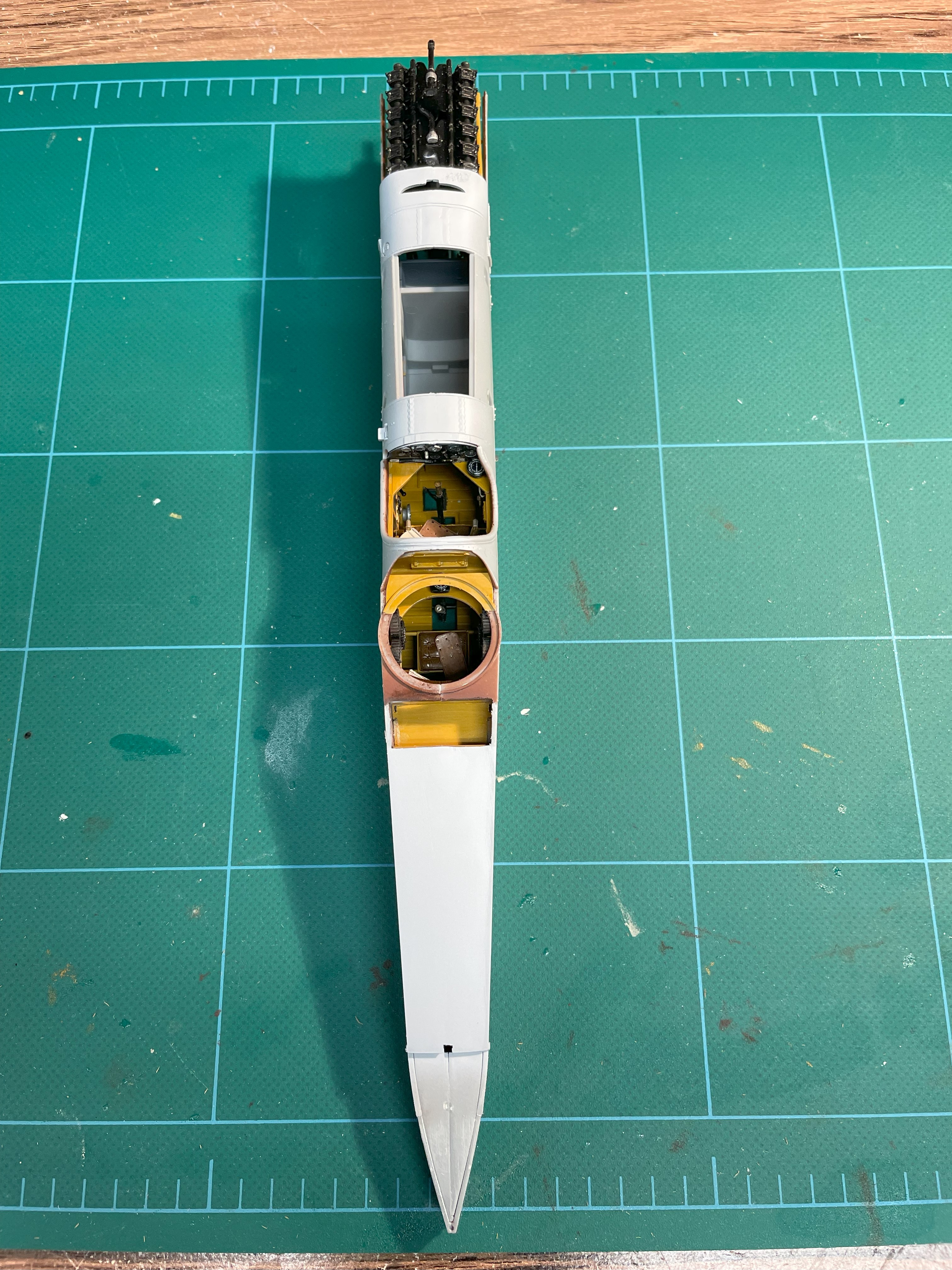

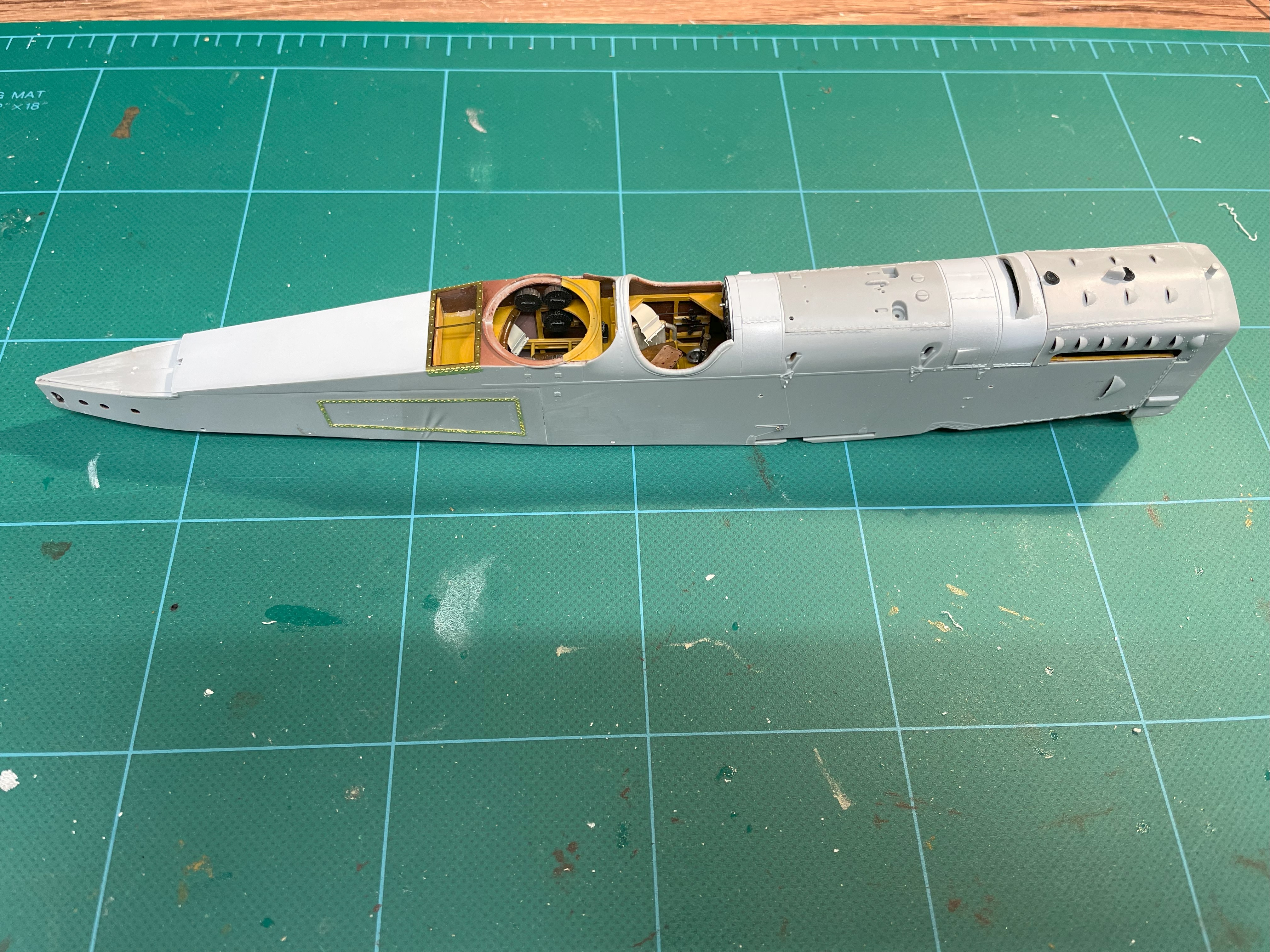

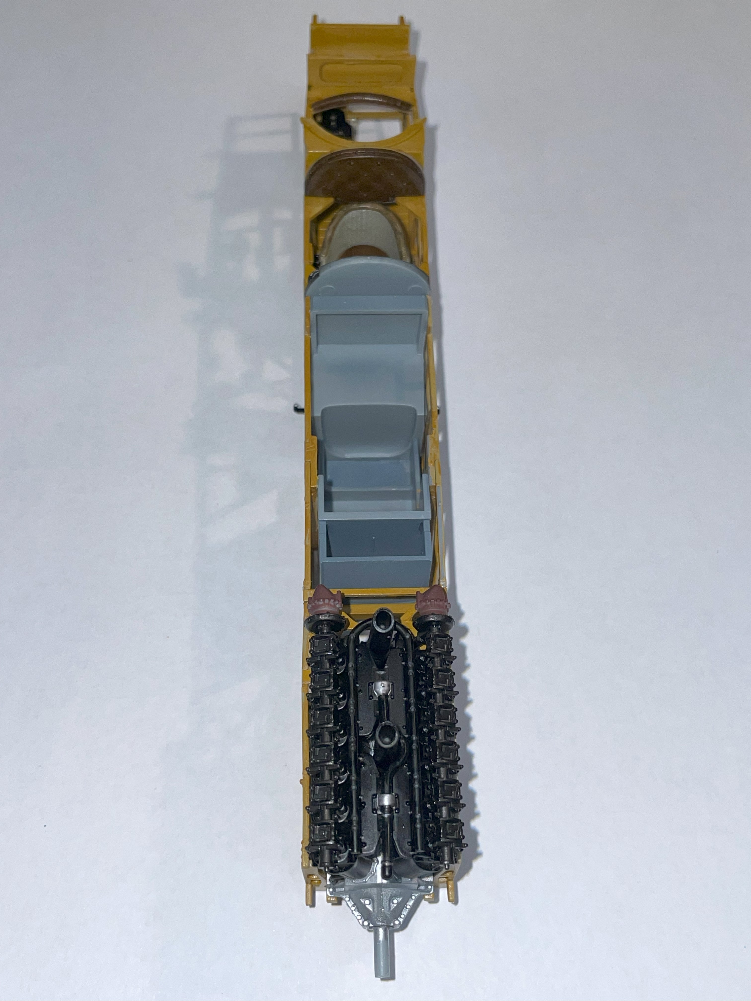

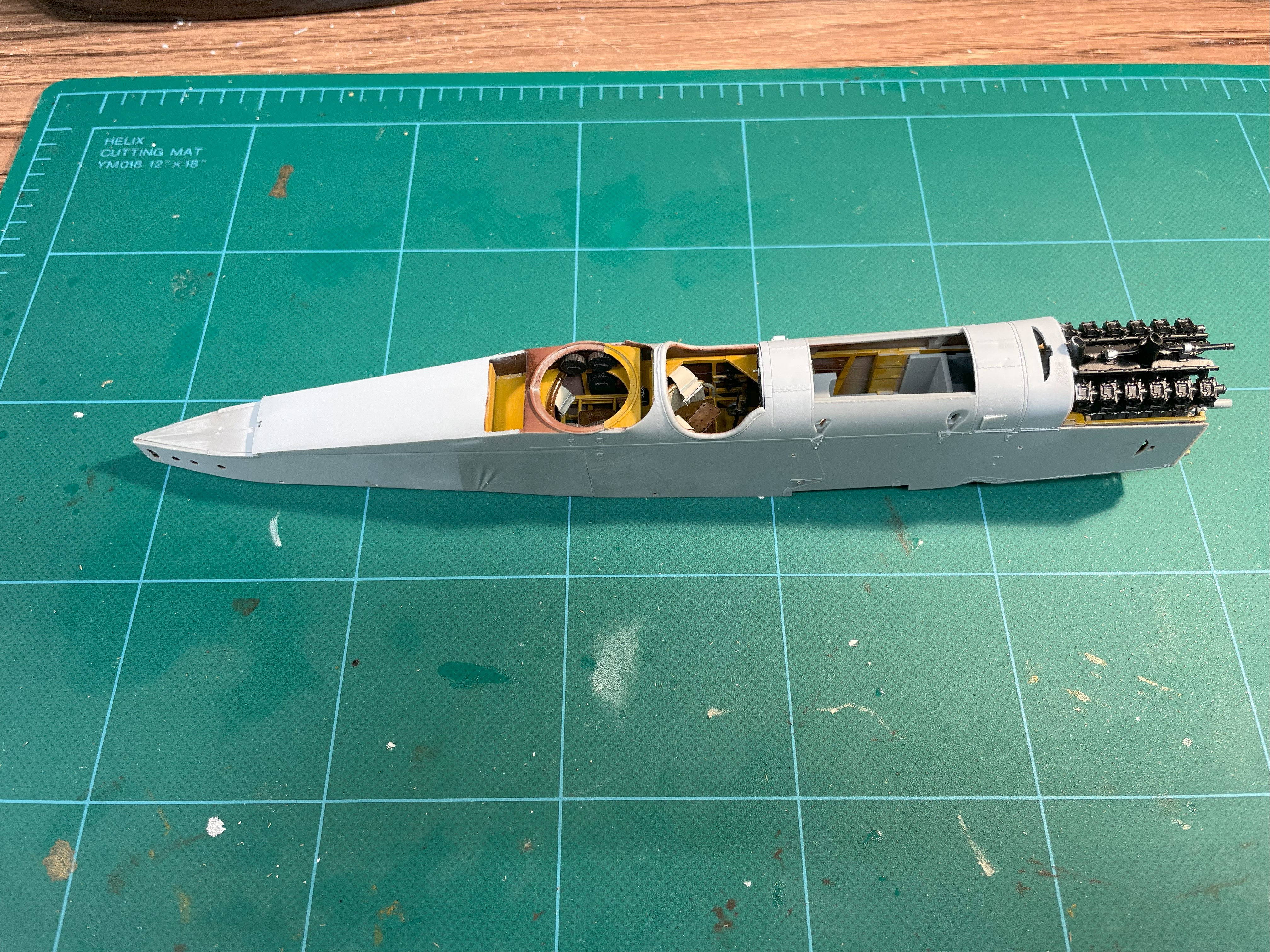

RAGIII and Dutch – thanks for your comments.  I have not been very good about keeping the log up to date, but have been plugging away.  I’ve been working irregularly because of my work schedule and a really good vacation, and went through a period where I was frustrated and didn’t really want to post pictures.
I was particularly frustrated by my woodgraining on the interior.  I don’t like the color it came out, and ended up with some thick oils in corners and crevices that I needed to clean and patch. I do better woodgraining large, flat surfaces where I can use a sponge, and don’t get the same results on the framing where I use a brush.  Also not happy with my color choices for light wood, and wish I had planned ahead better so I didn’t end up with two colors of wood in the storage compartment.  I switched to fast drying alkyd oils and was able to figure out how to touch up in a way that only set me back a day, so I was happy about that.  Also learned that my frustrations about picking out detail with brush painting improved with different paints (Mr Color brushes way better than Tamiya).  My detail painting on the engine (which will be fully covered) came out way better than on the instrument panel.
I’m a little happier now that the fuselage is buttoned up.  I’m also much happier with my seam filling, which only took a few iterations of sanding and filling.  I was pretty careful when assembling the interior to making sure I scraped glue and paint so I could close the fuselage without big gaps.  This worked way better than usual for me, except I ran into a problem that I couldn’t figure out over the curved cushion between the pilot and observer seats.  I ended up with a gap, but was able to fill it with superglue and sand it so the gap isn’t too visible.
Given my dissatisfaction with the interior, I thought I would turn this into a learning experience.  I don’t have a lot of pictures of the plane I am modelling (mostly just the cover picture and side view in the datafile), so decided to try opening the panel to add the storage compartment and added the photoetched stitching.
