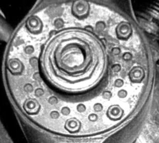

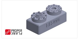

Back from a weekend in the wilds of Maine, and picking up on the Nieuport project. I'd thought about trying to scratchbuild one of the hideously complicated French prop hubs, but after a couple of abortive attempts I realized it was beyond my skillset and decided to order one from Alex at Proper Plane in Kiev, along with a couple of sets of turnbuckles.

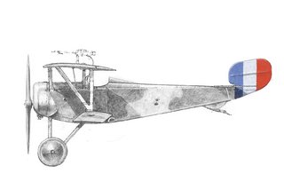

I was also able to work a bit on my profile, which I'm doing to figure out the color scheme. It's mostly at the grayscale pencil stage at the moment, needs a lot of research and even more work :-P

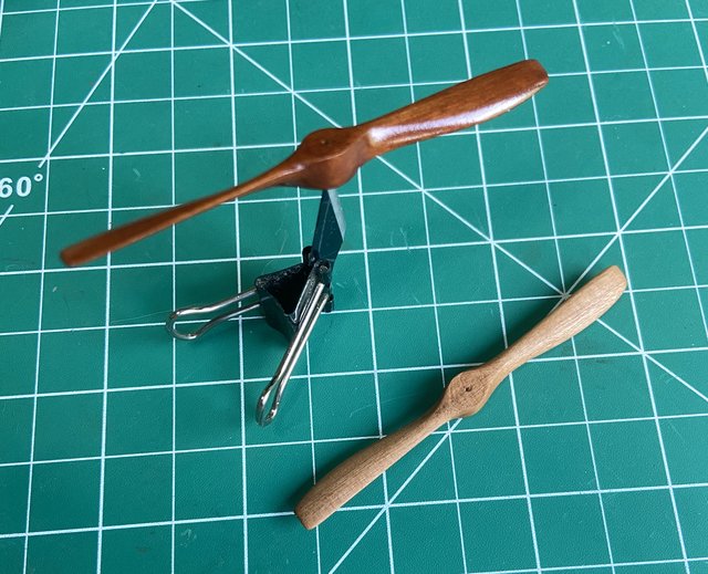

Dave this is some incredibly thorough work and you seem to be having great fun doing it too. Your prop carving is excellent and I would have been more than happy with the second one from the bottom. Your next, I feel confident, will be absolutely perfect.
Using the aftermarket prop boss is a good choice. The proper plane ones are excellent and having spent far too much of my life scratching one in 1/32 I can honestly say it was more work than it was worth. Especially as the alignment is far from perfect!

Thanks, Richie, I like to scratchbuild things when I can, but fabricating 5-6mm turnbuckles and hub plates is a bit much!

Your props are improving with each new version although like Richie I would accept a few of them  8) I think going with Proper Plane Hubs and buckles is a good decision!

Thanks, Rick, in addition to avoiding a potentially project-killing nightmare, I decided the better part of valor was to just buy 'em. And besides, Alex seems like a nice guy, and it's nice to feel like I'm supporting the hobby... especially given the current conditions in Kyiv.

More work on the props, the upper one is the one I'm using to develop a finish that approximates the pigmented shellac (still too red, working on the color), while the bottom represents my best attempt to date at capturing those sexy Levasseur curves. The bottom prop isn't tinted yet; before applying the copal varnish I'm filling the grain in the mahogany with the old woodworker's trick of applying a drying oil (Watco Danish, in this case) with 500-grit sanding film. The extremely fine wood-dust gets incorporated into the oil, and after it dries you repeat the process as many times as necessary to fill up the open grain and leave a smooth surface for the varnish.

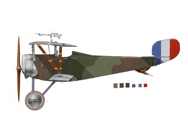

I'm also working on the profile, and looking for photos of the Esc. N.37 chasseur I plan on building on the website of the Musée de l'Armée Invalides in Paris. Having only seen it in black and white it's tremendous fun to see what the little bird might have looked like 107 years ago... the colors and camouflage pattern are strictly provisional at the moment, much research still to do on that front.

Looking good so far! But if you get so deep into propeller wood colors, one of the even more crucial question should be: Are you a two tone or a four tone camouflage guy?  :D
