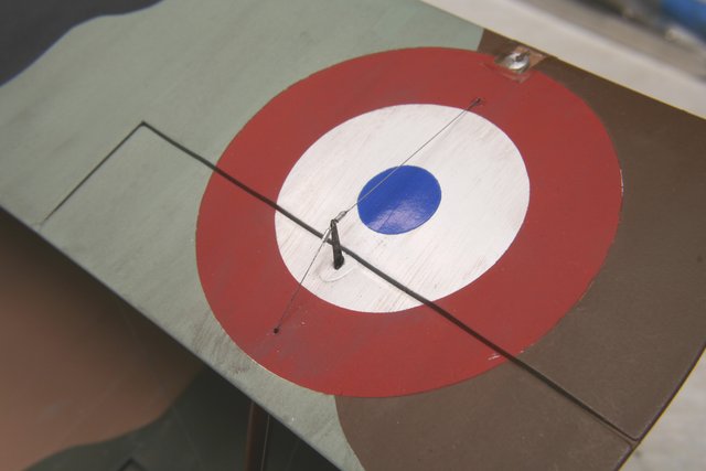

Re: 1/32 Roden Sopwith Strutter
« Reply #138 on: August 25, 2023, 09:19:29 PM »
Any issues that you can see with the strut attachments?
I'll be evaluating that next.  I did pin the cabane struts to the top edge of the fuselage, as there is no solid mounting points there.  The holes in the lower wing are much bigger than the pins on the struts, so while that gives some wiggle room, it does not make for a solid  attachment point.  The pins in the struts are longer than needed, as well, but that's easily fixed.

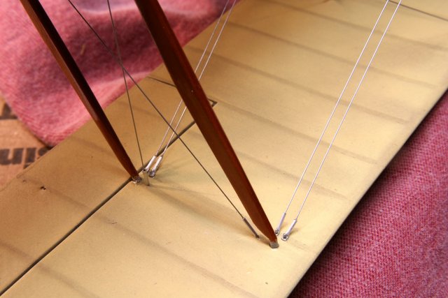

Those rigging attachment points are incredible !  Really impressive work.

« Reply #144 on: August 29, 2023, 03:16:47 AM »
Beautiful work Ken, your method for making rigging attachment points looks so much better than wire loops. I can see that being copied a lot in the future, I for one have taken notes!

« Reply #145 on: September 07, 2023, 09:05:13 AM »

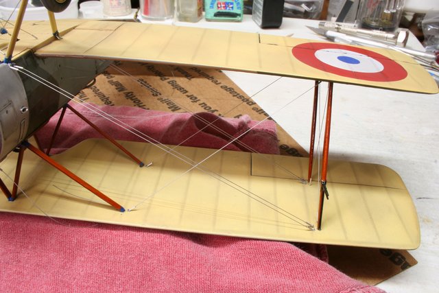

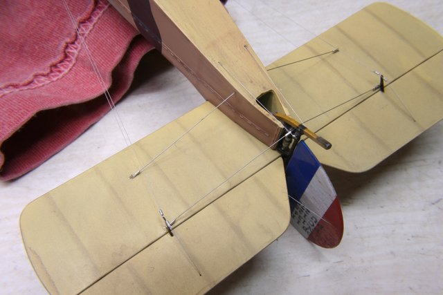

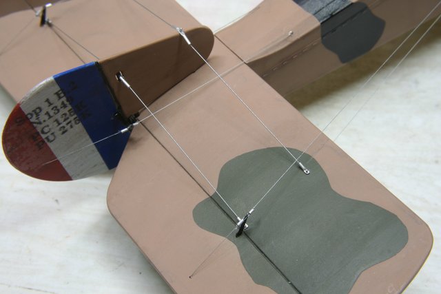

Well, I'm finally working through the rigging.  I had ordered some fresh CA to finish the job, so there was a wait.
Most of the tubes were glues in at the right angle.  Only a couple are off slightly.  I was able to glue the wires in with enough tension to keep them straight.
Finishing the rigging and the control cables is next, then final assembly and touch ups.

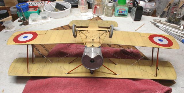

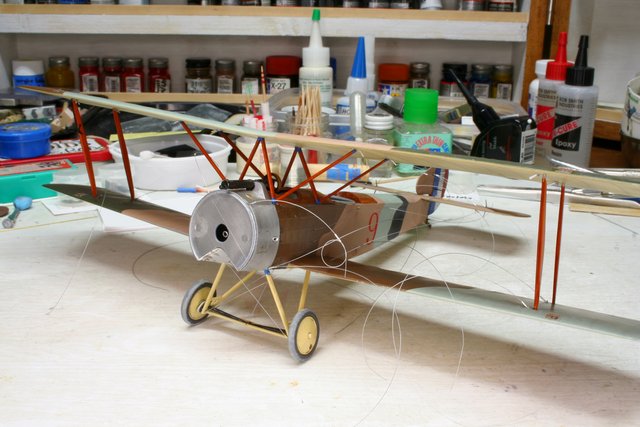

« Reply #148 on: September 10, 2023, 12:53:56 AM »
Thanks for the comments, everyone.  More rigging pictures.   The rigging is done now.  Final assembly of the engine, cowling, and rear machine gun is next while I wait for the oil paint on the prop to dry.
Thanks for looking.
