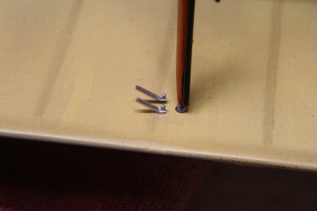

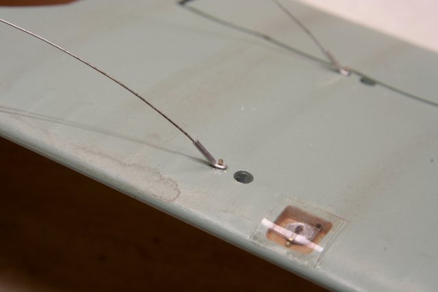

I have glued the cabane struts to the fuselage and have been pondering the rigging.  I am trying a new technique here, where I run monofilament through a 0.6mm aluminum tube and flatten it, trapping the mono, and trimming it off on end.  Then drilling a 0.011" hole through it and running a monofilament 'bolt' through it, supergluing it into the wing.
Don't know how strong this will be, but it looks more accurate than eyelets.  Also, very tedious.  We'll see how this works out.
Re: 1/32 Roden Sopwith Strutter
« Reply #124 on: August 21, 2023, 04:47:07 AM »
That really looks like the real attachments. I hope it works well for you. Did you use the kit Acetate for the clear area over the pulleys? Sorry if I missed something  8)

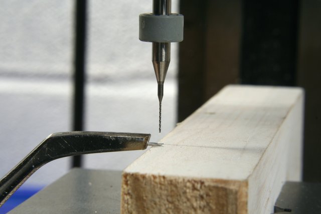

The attachments look great - what are you using to drill the .011" holes, and how are you doing it without breaking the bits?  .011" is smaller than a #80 - must be very fragile.
« Reply #126 on: August 21, 2023, 06:29:44 AM »
Hi Rick, yes I used the kit acetate for the pulley covers.  I cut them out of the excess part of the acetate.  I used 5 minute epoxy and taped them around the leading edge of the wing.
The holes were drilled with carbide micro drill bits.  I first tried 0.0098", but the holes were a bit small to get the 0.007" lines through them, so I then went to 0.011".  For these sizes, I always use my bench top mill, which keeps them straight when drilling and used a high speed.  This method keeps them from breaking.

Hi Ken,
That's an interesting approach to rigging.
I'm assume these will be fixed in position on the model parts before assembly.
If so, I imagine it will be tricky getting them angled correctly, so that when the parts are assembled, the end fittings and the line will be aligned.

I have a Sherline mill that I use for scratchbuilding model ships.  How do you clamp the small tubes when you drill?
« Reply #130 on: August 22, 2023, 01:19:07 AM »
Hi, all.
Mike - yes, aligning the tubes to the correct direction is a challenge of this method.  I just make the best estimate I can.  I'm anchoring one end of the line as pictured and the other end will be another tube (hopefully at the right angle, also) into which I CA glue the end of the monofilament, holding the line as tight as needed to completely straighten it.  If it's a little loose, I can tighten it using a hot soldering iron held close to the line, but of course, this presents risks also.  I'm also flattening the end of the monofilament slightly with pliers to provide a non-round shape that should increase the holding strength of the mono and keep it from being pulled out.

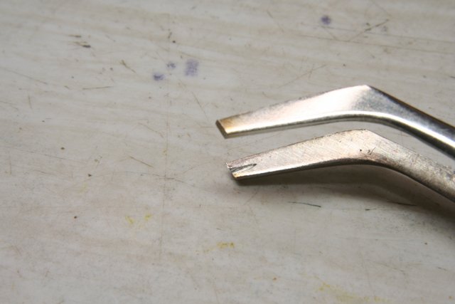

davec - I don't hesitate to modify cheap tools to accomplish a task.  In this case, I cut a groove using a Dremel cutting wheel, into one side of a pair of tweezers to be able to hold a round object.
The end of the tube was flattened, which prevents the drill from wandering when drilling.  I hold the tweezers as still as possible, resting on the wooden block under the drill and then lightly run the drill down into the tube.
Hope this explains how I'm doing this.

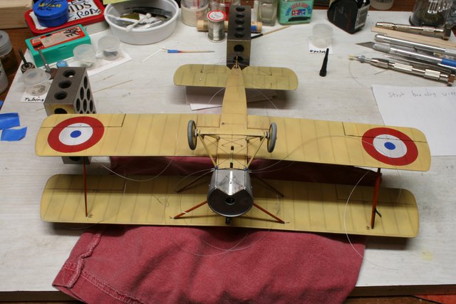

« Reply #134 on: August 25, 2023, 08:53:51 AM »
Quick update.
I got all the rigging tubes mounted into the upper wing.  Pull tests are indicating they will be strong enough.
Now for the significant step of getting the upper wing on.  The front struts are just placed in position for alignment while the glue on the cabane struts is setting.
Next, the struts will be added, followed by the rigging.
