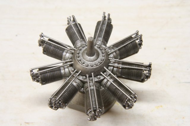

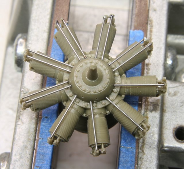

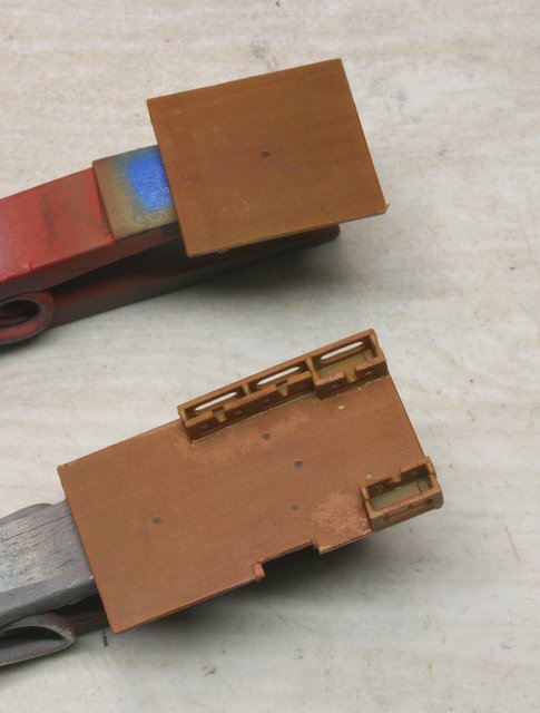

The Vector engine builds up nicely.
Not quite done with it yet.  I frequently skip around in a build to avoid burning out on it.

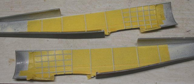

The interior starts off with a coat of CDL colored paint, followed by masking to paint in the wooden framework.
So, I'm just getting started on this.  Tally Ho!

Great start! Do you cover the entire interior with tape and then cut out the framing or mask between each frame?
Re: 1/32 Roden Sopwith Strutter
« Reply #6 on: May 27, 2023, 02:52:14 AM »
Thanks for seeing me off to a good start everyone.
Steve - I masked over the entire interior and cut out the framing, like it was a framed canopy.  This worked well on a Sopwith Pup I did.

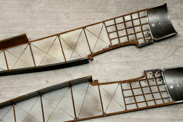

Update - more work on the interior
After painting the wood color on the framework, I sprayed a flat lacquer, then rubbed in some pastel chalk for a dirty look.  Oil stains added.  Then glued in the bracing wire.  This is 0.008" beading wire that was stretched to straighten and stiffen it.  Added brass tubing for the turnbuckles.  This picture has too high a contrast.  The wood color is lighter.
Floorboards were painted wood color and a woodgrain decal was applied.

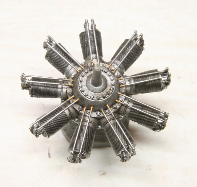

Finished painting on the engine.  Needs spark plugs and wires.

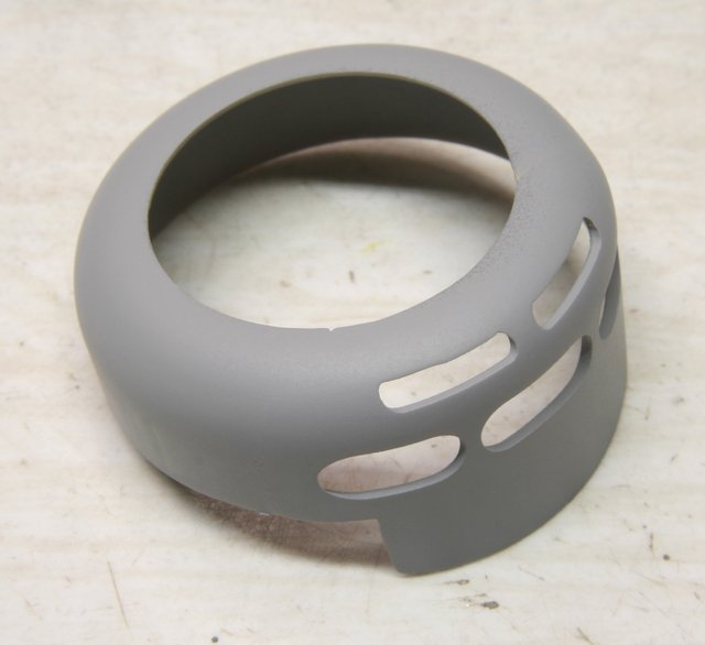

The cowling surface was quite rough, so it got primed, polished, and primed again.
Thoroughly enjoying this build!

The Masking and painting of the wood worked really well. The engine is gorgeous. I Love the dirty look on the interior. Looking forward to more awesome work on this one Ken!

That engine...oh for a "chef's kiss" emoji!
