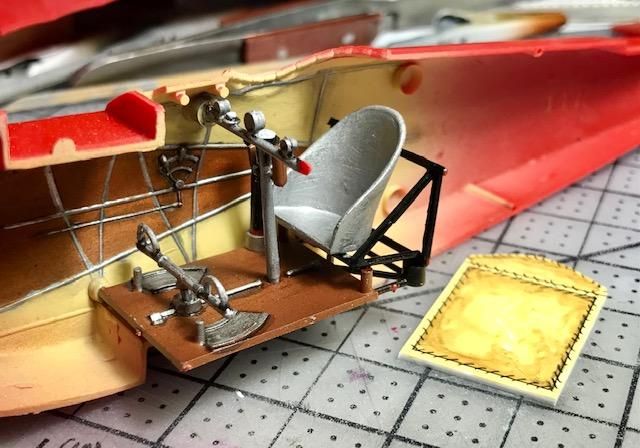

I have for years thought it would be a great idea to build these three kits, (now four) in the original kit markings but with just some scratched tweaking here and there. Enhancing the kits but still keeping them the old Revells we all grew up with. The Camel and SPAD are easier because the original markings for those kits are correct, for the Dr1, we have a problem.
Molded in bright red plastic with no painting required, re-boxed in later years but with better decals. Originally, it was FI 102/17 in red and we know MvR never flew 102 like this in red. 102 was an FI and light blue with streaking finish. I wanted to use the maltese crosses as that was in the first kit. Newer issues gave me the 425 I needed to use the maltese crosses if I cut away the excess white panels. Problem solved, close enough.
I got the kit off Evilbay for cheap and was thrilled to find a copy of an Ed Boll article on how to improve the kit. Don't know the date but would like to find out.
I was born in '56, it's as old as me. The wings were flimsy so I used Tamiya thick slathered around and let them set up over night making sure they would stay straight.
The Boll article says the prop is fine but I thought I could improve.

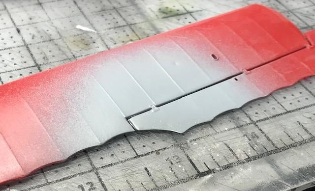

I corrected the right aileron with some .10 styrene and putty by tracing the left.
Boll would have me swap the throttle and fuel pump as Revell got them backwards but I left them as is. I did do the cloth screen behind the seat as suggested.
I will add belts from yogurt cup foil and a seat cushion.
Engine next.

Excellent work - great job on the prop and aileron

Sharp interior work Allan!   Nice fix with the ailerons as well.

That looks beautiful.  I appreciate the detailed look at some corrections, as my many 1/72 Revell Dr.Is share the same idiosyncrasies.  In particular, that aileron.  I was resigned to building many many kits with the port aileron shaved back to match the stbd side.  That tracing is a fix I can implement in 1/72, although the interior details are too small for me to bother with.
