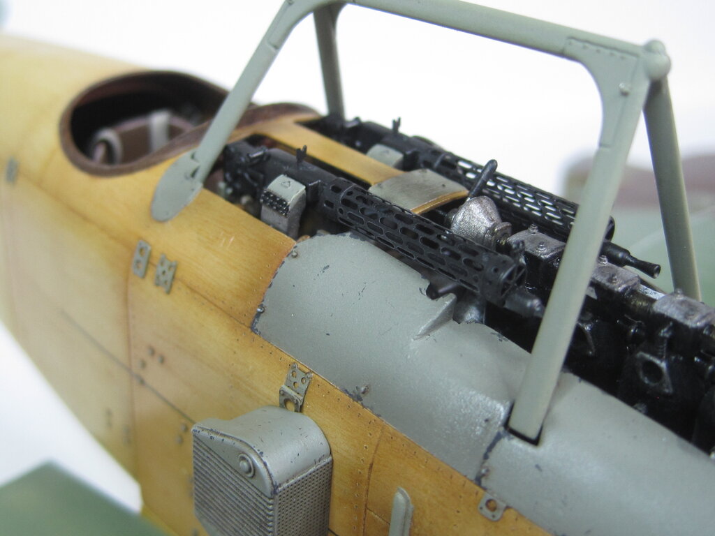

The etched sheet metal fittings are painted, I had to make some fittings myself because I either lost them or used them elsewhere during the long time the model was lying around.
Anyway - with 0,10mm Evergreen plastic it works quite well.
I also took this opportunity to make the drain cock for the fuel tank.
These are two thin aluminum tubes (0.3 in 0.5mm outer diameter each) and a hand toggle made from etched parts.
The maintenance flap is an etched part - the opening for the fuel drain cock was made with a drill and file.
Servus
Bertl

Now the sheet metal fittings:
These were fixed to the model with white wood glue and adjusted.
Then glued properly with superglue.
The two Windhoff ear radiators are also fitted in position.
Servus

Offline Umlaufmotor
  • Posts: 1268
On the original, a thin wooden spacer was fitted between the curved fuselage fitting and the straight upright metal fitting of the radiator.
On the model, this was represented by a small piece of Evergreen plastic cut to size.
"German Grey" from AK Interactive (3Gen) was used to show slight paint flaking on the sheet metal parts - including on the two radiators.
Servus
