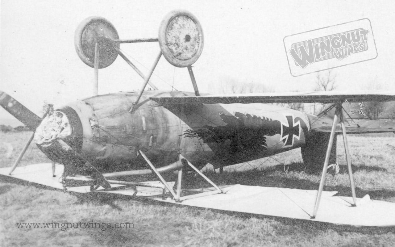

The second picture clearly shows the panels mounted lengthwise from the underside of the nose to the undercarriage.
A typical feature of the first D.V series.
According to surviving original photos, Albatros switched from longitudinal to transverse panels between D.2065/17 and D.2078/17.
It is not possible to be more precise on the basis of the (currently) available photographic material.
Unfortunately, I do not have any original construction descriptions from Albatros that go into more detail here.
WingnutWings did not include the very early D.V series in the kit.

This sentence caught my attention as I am researching this very topic:
Quote
Albatross switched from longitudinal to transverse panels between D.2065/17 and D.2078/17.
I am very interested in which photos you based this conclusion on? In which publication did these photos appear?
Offline acewwi
  • Posts: 196
Quote
[/quote]
Dear Richard,
D.2065/17
http://www.wingnutwings.com/ww/v98C7274C/www/products/model_kitsets/32701/archive_photos/Albatros%20D.V%202065~17%20Jasta%205%20(Greg%20Van%20Wyngarden)%20(2).jpg
D.2078/17
http://www.wingnutwings.com/ww/v98C7274C/www/products/model_kitsets/32009/archive_photos/Detail-nose,%20Albatros%20D.V%20D.2078~17.jpg
