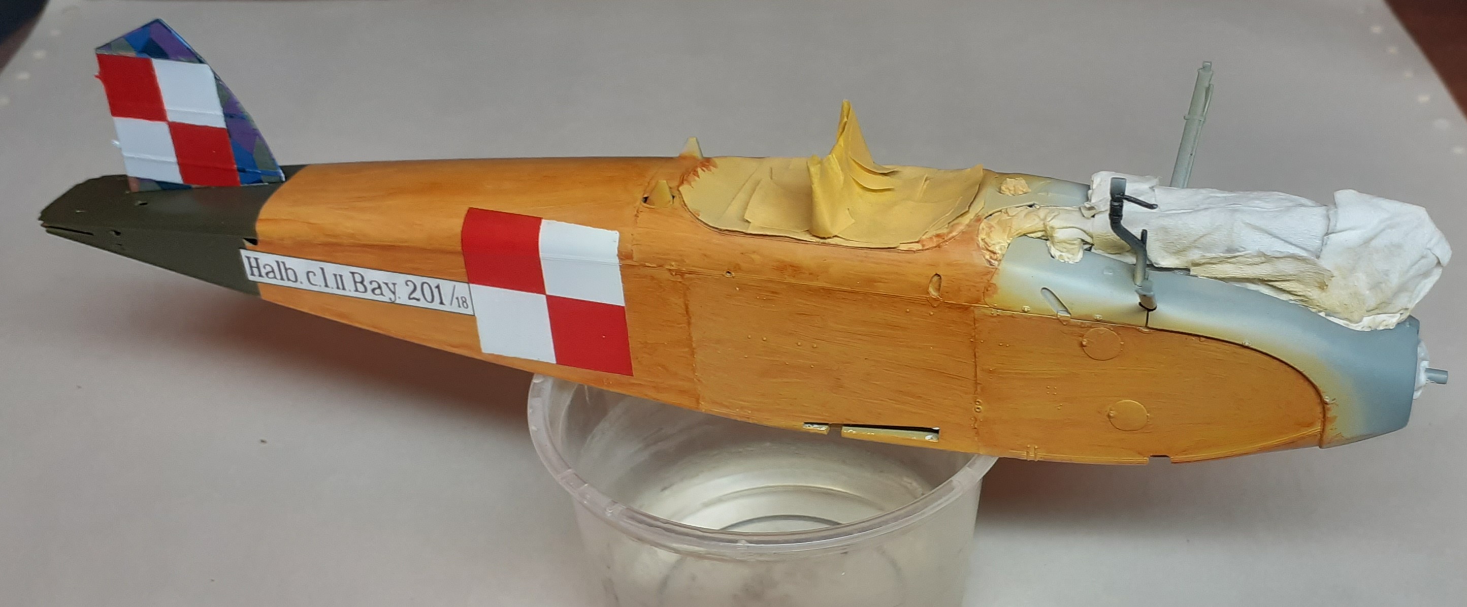

Holidays, hot weather... the build is very slow but here is finally some progress to show.

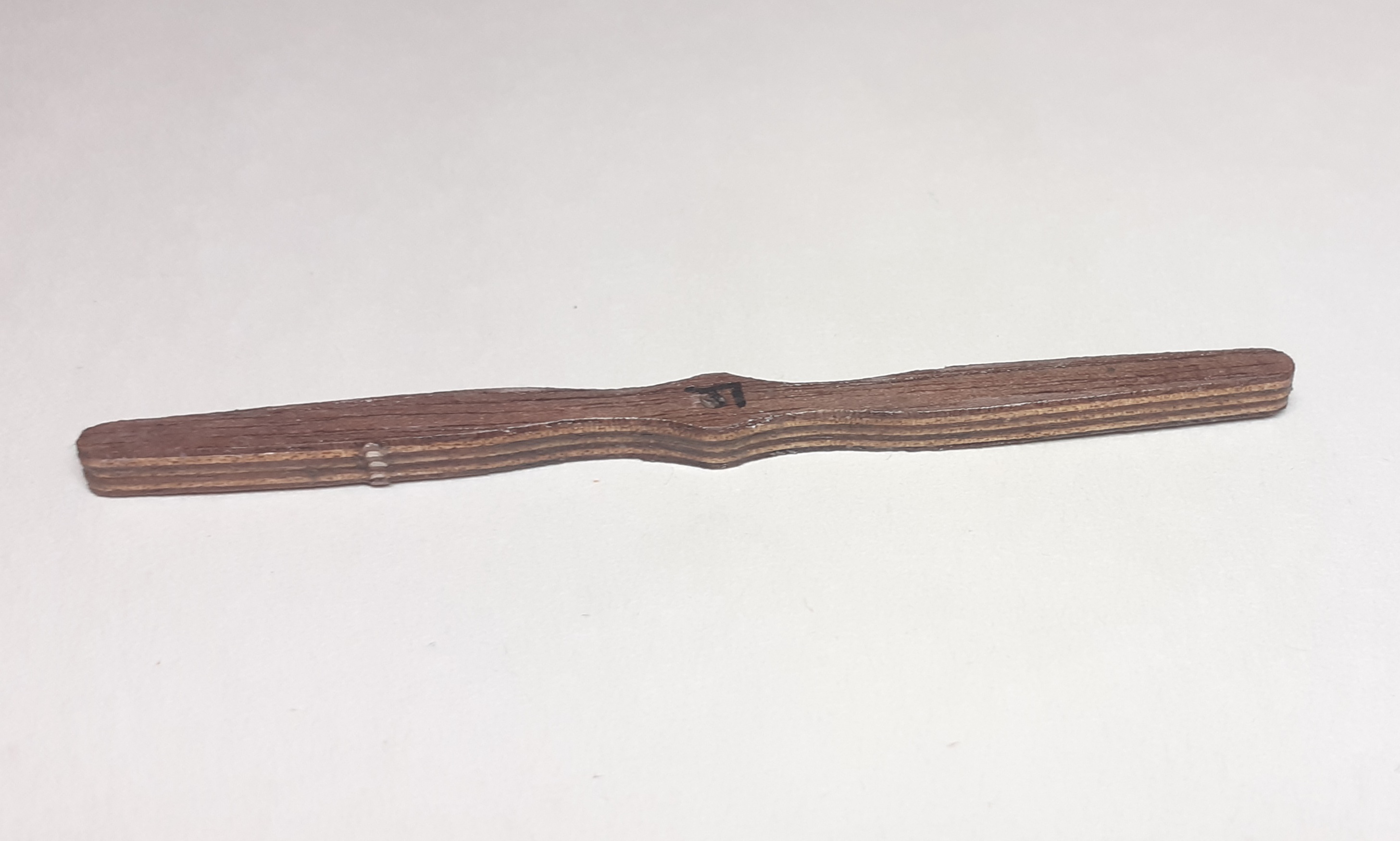

The decals with markings applied. And the veneer layers from Kotebi for the wooden Axial propeller glued together and sealed with CA glue - ready for carving.

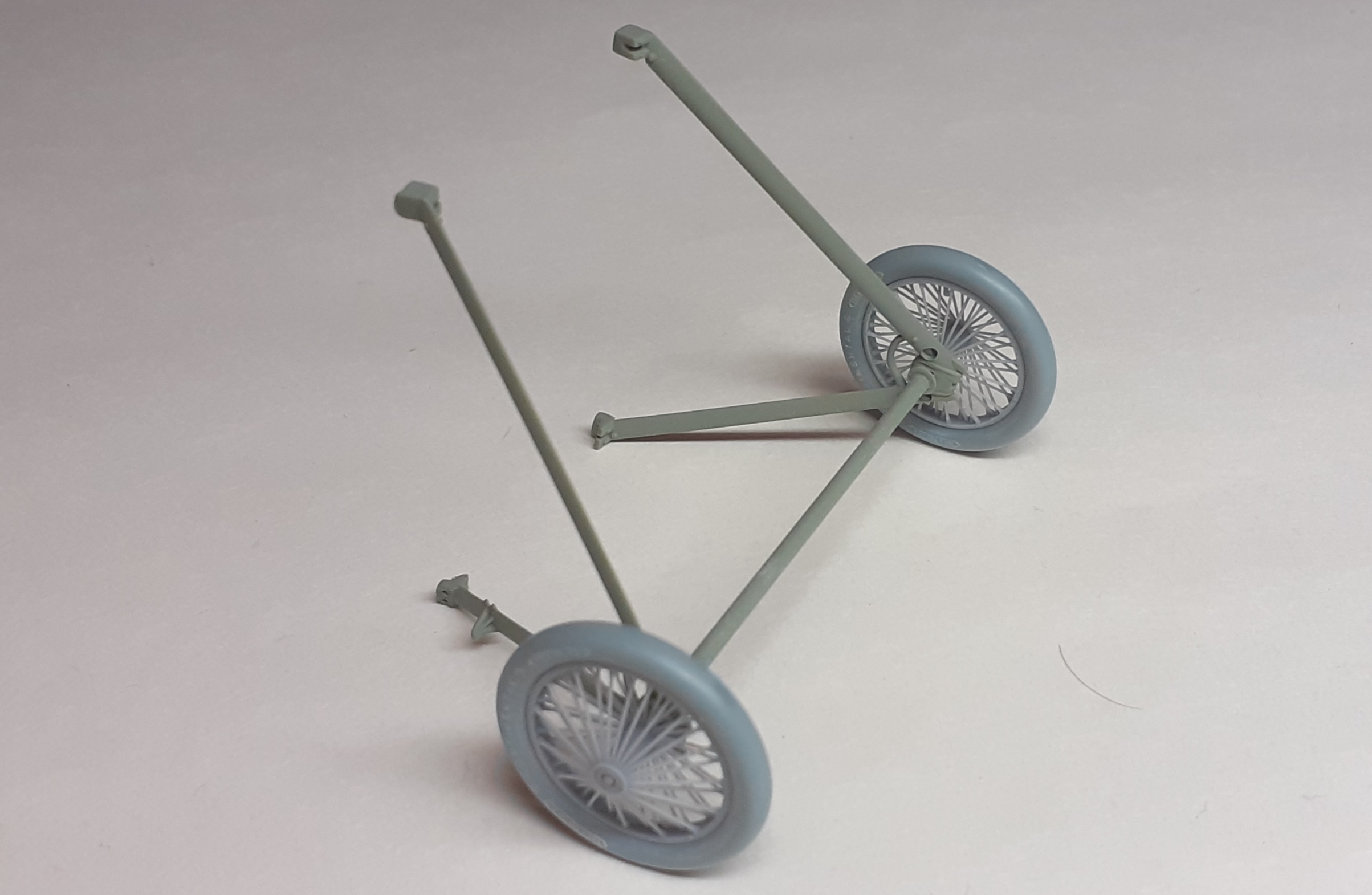

A few steps forward.
Fuselage fittings and metal panels are being painted grey-green. Propeller completed. Work on the u/c underway - here some cheating will take place, the tyres are Conti obtained from the kit parts with interior cut off slice after slice, whereas the spokes are from Gaspatch but Palmer Cord... I will have to live with this inaccuracy.

Re: Halberstadt Cl.II - 3EWlkp (1/32, Wingnut Wings)
« Reply #56 on: September 03, 2022, 06:24:29 AM »
Polishing them wings really pays of.

  • Posts: 5669
« Reply #58 on: September 04, 2022, 08:21:32 AM »
Thank you!
Bertl, I think carving the prop from veneers is not difficult, IMHO much easier than painting. And I have never achieved so nice results with paints or pencils.
I use the veneers from Kotebi cut to the prop profile shape. I glue the layers together with a carpenters glue. Then soak the laminate with liquid CA glue. After all this is dried carving itself takes me no more than half an hour per one blade. The veneer is quite soft, I use the sharp Excel knife for coarse cutting and then sanding paper 150, 300 and 600 to get the final polished shape..
I am sure, seeing your amazing modeling, that if I can make those props, the more you will have no problems with it.

Thank you very much for the very good explanation, @PrzemoL.
Your words make carving a propeller seem very simple.  ;)
Also many thanks for the link, I will follow it.
