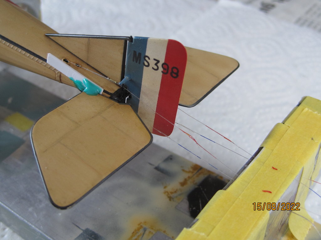

Again a bit of work on the Morane.
The model was fixed in a non-slip position and the control stick was locked in an almost neutral position with a carved auxiliary tool.
I then clamped the pendulum rudder in neutral.
The elevator control cables were then very carefully tensioned in sequence and taped to the "assembly stand" with Tamiya tape.
I marked the control cables with different colors of felt pen so that they could be tensioned in the correct sequence.
Translated with www.DeepL.com/Translator (free version)

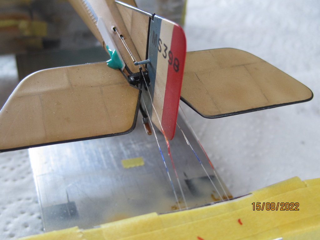

« Reply #414 on: August 16, 2022, 08:47:42 PM »
After all four control cables were well tensioned - always making sure that the control stick and the elevator remain in neutral (!!) - the control cables were glued in the holes of the control horns with a tiny drop of super glue.
As soon as the superglue had tightened, the big moment came - clipping off the control cables from the auxiliary tool:

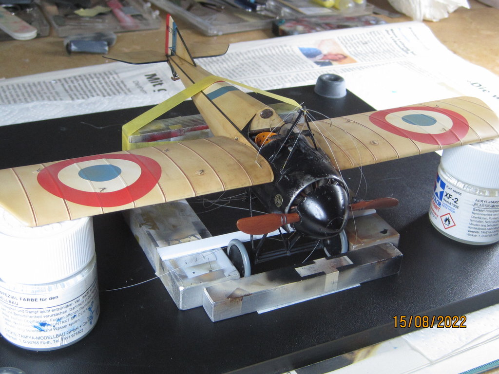

Now comes the last big step - the final assembly of the wings - for this the model was fixed on the underside of my sanding plate with the simplest means:
Servus
Bertl
Offline Umlaufmotor
  • Posts: 1268
Re: Morane-Saulnier Type "N", Special Hobby 1/32
« Reply #419 on: August 16, 2022, 09:12:14 PM »
When the fuselage was fixed on the plate, I was thinking about what to build as a jig for wing mounting - funny enough, not two minutes later I had two Tamiya paint jars in my hands - put them underneath, I thought - and that fit right away, brilliant!!! ..... You have to be lucky.
The jars were fixed to the base with double-sided tape and all was well.
The model will also remain fixed to the board for bracing - I'm curious how unstable or how firm the wings will be after bracing to the model.
In the last picture, the two wings are already glued to the fuselage.
