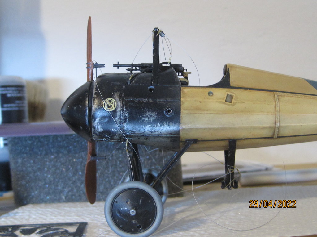

The MG was now gently sprayed with the airbrush with Tamiya brown and some Tamiya smoke, both mixed with 90% thinner.
This fine mist of paint serves as a filter to break up the metallic shine a bit and capture the "used" look.
Depending on the incidence of light, you will now see a slightly stronger metallic shine or a slightly weaker one.
Servus
Bertl
« Last Edit: July 17, 2022, 11:03:13 PM by Umlaufmotor »
Offline Umlaufmotor
  • Posts: 1217
Re: Morane-Saulnier Type "N", Special Hobby 1/32
« Reply #376 on: July 17, 2022, 11:09:14 PM »
The modified Gaspatch Hotchkiss-MG can now be mounted on the top of the cowling.
Easy to say, but it wasn't quite that simple after all.
The whole plastic stuff is very fragile. In addition, all the correct angles and alignments had to be observed.
But in the end it worked.
If you look at the mounting of the MG on the original pictures, you will notice that the MG tube was additionally fixed on the cowling.
For me the question arose, do you want to represent this on the model as shown in the original?
You can probably guess the answer .... .
Servus
Bertl
« Last Edit: July 17, 2022, 11:19:09 PM by Umlaufmotor »
Offline Umlaufmotor
  • Posts: 1217
« Reply #377 on: July 17, 2022, 11:14:26 PM »
For the representation of this holding clamp around the MG-barrel I resorted to old proven home remedy - waste plastic  8)
Servus
Bertl
Offline Umlaufmotor
  • Posts: 1217
« Reply #378 on: July 17, 2022, 11:28:17 PM »
The creation and assembly of the small retaining clamp required a lot of patience.
The two long screws for fixing were made of simple hot-drawn plastic sprue.
Servus
Bertl
Offline Umlaufmotor
  • Posts: 1217
« Reply #379 on: July 17, 2022, 11:33:30 PM »
After the MG was fixed to the model, the repeating lever could also be installed.
The repeating lever was carefully inserted and adjusted on the MG.
Finally, the repeater lever was attached without glue.
Due to the color it holds very well in the bore.
Servus
Bertl
Offline Umlaufmotor
  • Posts: 1217
« Reply #380 on: July 17, 2022, 11:40:15 PM »
Now the upper tension tower could also be inserted, aligned and glued.
With these pictures I say goodbye again for today.
See you soon,
Servus
Bertl
