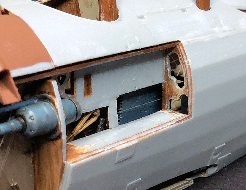

Offline Mike Norris (UK)
  • Posts: 2717
Re: 1:32nd scale Salmson 2-A2
« Reply #51 on: November 30, 2021, 03:47:16 AM »
Hi all,
The exposed fuselage side bay is finished as far as I can.
There are no drawings or photographs of the is area on a French Salmson 2-A2, apart from aircraft that are either being built or that have crashed.
Therefore there's no 'complete' French aircraft detail available.
However, there is a photograph of an American Salmson 2-A2 that does show this area complete.
Although the American aircraft were fitted with a Type 3-US generator, which was different from the French version, the detail in their bays look very similar.
Therefore I detailed the bay with electrical conduit and wires, tubes and what I assume were aircraft batteries (the observers wireless had its own battery).
The detail is a combination of scratch parts, 'ANYZ’ 0.5 mm silver braided line (AN011) and ‘MFH’ black 0.4 mm flexible tube (P-961).
Decals used were spares from previous model builds.
Out of necessity, the added detail may not be accurate, but at least is does represent that bay area.
« Last Edit: November 30, 2021, 04:52:26 PM by Mike 'Sandbagger' Norris »
