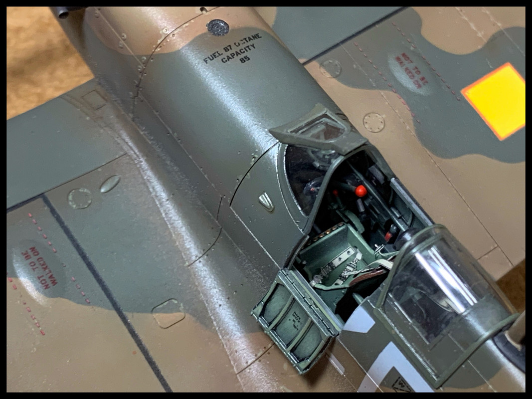

Yep, I stumbled across this with my Spitfire stencil decals, and they did work really well - look absolutely painted on  :D
How are you meant to know which is which though? Is there a way of telling? There was no instruction on it with the decal set I got - Faf told me - so I tried it and it worked!

I'm not sure, but I think it's a fairly recent change. The first time I came across any info on this was in relation to the release of Eduard's new Spitfire Mk.I, so last summer then...
I simply scraped off my carrier film (on the stencils only) with a toothpick, but then I had already treated them with Microscale Sol. I think Guy just lifted them once he got a corner free.

As Fredrik said..
I just applied as per a normal decal - no solutions, I didn’t try to get the decal to settle onto the surface, just gently rubbed it on.. left it a few minutes then lifted a corner and it peeled off leaving the lettering.
