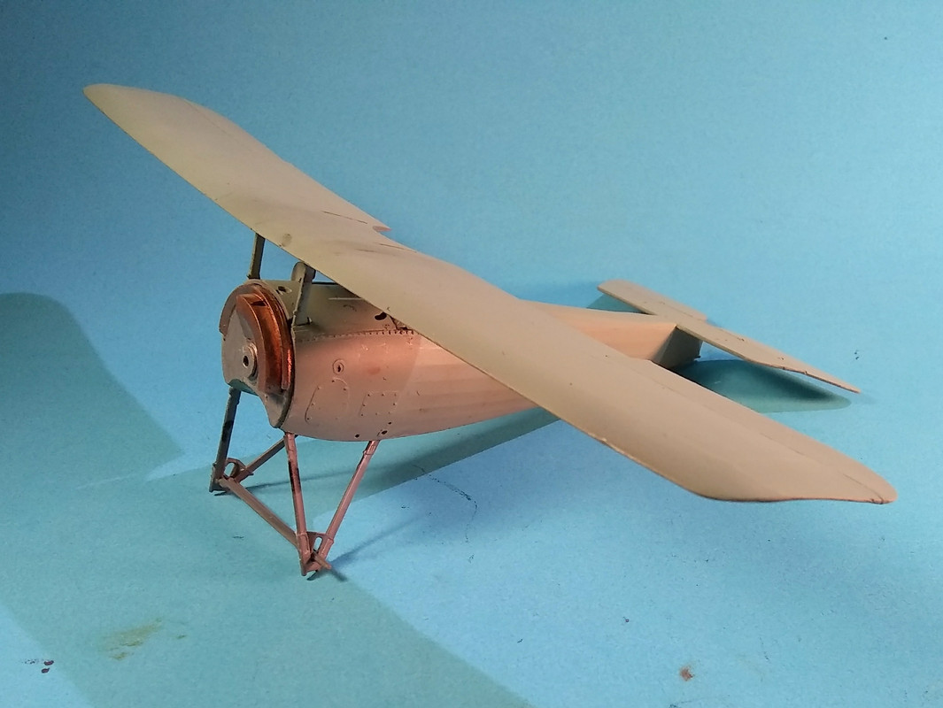

So today I took a couple of steps forward. I attached the landing gear and then attached the upper wing. I am going a bit outside of the box here. My plan is to figure out if, and or how much I need to remove from the lower wing. I will use PVA to attach the interplanes to the upper wing, line up the lower wing and mark where the interplane struts meet the lower wing. Any variance as to where they line up will be removed from the fuselage end of the wing. Once that is done I will remove the interplane struts and paint the main scheme. That's the plan anyway  8)

Good luck, Rick!
I watching with close interest now as this is the part of the build I fell flat on.

Looks good as a parasol kite  ;)

Yeah Alexis! If I fail on the lower wings I can always add some airfoil strut material and call it an experimental Monoplne version  ;D

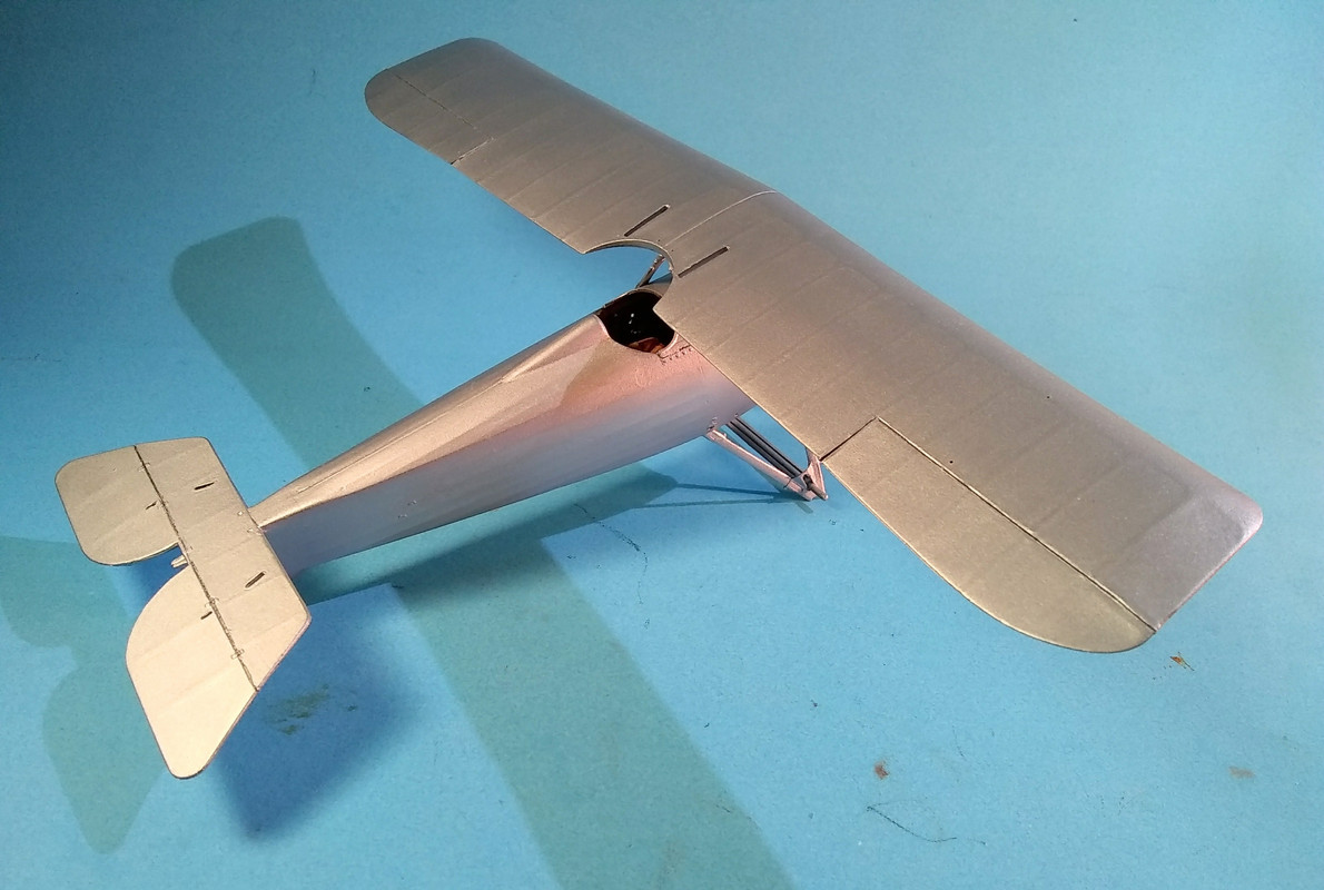

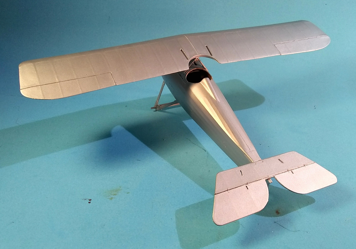

So the plan was to use white glue, hold the interplane struts in place, and figure out how much I needed to remove from the lower wings to line everything up. That pretty much failed although silly putty allowed me to line things up enough to think I need to remove about 2mm. So now I know I have to attach the interplane struts permanently to the upper wing in order to get all things final. So....I painted the aluminum finish on the airframe and next I will apply the under wing roundels. Then the struts will be attached and I will find out for sure what I need to do  8)

Nice job on spraying the alum dope Rick , nice and smooth . Looking forward on seeing how the lower wings turn out ! :)

that aluminum looks great - what paint do you use for that?

First Thanks for the comment. The road to the Aluminum finish was rocky! I first sprayed some Tamiya black then used Tamiya Chrome silver. I don't know what happened but the pigment was terrible. Rough as a gravel driveway! I used a polishing cloth to smooth it out as much as possible. I looked around for another silver in My paint stash and found a Very Old bottle of Floquil Bright Silver. I sprayed that over all of the Tamiya and it worked great! Saved this one from Doom  8)
PS: I did let the Tamiya cure for 24 hrs. before polishing and spraying the Floquil!

Ah yes, always heard amazing things about the old Floquil silver paints (old silver and bright) though also that they smelled really bad :)

It was excellent paint. The fact that this bottle is probably 40 years Old is a Testament to it's durability in the jar  8) As for the smell it is strong, especially now that Xylene is My only choice of thinner. Even worse than the original Dio Sol!!
