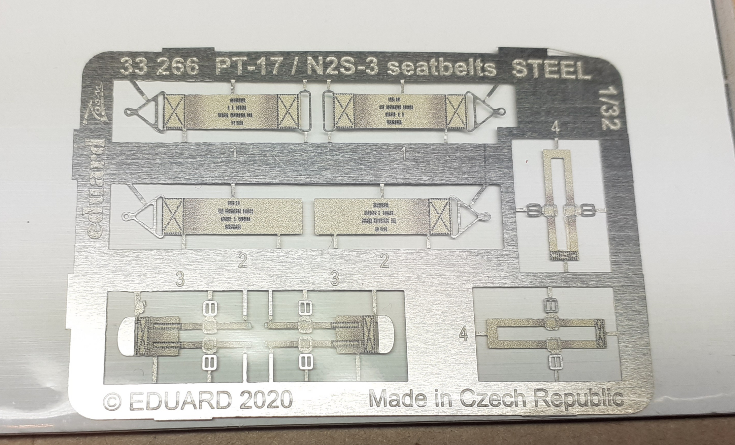

I have also acquired two Eduard PE sets with some interior bits and seatbelts. They are dedicated to the ICM kit but I am quite certain they will work here, too.
